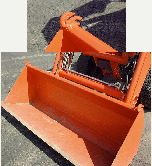

Hazmat, Here is a photo of the hooks on my bucket.......Sorry to be keeping you at night!/w3tcompact/icons/laugh.gif If I brake one of these hooks I think the loader will be twisted like a pretzel first!

Von,
Man I'm really going to have to count the sheep tonight/w3tcompact/icons/laugh.gif.
Actually your installation doesn't worry me. The hook is very beefy with the aforementioned "I beam" style construction. Also the corner location is the strongest place to put the hook. And based on your previous life as a porshe rebuilder, I'd bet you know which end of the welder to point at it. Buy I still want it X-rayed an dye penetrant tested/w3tcompact/icons/laugh.gif

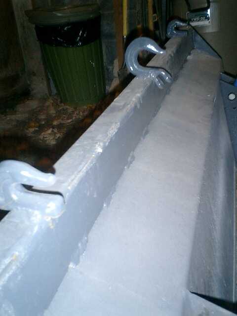

hazmat, here's some more sleep inducing hooks. Here are pictures of the hooks I had installed. I got both styles from AWDirect. Overkill for my TC25D? Probably. But at $4.50 each for the <A target="_blank" HREF=http://www.awdirect.com/awdirect/catalog.cfm?dest=itempg&itemid=7299&secid=71&linkon=subsection&linkid=112>3/8" grab hooks</A> (which are placed on the upper lip of the bucket directly above where the FEL arms connect) and $9.50 for the <A target="_blank" HREF=http://www.awdirect.com/awdirect/catalog.cfm?dest=itempg&itemid=8885&secid=71&linkon=subsection&linkid=112>3/8" slip hook</A>, (attached in the center of the bucket) then I had the upper lip of the std duty bucket boxed, I figure it's cheap peace of mind. Attached is a picture.
