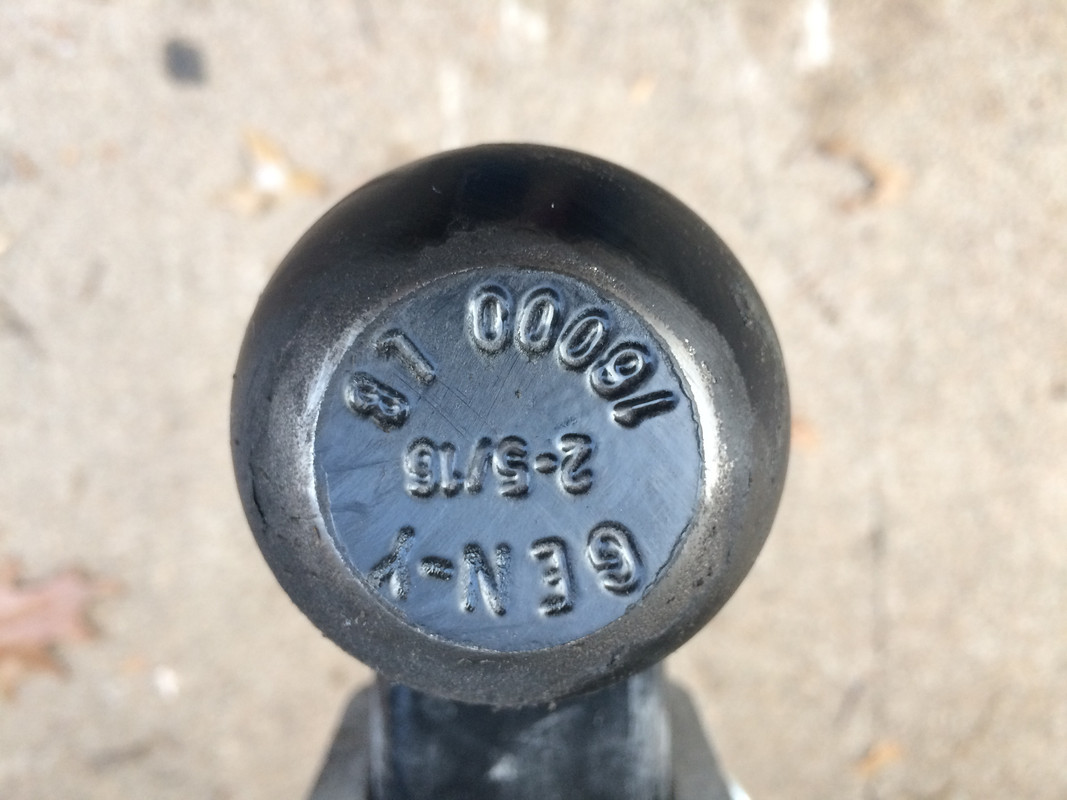

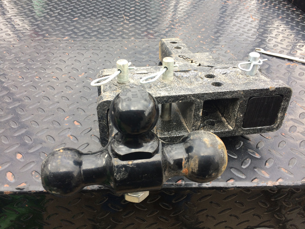

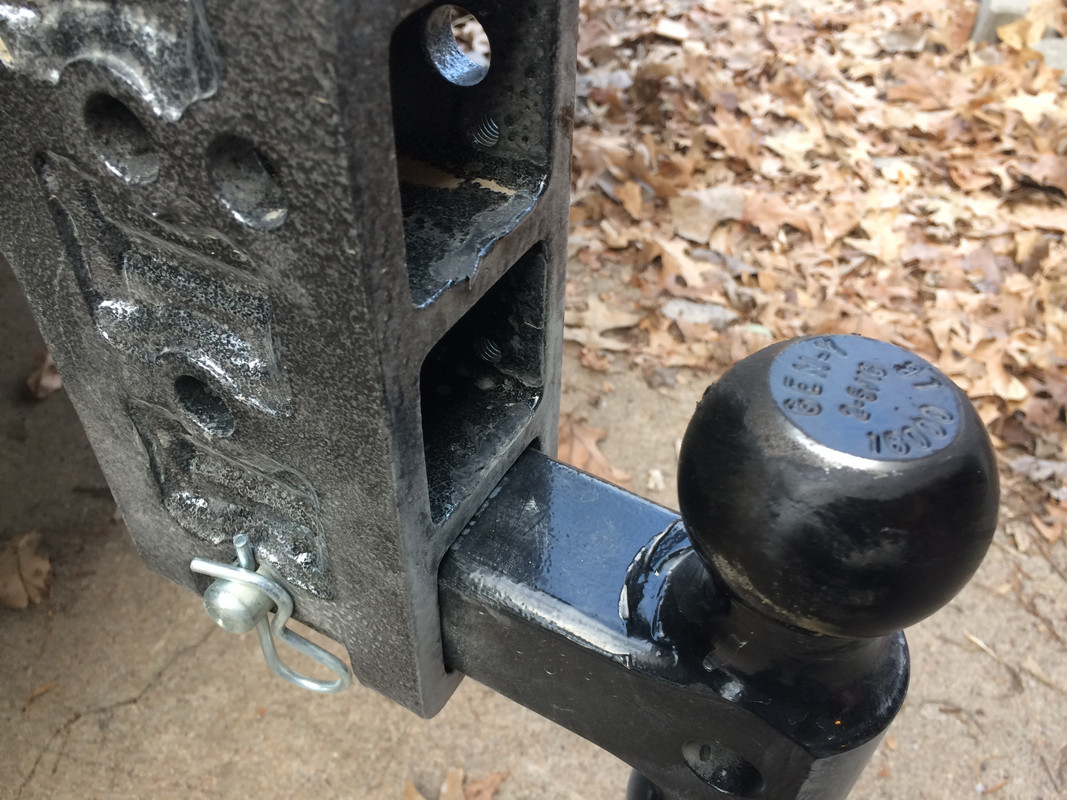

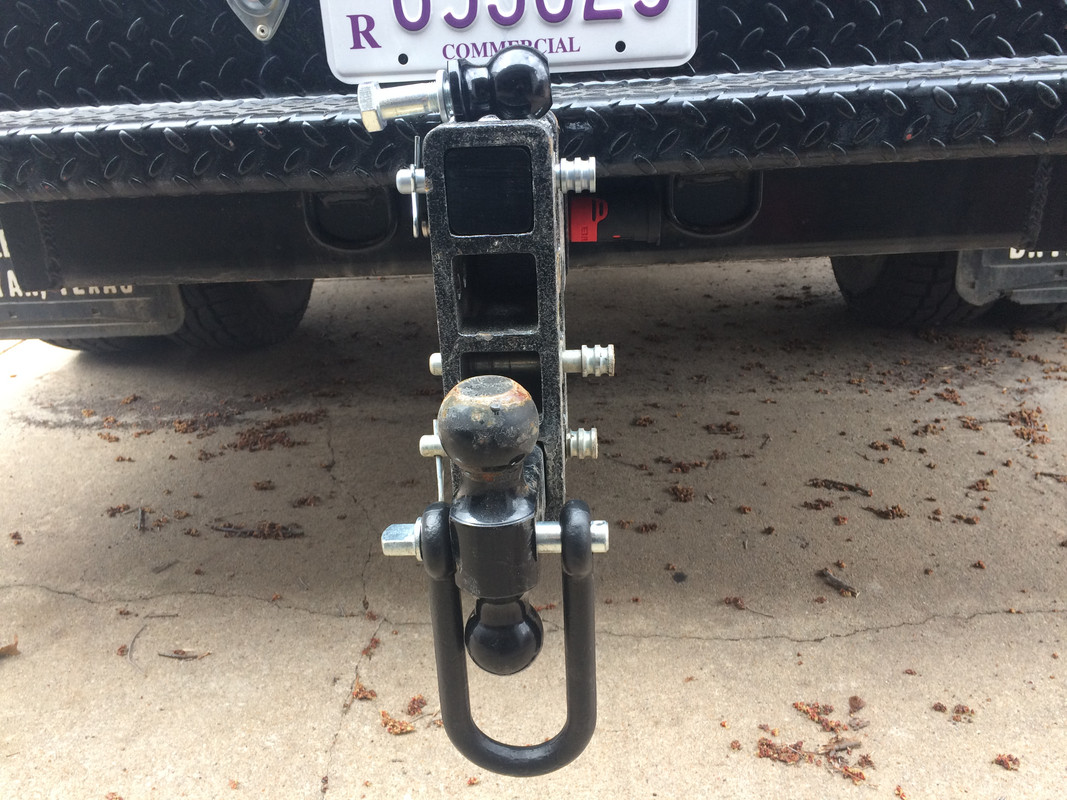

I致e had good luck with my GenY. I use it to tow commercially. It痴 not as pretty, now, but you get the idea. The 2 5/16 ball is rated for 16k. The 2 is rated for 12k. These are big numbers, compared to a lot of the competition. The adjustability is great. I have the tow loop and the 1 7/8 ball, which both go in the hole.

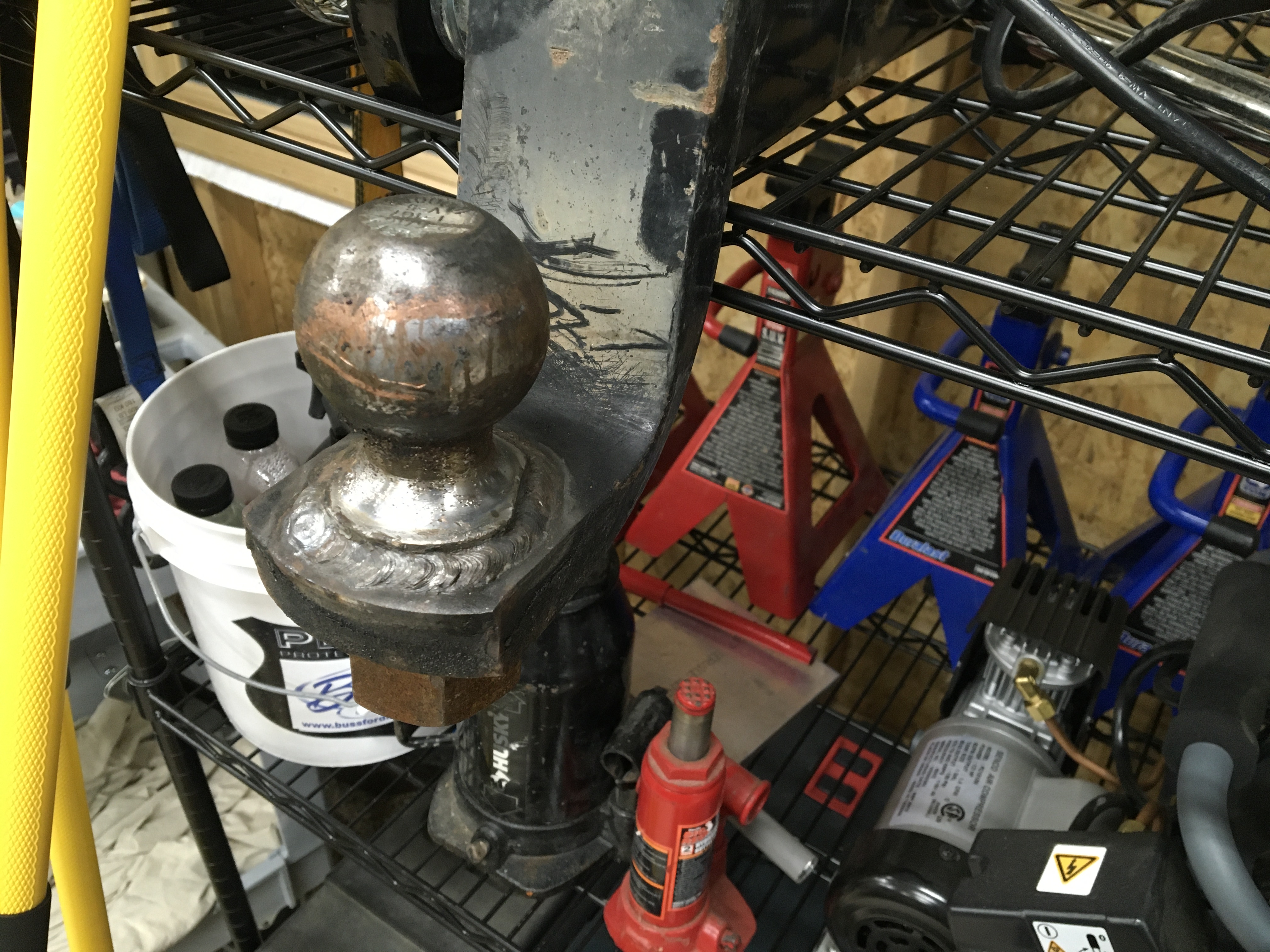

The only issue is if when borrowing a trailer or renting equipment. The chains are never long enough so I have to use a standard setup. This past weekend I rented a boom lift for some tree trimming and noticed the ball was loose. I could not break the rust free so a resorted to using some 7018. My vote is for welded balls
