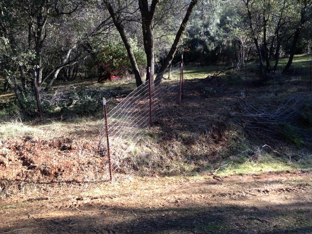

Is there a good on line site with photos or instructions for installing weld wire fence? I am making it up as I go along but would be good to see samples of how others have done this. Searching in Google there are just too many types of wire fences to sort out to find examples like mine.
I am currently building a 4 foot tall welded wire fence, the type with 4"X"2" squares. I am using metal T-posts.
For example in the attached photo, when I reached the gate post I just wrapped the fence around the post and tied it back on fence. How would you have done that?
Also attached a photo of a corner, were we had to cut a section to deal with the change of slope and brace the corner. How would you have done that?

That fence is not going to work . He or she is ready to start digging out . I finally dug afooting and stuck the bottom of the fence in it with concrete .
   / Welded Wire Fence, 4"x2" Squares with Metal T-Posts #4
T post arent good for corner posts. You need a 6x6 wood post in concrete for corners properly H braced. Websites will show you how to H brace it. As for crossing that drainage ditch, you are own your own on keeping that little doggy in and allowing water to pass. SOMe folks have built a swinging gate that allows the water to carry it up and then it falls back after the run off subsides, but for that small dog, you're going to need something else.
To keep a dog from digging out, you can try tying a piece to the bottom of your fence that is about 12-18" wide and leave it under the dirt to hold it down. Dogs tend to dig at the fence baseline and when they find the wire, most time they will stop digging at that spot and look for another and eventually give up MOST TIMES. Some will find a way so might need some disciplinary action when /IF you catch the dog digging.

Welded wire fence is pretty fragile. I don't think that it would stretch very well. Fence that is not stretched tight is pretty floppy and soft at the bottom. Red Brand does make a 2"x 4" woven wire. We keep our dogs in the back yard with chain link. When the dogs are out in our 10 acre fenced in pasture our 2"x 4" Red Brand No-Climb horse fence has always held them. It's tightly stretched and 2" above the ground so I can weed eat under it. Our dogs do dig. They like to dig up moles in our pasture. Doggy holes are bad for horses. They sometimes try to dig under our fence also. When we see them digging a new hole in our pasture or under our fence we put a scoop or two of dog poop on it. That stops the digging there but they continually find new places to dig.
