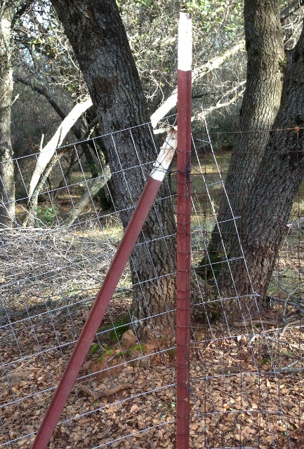

Is there a good on line site with photos or instructions for installing weld wire fence? I am making it up as I go along but would be good to see samples of how others have done this. Searching in Google there are just too many types of wire fences to sort out to find examples like mine.
I am currently building a 4 foot tall welded wire fence, the type with 4"X"2" squares. I am using metal T-posts.
For example in the attached photo, when I reached the gate post I just wrapped the fence around the post and tied it back on fence. How would you have done that?
Also attached a photo of a corner, were we had to cut a section to deal with the change of slope and brace the corner. How would you have done that?
The dog in the photo is the reason for the fence. He likes to chase deer. One time the deer almost killed him.

That fence is not going to work . He or she is ready to start digging out . I finally dug afooting and stuck the bottom of the fence in it with concrete .
   / Welded Wire Fence, 4"x2" Squares with Metal T-Posts #4
T post arent good for corner posts. You need a 6x6 wood post in concrete for corners properly H braced. Websites will show you how to H brace it. As for crossing that drainage ditch, you are own your own on keeping that little doggy in and allowing water to pass. SOMe folks have built a swinging gate that allows the water to carry it up and then it falls back after the run off subsides, but for that small dog, you're going to need something else.
To keep a dog from digging out, you can try tying a piece to the bottom of your fence that is about 12-18" wide and leave it under the dirt to hold it down. Dogs tend to dig at the fence baseline and when they find the wire, most time they will stop digging at that spot and look for another and eventually give up MOST TIMES. Some will find a way so might need some disciplinary action when /IF you catch the dog digging.

If you want the 2 x4 inch fence look, I would evaluate the woven horse fence rather than the welded wire fencing. Much more robust and will loo better as well.

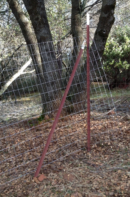

Does anyone know of low cost connectors for bracing a corner or attaching one T-post to another? The local feed store has Wedge-Loc connectors. The Wedge-loc parts are about $2 for each part and six parts are needed for bracing each side of a corner.
I installed a second post and an angle and attached it with wire, as in the attached photos.

I've been the Wedloc route.
For your dog, an ok solution.
For a long, strong solution, they suck. Too much money. Put in a well braced wood post. I am slowly removing my Wedgeloc supports. This summer I expect to complete my replacements.
Though it could be an issue with debris, there are livestock panels with ~3"x3" squares (same as cattle or hog panels). They would work well for installing along the bottom of the fence in the ditch. I attached some I installed with hog rings to the fence.
Setting posts sucks, but you could rent a digger and get a buddy out for a Saturday morning (beer & bbq will help). Then plant a few wood posts for corners and bracing. Welded wire will be a disappointment (I do appreciate it is cheaper). On the other hand, if all you are protecting is that little dog, it will do.
