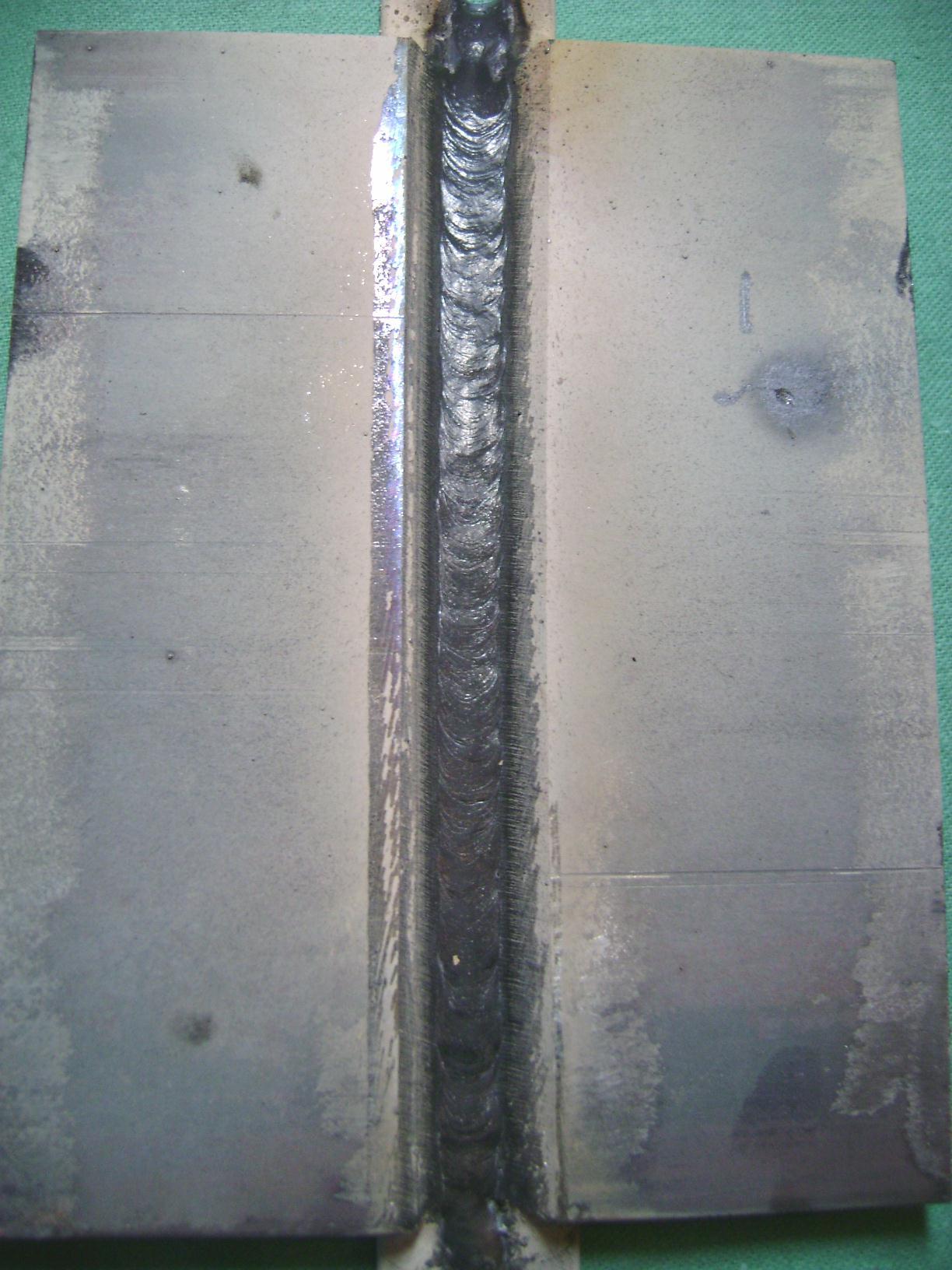

Thanks for all the advice so far.:D The thickest I would weld is 1/4" steel probably. I just figured I would get a mig because I've heard it's the easiest to use and learn(flux core). I already have angle grinder but would need to get the rest. I was thinking I would spend $300-$500 on all of it.The videos may be my first action to decide on exact welder.

If you want to weld 1/4" mild steel with fluxcore-SS you'll need a machine that is capable of running .045 wire, in the neighborhood of 200-amps, and 18 to 20 volts. I suggest Lincoln's NR-212.
You mean in a single pass right?
While a 220V machine can handle 1/4 inch easily, proper technique with even a cheap o MIG can technically handle the occasional 1/4" weld. I make the point because too many new weldors focus on max capacity even though they rarely use it. Kinda like HP with tractors. It just takes longer with smaller equipment.
Yes I do.
Unless you're doing full penetration welds on 1/4 inch material, I don't see the need for multiple passes. Even then I'm sure I could carry enough iron to do it in a single pass.
Here is a full pen overhead weld with .045 NR 212 on 1/2 inch material, double 37 1/2 degree bevels.
