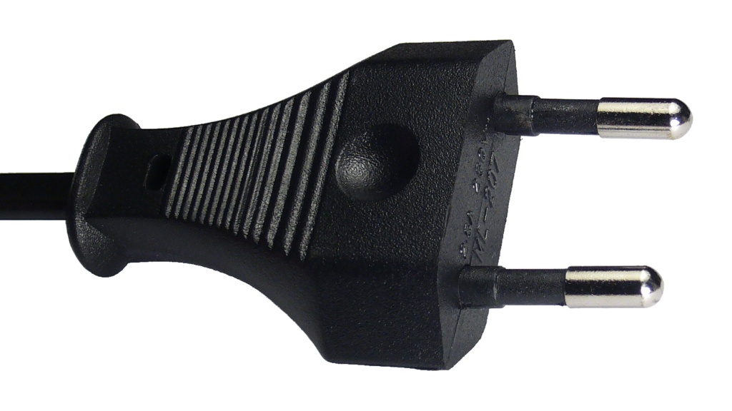

I would say the real reason for fewer electrocutions is the 2 small round electrode holes recessed into the wall . They are about 1/4 the size of our blade configuration so it's that much easier to stick the knife, wire or whatever in it.
That and the newer "europlug" is designed so that the metal part of the pins is inside the socket before it gets energized (as seen below):
Source: Europlug - Wikipedia, the free encyclopedia
Aaron Z
