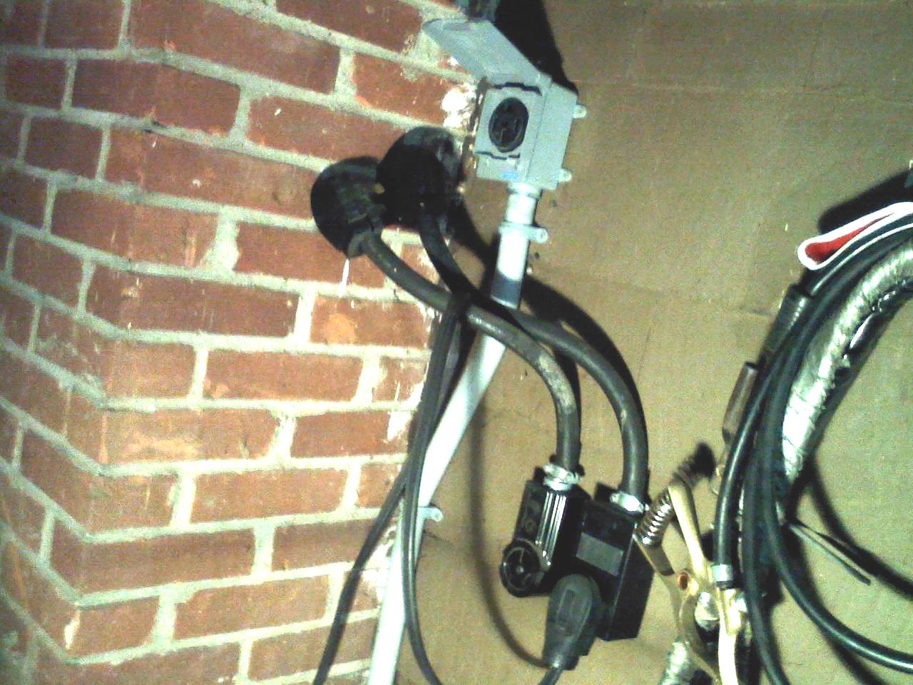

Here's a picture that demonstrates the difference in size between the supply cord on my welder which is only 12/3 and the extension cord I made out of 6/4. I used the same 6/4 wire to make up these plug configuration adaptors, the 12/3 is what looks like a little string next to them.
JB
   / Welder Extension Cord #69
I think I'd rather drop a piece of steel on the thinner wire. Should make less noise..
   / Welder Extension Cord #70
The welder is the plug on the left. Interesting that the required 50 amp outlet serves the 12/3 cord, while those 30 amp range and dryer outlets often get 6/3 cords plugged into them.
