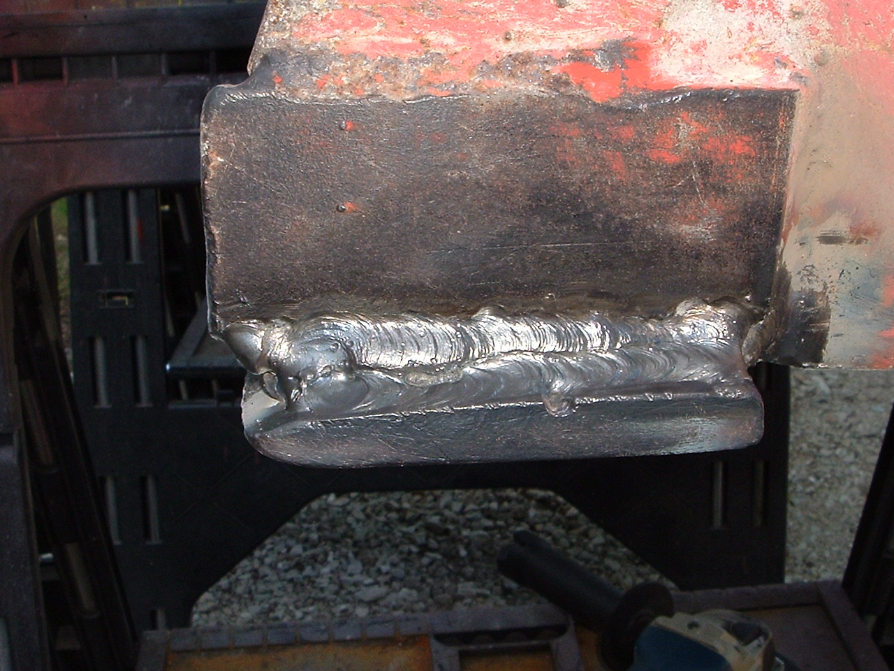

This is my welder. Everlast PA160. It cost me $265 bought thru Mark here on this forum. It is a stick welder. It was the second machine I have owned. My first was a Lincoln 225 AC only so called "buzzbox". They are called buzzboxes because they buzz when you weld with them. They do OK, but the quality of my welds improved 100 percent when I went to a DC machine like my little Everlast. It weighs about 20 pounds or so. The Lincoln buzzbox weighs well over a hundred. My trusty buzzbox got sold as soon as I made a few welds with the little inverter DC machine.
Below is an example of the kind of welds it can make with some 7018 rod. Yes stick welding takes longer to learn. I taught my self totally. No one around to help me or show me anything. My first welds were NOT very good. But I did put the AC machine to work pretty quick gluing my old mower back together many times. The mower was totally outmatched to the job I was asking of it. Rough ground and lots of it.

Don't worry about 7018 rods as you need to store those rods in a rod oven. You can not leave 7018 rods out in the air. If you are running an AC stick welder you need to buy AC rods. There are AC and DC rods. You need to match your welder.

Those 7018 rods I welded that hook on my Kioti have never seen the inside of a rod oven. Yes, they are stored in a gasketed plastic rod holder in the basement. Not a rod oven by any means. And they seem to weld pretty good to me. I am not going to leave them out in the rain, but for the kind of welding we do around the place, the plastic rod holder seems to be just fine.
