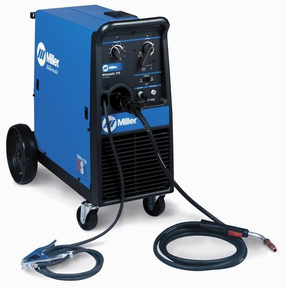

I started welding when I was a Kid 13 or 14 and all that was around were the 225 lincoln buzz boxes. They got me by until I started raising hogs and wanted the portability of the small migs, so I purchased a 130 millermatic 110 volt mig. I purchased the gas kit and it sufficed for about 3 or 4 years.
I mainly used it for welding up stainless feeders the hogs would bust up and gates etc.
I also operate a farm and sometimes the 130 was just a bit short for some of those projects so I sold it to a neighbor with hogs and purchased a millermatic 200! What a difference that is and I think I paid about 1400 something purchased on ebay from a distributor of Miller. (Indiana Oxygen Co.)
To make a long story short I wish I would have doubled my investment initially and bought a big enough welder from the start.
Just checked and it was a MILLERMATIC 210 I purchased !
He has several listed for 1259 .00 on EBAY. I added some extras like auto darkening helmet and consumables like wire,spatter spray,tips,etc to get to 1400.

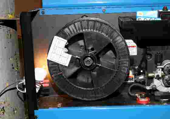

The MIG wire is copper coated for rust resistance and better conduction. Even so, in humid areas like where I live it can develop very slight rust on the wire if left in the machine and humidity condenses on it. If you have humidity, take your spool off and store it in a tight plastic bag. Better yet, add a wire compartment heater. Mine is a 25 watt light bulb. It mounts into an outdoor grade floodlight socket I mounted thru the back of the machine. It plugs into 110 v outlet and slightly heats the cabinet interior, preventing condensation on the wire. Ten degrees temp increase prevents condensation. Electric cost is about $1.25 per month. See photo.
