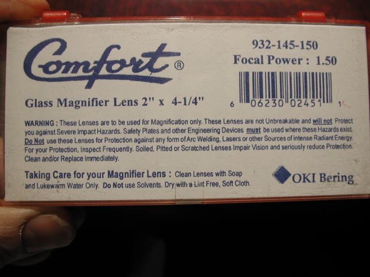

Here's a photo of the lens and case it came in...

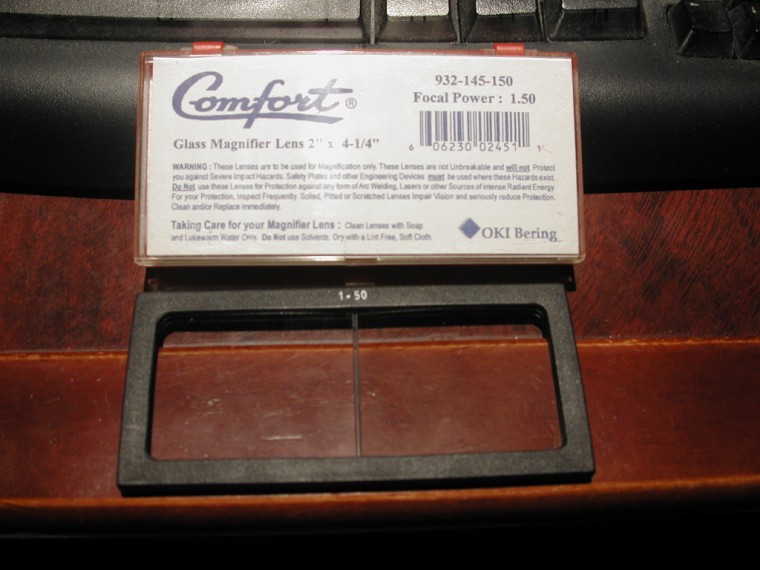

And an attempt at a close up of the text...
These come in various focal powers, like reading glasses, but must be designed to be placed some distance from the eyes, rather than close like reading glasses would be.
Don't know the cost as mine was given to me. I am pretty sure they are fairly inexpensive though...

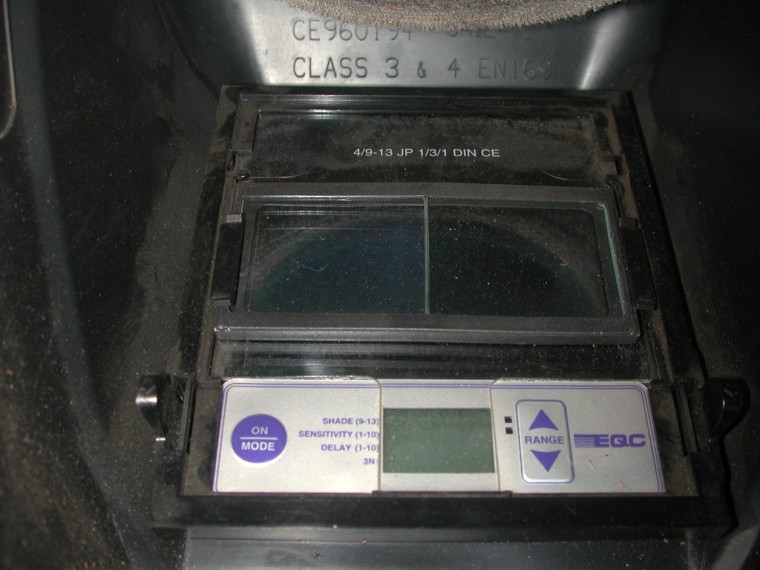

The cheater lens snaps into my helmet like this...
