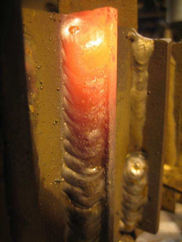

They both work if they are well melted in and sufficient material. A new Hobart 190 is a bargain and doesn't cost much more in today's dollars than it did 25 yrs ago. The main reason they come with the new features was to be able to raise prices. The market is super competitive, both for quality and cost.
