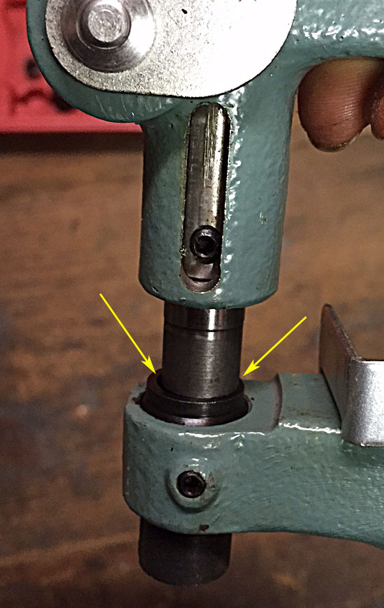

I bought this cheap copy of a Roper Whitney XX deep throat sheetmetal punch. Roper Whitney item costs $250, this was $60. It doesn't work because the punch can't go into the hole on the die. I replied to the eBay seller with pics of the defect and they just returned my money, that was Apr 27, 2013. Here it is 2 years later and I was about to throw it out but thought maybe I can repair it (that is my problem throwing stuff out).

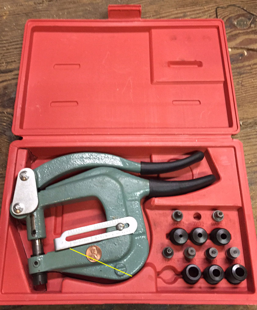

I was thinking of making a LONG cut (at a shallow angle on the yellow line) re-aligning it, and brazing it back together. Not sure how best to cut it either.
Can I heat it up and arc weld it? Will it retain the re-set alignment? Its about 1 1/4" thick, and you can guess the other dimensions from the penny (is 3/4").
I'd be willing to spend an hour on it before tossing it.

rebore it and add a bushing
Welding chicom CI is a fools mission. Who knows what is under that paint.
   / Welding a cast iron tool (Roper-Whitney XX punch) #3
Ream punch hole just a hair, put set screws at a 45 deg on both sides on the back side. Use the set screws to center punch. If you go to big with the ream then put a 3rd set screw in the front. The trick here is not to go to big with the 1st ream job.

If I can cut & weld in an hour; I think that's worth the time spent on this free sheetmetal punch. I have the tools for that repair (I think). I'm interested in the challenge. If it will punch a hole, and also withstand as hard as I can squeeze on the levers then thats good enough.
I was thinking of brazing or silversolder (?). But if it can be arcwelded that would be the quickest.
Thats a good idea to center the die with setscrews......but if it can be welded it will work as designed with all the quick-change punch & die sets.

Before cutting and welding, I'd try a little heat shrinking first.

I'd try to salvage it.
You've nothing to lose, save the time, and if the time is spent learning, then it's time well spent.
My concern with welding is that you'll first need to V out the 2 pieces, resulting in sections that vary in thickness along their lengths.
Also, the weld will be running at an angle to the direction of the machined bores.
You'll need to get two machined axes aligned and collinear, or you'll be right back where you started.
That means controlling the distortion in 3 dimensions - the welding equivalent of drawing on an inside straight.
I think your idea of brazing may have a much better chance of achieving the alignment that you need.
You can get the alignment right by positioning the tool in the die while brazing and post braze distortion should be very small.
Over-boring & bushing or using different set screw orientations, as described by CalG & Leejohn, would be my second & first choices.
If you can get the tool into the die with the present set screw removed, then using different set screw orientations should work.
If you can't get enough correction that way, then over-bore & bush, if you have a milling machine that's up to the job.

The lower leg is about 3 inches and it has to "shrink" .034 inch to come into alignment. There is some slop allowed ( perhaps required).
Shield do you think it can be shrunk .034"? If it can be done with 1/8" rods I'd consider it but thats my max as you probably know. It would be quick, but Seems to me it would "misalign by design".
   / Welding a cast iron tool (Roper-Whitney XX punch) #10
Oh sure, I moved beams, and pipe a foot or more. The problem with heat shrinking, and weld sequence to control / correct distortion is the amount of heat! Not the location, any first year welder knows where to put the heat, the trick is how much!
