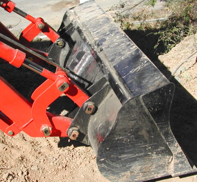

J.meyers said:
I am the proud new owner of a ck 25 w/ fel and want to weld a chain clevis to the center of my bucket on the top back side for lifting but the plate seems a little thin. will The plate hold a 3/8" clevis?
I, too, prefer the back of the bucket. You can lift more, and there is no
risk of bending the top lip.
Here is a photo of a chain slot I recently installed on the back of a new
CK20. The bkt is about the same as the CK25/30. You DO need a
reinforcement plate, however. I used a 1/4" plate, about 6x6.
   / Welding a chain clevis to my bucket #12
Here's how I did mine.
#13
ok i have decided to weld a round anchor tie down to each side of my bucket.
Give me a week and i will post how its working for me
