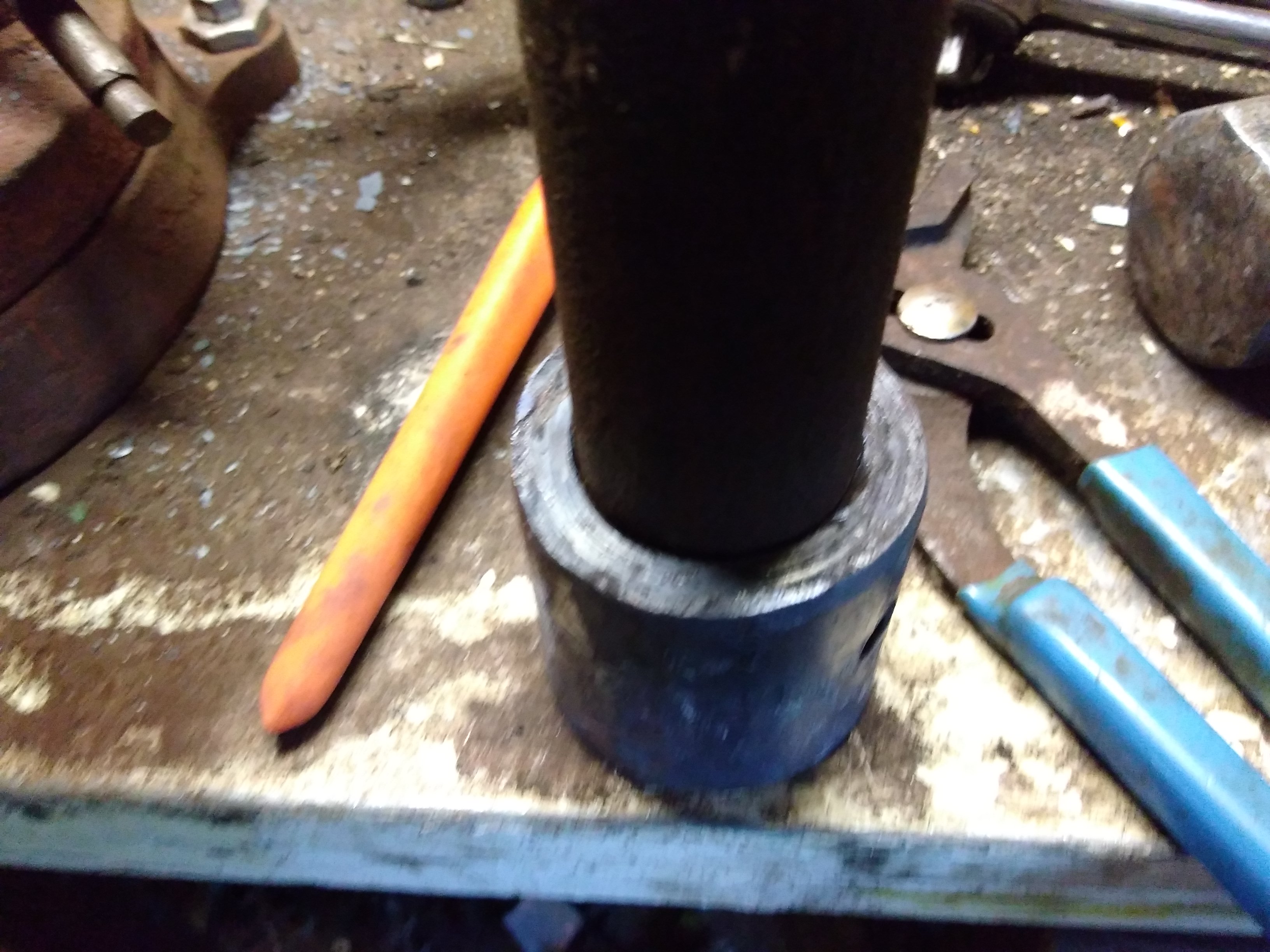

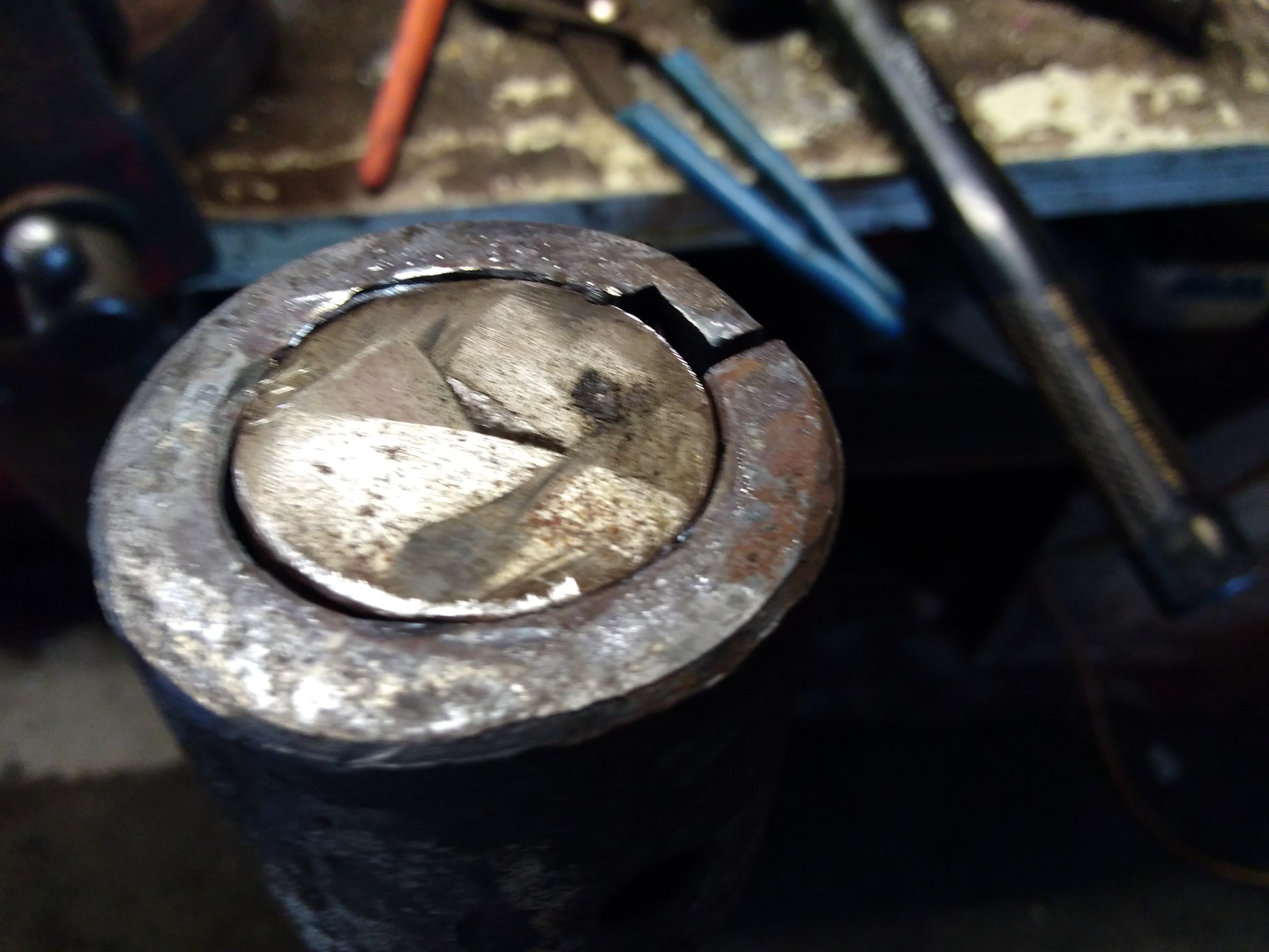

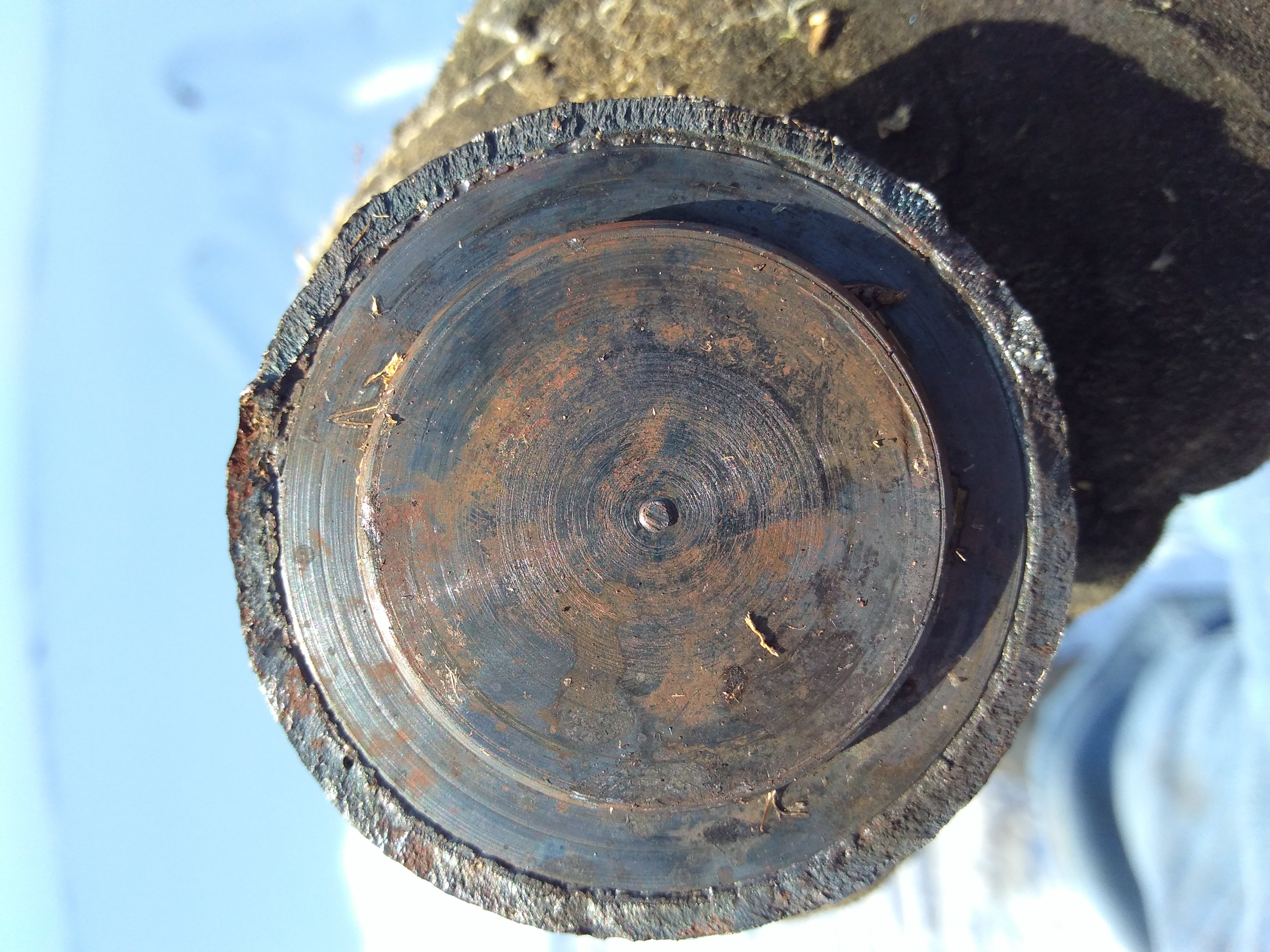

The bolt was in there, but it sheared when things came apart, I am pretty sure that the failure mode was the set screw loosening up and it starting to wobble from there until it split on the keyway.
It looks like one side of the coupling had been separated for a while, you just ripped it free.
It rusted since it broke, but that day it was all fresh, no rust. I played with the torch today seeing if I could get the coupling back in place and it came right off of the PTO stub/
Looking at it, there wasn't much weld holding it together (1/8"?) and the weld stopped/started right at the keyway. In beating it back into round, I managed to bend up the keyway, so I am going to just order a new one.
