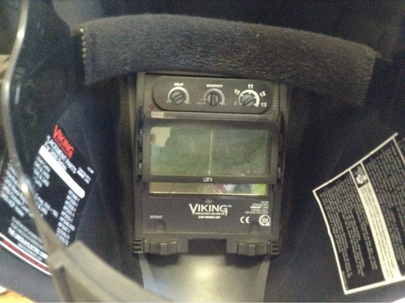

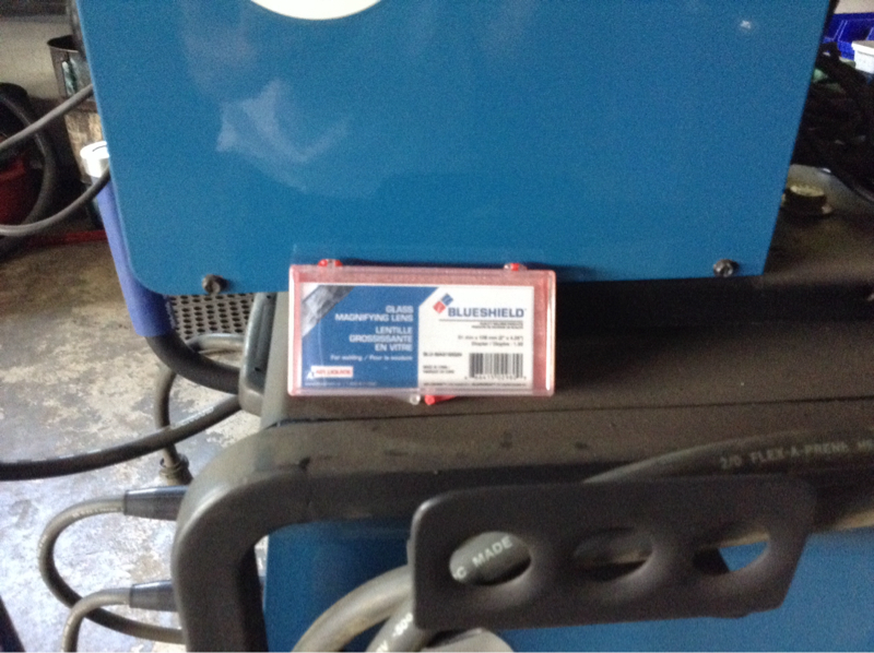

This thread has now 6 pages of discussion where the pros compensate by using "cheaters". Probably not referring to a pipe slid over the handle of a crescent wrench. Can anyone post a pic (or a link) to a "cheater" for a welding helmet?
   / Welding and age #54
funny! That never occurred to me. This thread has now 6 pages of discussion where the pros compensate by using "cheaters". Probably not referring to a pipe slid over the handle of a crescent wrench. Can anyone post a pic (or a link) to a "cheater" for a welding helmet?
If possible take your helmet with you when you shop for the cheaters. It's possible some helmets aren't the same for the way they accommodate them. Mine stay in place, but not properly. (Maybe it's just me). image-1213996392.jpg image-883031661.jpg Terry
