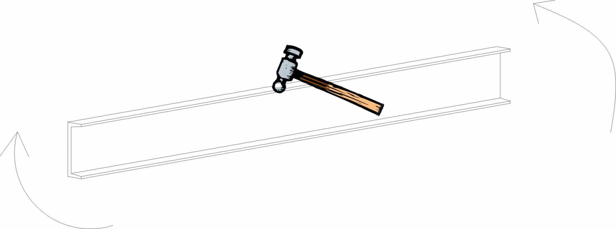

I think that adapter weighs right at a 1,000 pounds. Those are 12" x 15 pound beams.
It is amazing what can be done with a ball peen hammer. Other than all the little dents, a ball peen hammer can move material pretty fast. Take a piece of C-channel and beat on the flanges and it will bend.
