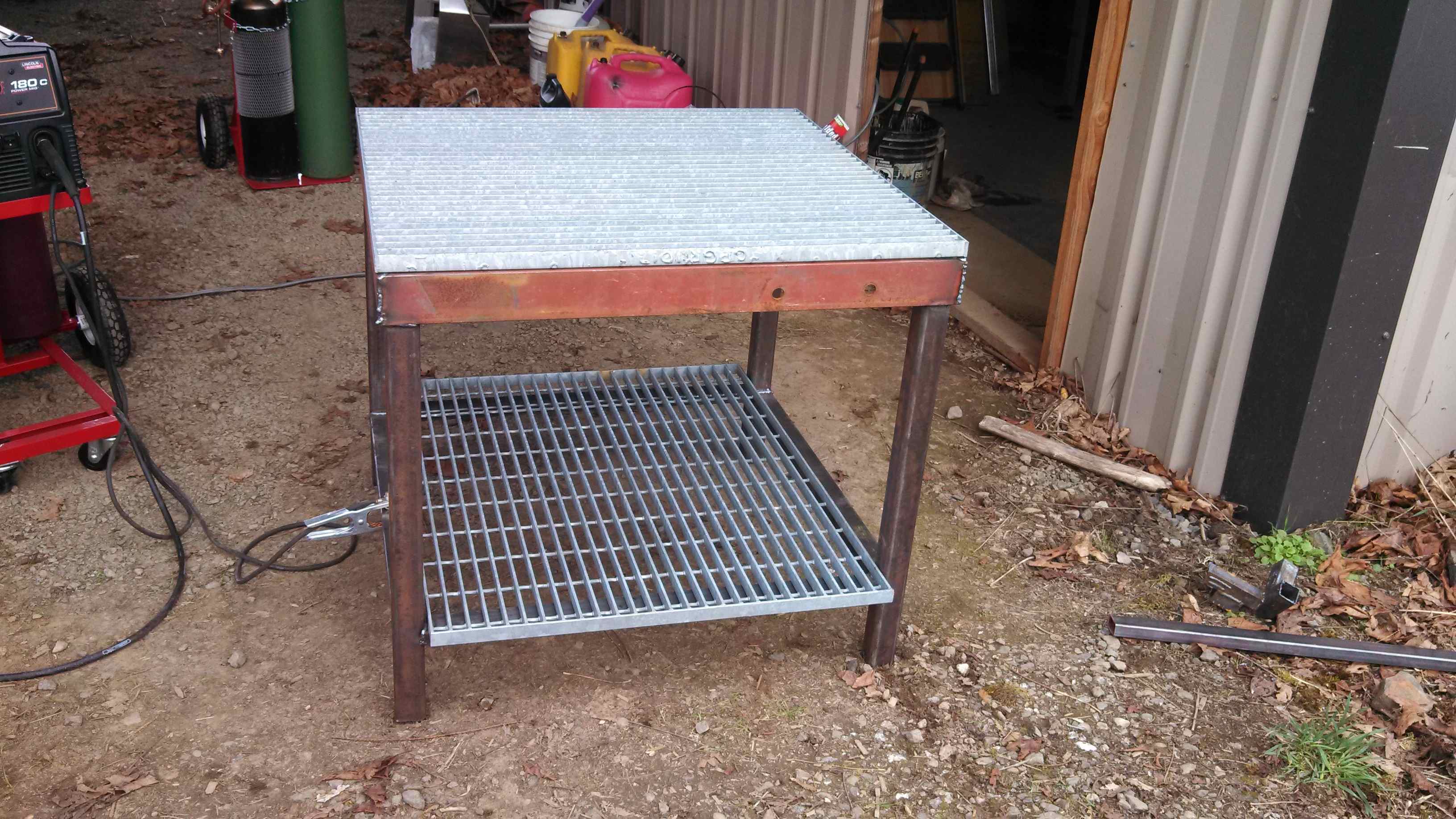

Just got mine assembled. All found metal. No casters at this point as the property doesn't really have any concrete anywhere.
   / Welding benches #80
Not going to be fun welding on or around that galvanized. If you feel sick, you'll know why. Good idea otherwise.
