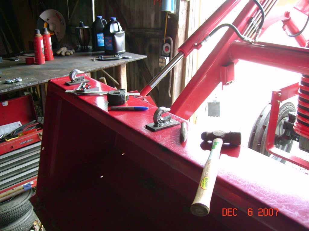

Today I added a set of 3 bucket hooks to my Mahindra 3525/ML230 FEL...
Started off with 3 3/8" grade 43 grab hooks with the eye. Cut off the eyes, and ground the backs down so they would have a good base to weld to the baseplates.
And then welded them to 1/4 inch pieces of steel plate, 2"x4"...
Getting everything measured out and set up...
After marking the corners of the baseplates with a centerpunch, I used a grinder with a cup brush to remove the paint down to the bare metal where the weld beads would be...
Another view...
Then tacked all 3 hooks in place before final welding...
The first hook is on!

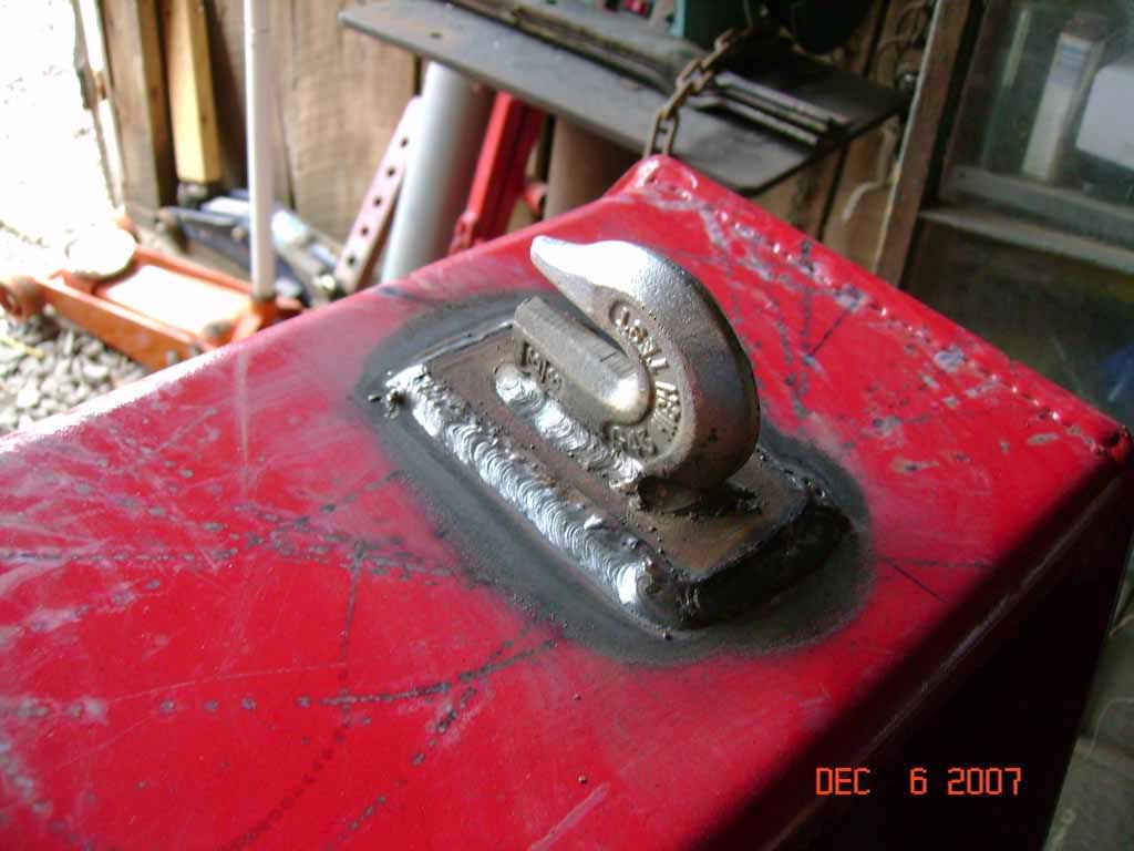

Slag knocked off of the beads...
The Center hook got welded on and cleaned up...
All cleaned up and ready for paint!
Not exactly Mahindra Red, but pretty close, especially after it dries...
All done!!
Ready to lift!

Excellent job!!! You're a WAY better welder than I am.
Thanks for the compliment, but, no, I'm not... I just have a little more practice ;). We all start out the same. My Dad (pro weldor) taught me how to stick 2 pieces of metal together when I was a little kid... and I've been playing with metal ever since. I can do vertical OK, but it isn't pretty... not enough practice doing that. Never have done overhead... just never had the opportunity or reason to. But, I need to set up something to do it sometime, just to learn. Dad says overhead is easier than flat once you learn how... I don't see how, but he says it's true. It's all practice... and having a tutor helps tons too. Get a tutor, and then PRACTICE PRACTICE PRACTICE!!!
You just have to get out there and burn some rods. Learn to watch the puddle, not the arc. Learn to make the puddle do what you want it to. Then your beads will start looking pretty good.
If you can, Learn to weld stick first... then you'll be a MIG master in about 10 minutes. It's not so easy going the other way.
I've got both SMAW (stick) and MIG machines in my little shop... but I'd love to get a TIG also. Maybe someday...:) Also have an Oxy/Propane setup for cutting/bending and brazing. If you're halfway serious about working with metal, I don't see how you can get along without an Oxy/Fuel torch, either acetylene or propane (or other fuel gas)... it's a Must Have.

Nice job! Was nice to see that you ground the paint off. You would be suprised at the number of people who do no prep work and expect it to hold and look nice. Give the overhead a try, I used to think it was fun. As long as I had the leathers on anyway.

When I am welding around hydraulic cylinders, I am always worried about damaging the chromed rod with splatter. I try to cover up vulnerable parts with a welding blanket. Maybe I am too paranoid. I see in the video Brian didn't seem too worried about it.
Yep, I could have burned through it with some 6010 or 6011, but, what's the fun in that:rolleyes:? And, it would have looked like poop... But, that's one of the advantages of SMAW... you can burn through a lot of junk on your material that will stop all of the other processes cold.
I probably should have covered them up... but at the time, I didn't think about it. But, I did check them before I started the tractor back up again... no sign of anything. I think most all the spatter has cooled to the point where it won't damage anything (like the chrome) by the time it travels that far anyway. And with no flat surfact to come to rest on, it just bounces off.
