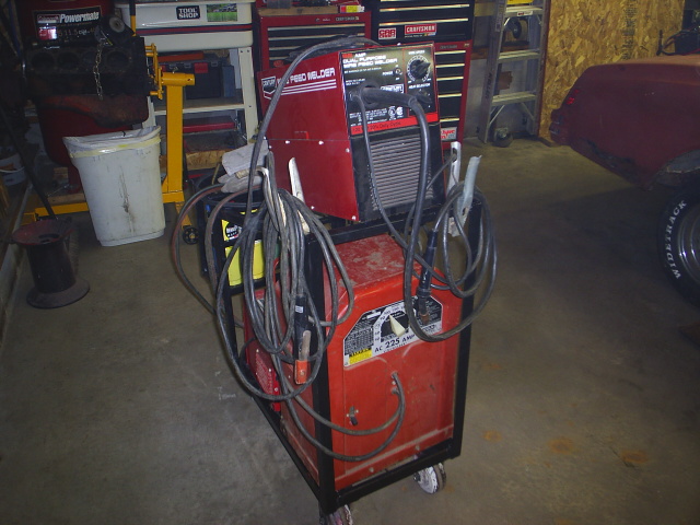

   / Welding Cart Question #12
I would also keep mine separate because my stick machine just doesn't need to be portable. However, here is a pic of a setup like you describe (minus the torch) that I probably got off Weldingweb or something. It appears to have a plasma cutter on there too.

   / Welding Cart Question #13
I built a cart. It holds a Lincoln AC/DC stick Welder, Miller 180 MIG Welder and a Miller 625 Extreme Plasma Cutter. My O/A torch is on a cart of it's own. The Welder cart also has space to store rods and a tool box that contains supplies, etc. I wired three Welder plugs into the cart, then wired a 30ft 220V extension cord. I can leave all three plugged into the cart and then use the extension to move it around in the shop. Or if I want to remove any unit from the cart and use them independently I can and use the extension cord to get power outside. My mistake was too small casters. It's a little hard to roll on smooth concrete and cannot be rolled outside. For my use in my shop (42x50) it's very convenient. With 220V plugs scattered around the shop I can use the tools anywhere. With all components, including a large tank of shielding gas for the MIG I'd guess the cart weighs 250lbs. I'll try to get some pics.
