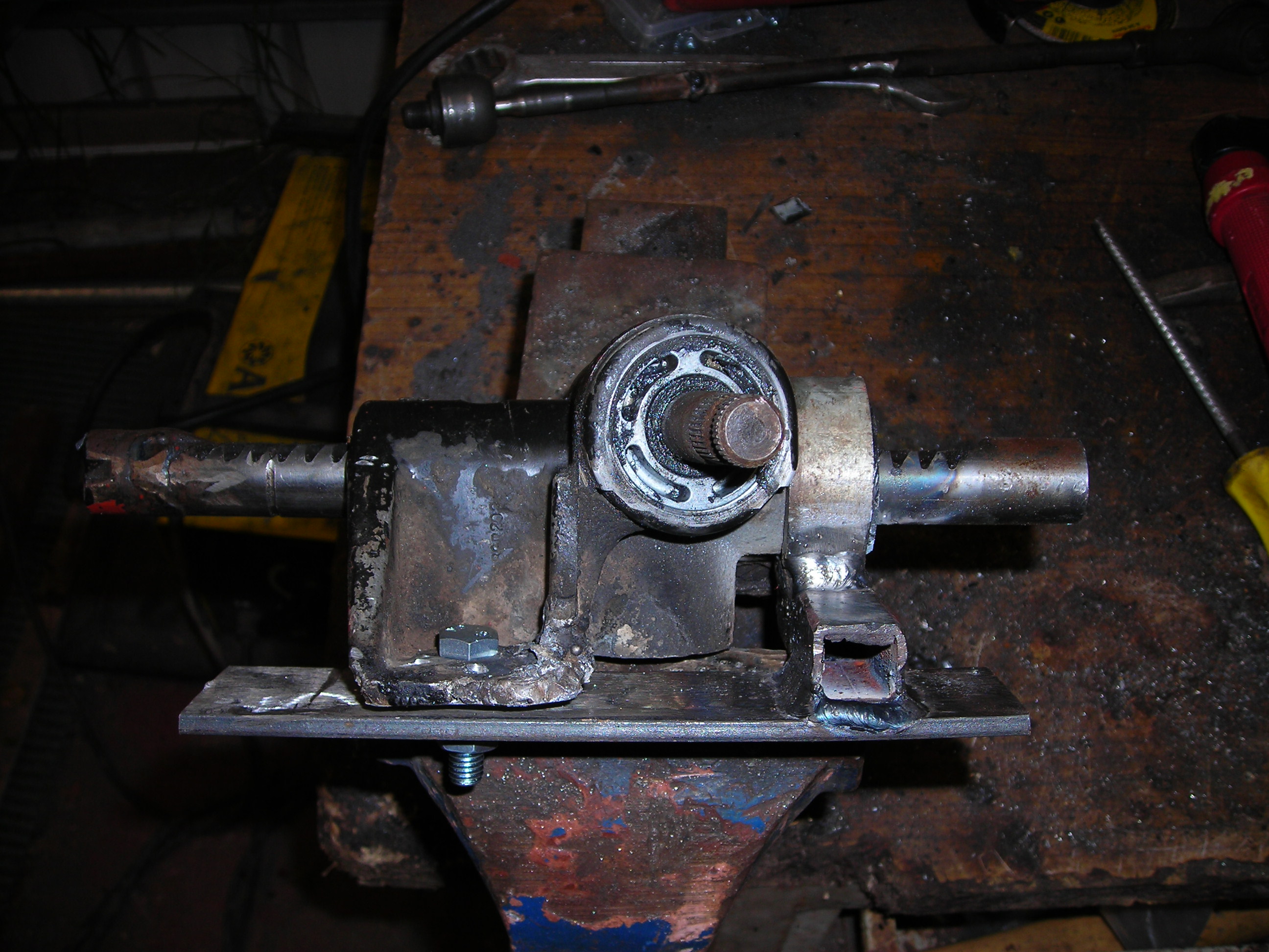

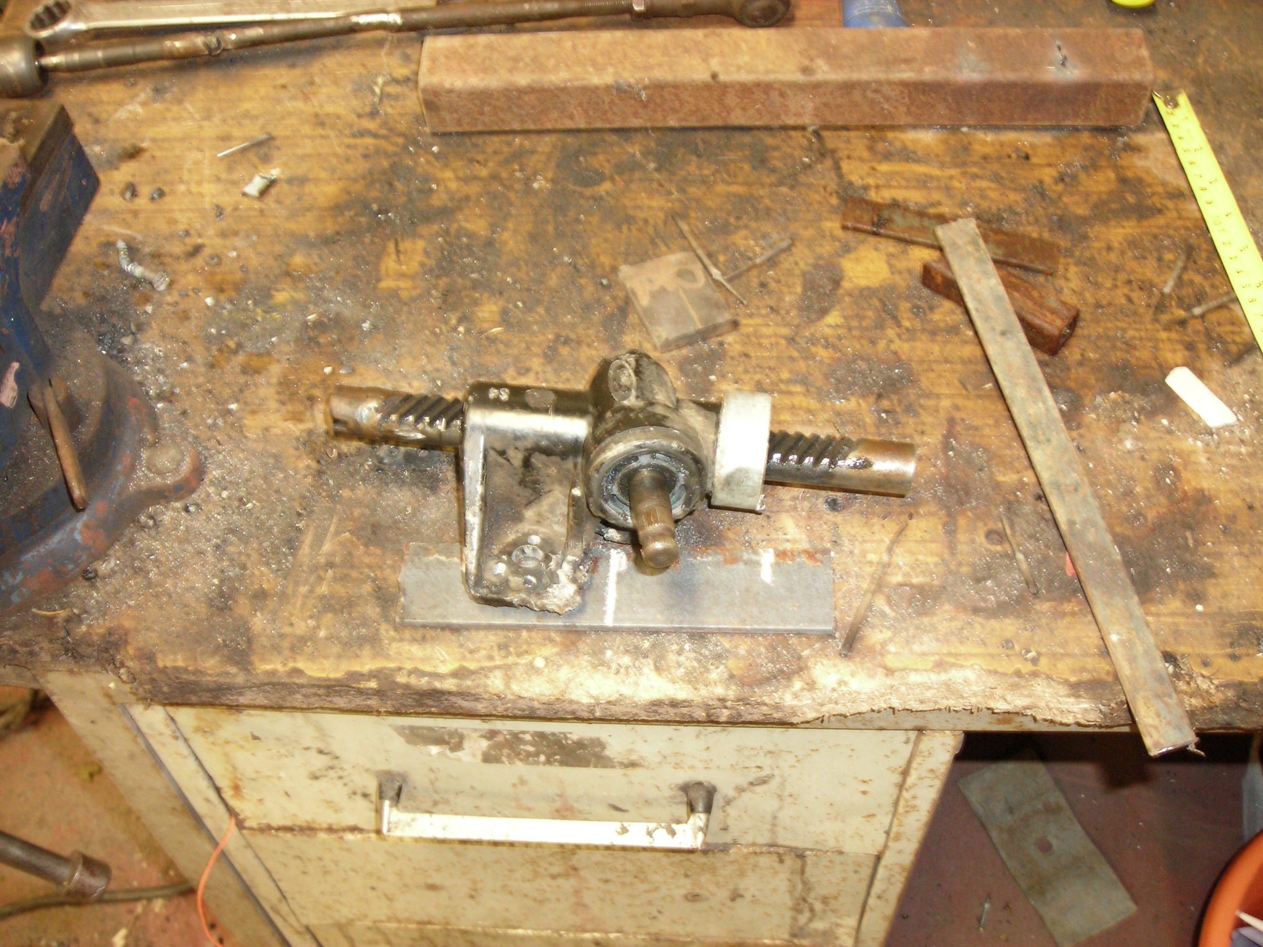

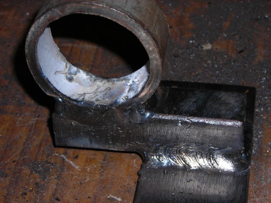

Taking peoples advise I knocked up this bracket to hold the steering rack in position. I got a piece of pipe which luckily was the perfect size to slide over where the boot seals should be. I then welded this to the bottom plate using a piece of 3/4" box mild steel. The rack is also bolted to the bottom plate using a m12 bolt which I havent got yet. I hope that this wll keep it secured whilst braving the mud..

I like the bracket... I think it would be much safer than simply welding the box to the frame....:D
Got a question though.. Is it just the pictures, or has the rack been cut and welded? Looks like some heat marks on the r/h side of the pic and on the left, it looks as though it had been cut and welded.. From the last pic, it even looks like it may be out of phase a bit from left to right... Just curious as it would cause steering troubles/binding.. Also, I would question the strength of the rack after being heated... I dont know much about welding a rack, but it sounds like a ,not so good idea.:confused: ...

The left side of the rack was shortened because on a car the steering wheel is on the right hand side (In Ireland anyway) and therfore the rack is also off center. In order to steer both wheels the left side is longer than the right. This didn't suit my setup so I cut the extra length out of it and rewelded the end which is threaded to take the tie rods. I did a pretty good weld on it so hopefully it will be ok. I hope I didnt weaken the body by heating and welding it but ill keep an eye on it. If i find its weakened I'll change it as safety is numero uno at this sort of thing...

I wish you luck with it.... I was just a bit curious... Let us know how the final product comes out..
