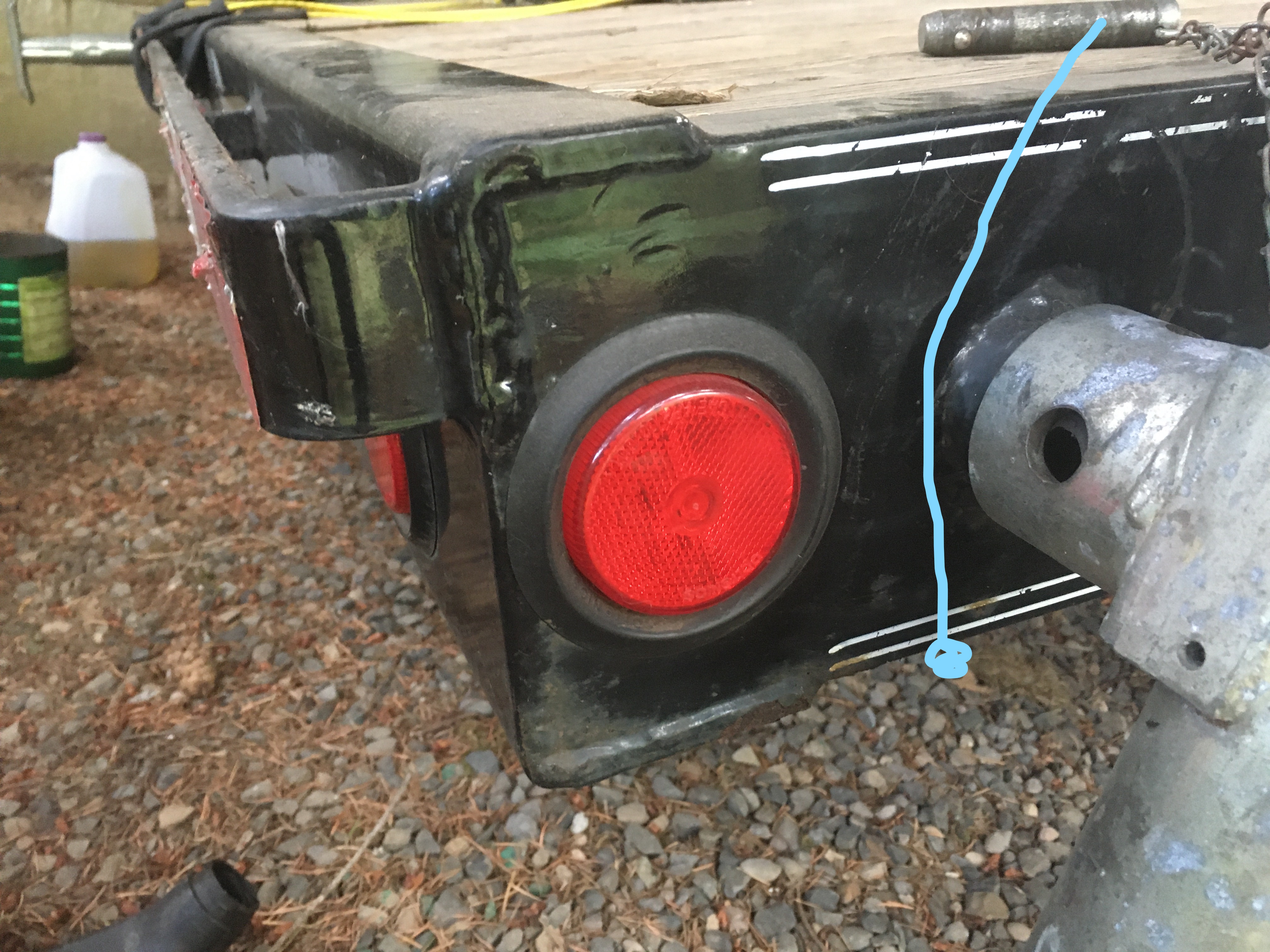

Not quite the same load as you're hauling, but with my 20' PJ I added removable D-rings to use in the rear stake pockets. I had bought regular D-rings to weld in place as you are wanting to do, but discovered there just wasn't anything solid enough on the rear flooring retainer.
I'm hoping that I never have to find out for sure if the stake pockets are strong enough!

I too am using stake pocket D rings in the rear most stake pockets but they just are not far enough rearward. I was hoping to hear that you had come up with a solution to welding rings to the rear piece of steel on the trailer.
I use a second set of tie-downs when hauling my tractor. If anything happens to the primary chain tie-downs I also install a set of nylon straps that has two straps from the frame straight forward to the front of the trailer and two straps from the frame to the rear of the trailer. The idea with the straps is just to keep the tractor from rolling forward or rearward long enough for me to notice the primary set of chains have been compromised.
My trailer as delivered only had 1 stake pocket behind the rear axle so I cut it off and moved it and added another stake pocket so I now have one as far to the rear as it will go. For that matter a flat bar with a hole in it welded to the frame at the rear will probably be the best that can be done.
   / Welding D rings to rear frame member of 18 + 2 14,000 PJ equipment trailer #14
I can't upload a picture, but in your 2nd picture, I'm assuming the flat bar at the back is for your ramps. If they are supported only there, it should be strong enough to use as a tie down point and you should be able to weld the D-ring to that.

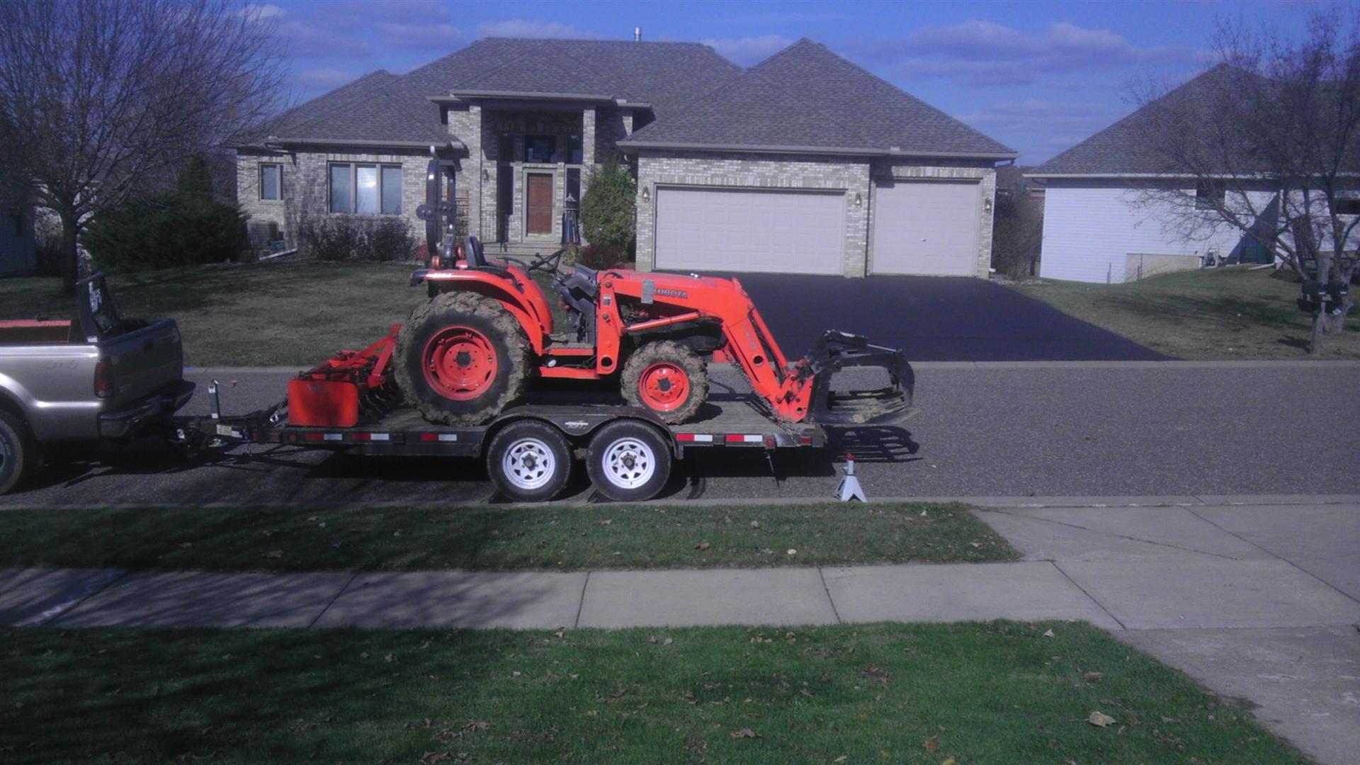

Is there a reason you can't run your chain as shown in the picture? Just hook under the main frame, behind the bracket for your stiff leg and on up to the tractor? There isn't much difference between doing that and welding a D-ring on top of the frame.

"Is there a reason you can't run your chain as shown in the picture? Just hook under the main frame, behind the bracket for your stiff leg and on up to the tractor? There isn't much difference between doing that and welding a D-ring on top of the frame."
I would like the attachment point to be further behind the tractor. You wouldn't have known this unless I had posted a picture, but the rear of the tractor is very close to the rear of the trailer. I have to do this to put the weight over the trailer axles and to keep the tongue weight under 2400 pounds.

Back the tractor on. It will move your balance point forward, in many cases. This may reposition it for better access to points of securing it.
   / Welding D rings to rear frame member of 18 + 2 14,000 PJ equipment trailer #19
Unless your trailer is like 30 feet it’s probably too short to not load it too tongue heavy.
   / Welding D rings to rear frame member of 18 + 2 14,000 PJ equipment trailer #20
Mine was 16', which is too short for a Gran L with loader, but it worked well for me for the time I had it. I think 22-24' would be an optimal length for tractors my size.
