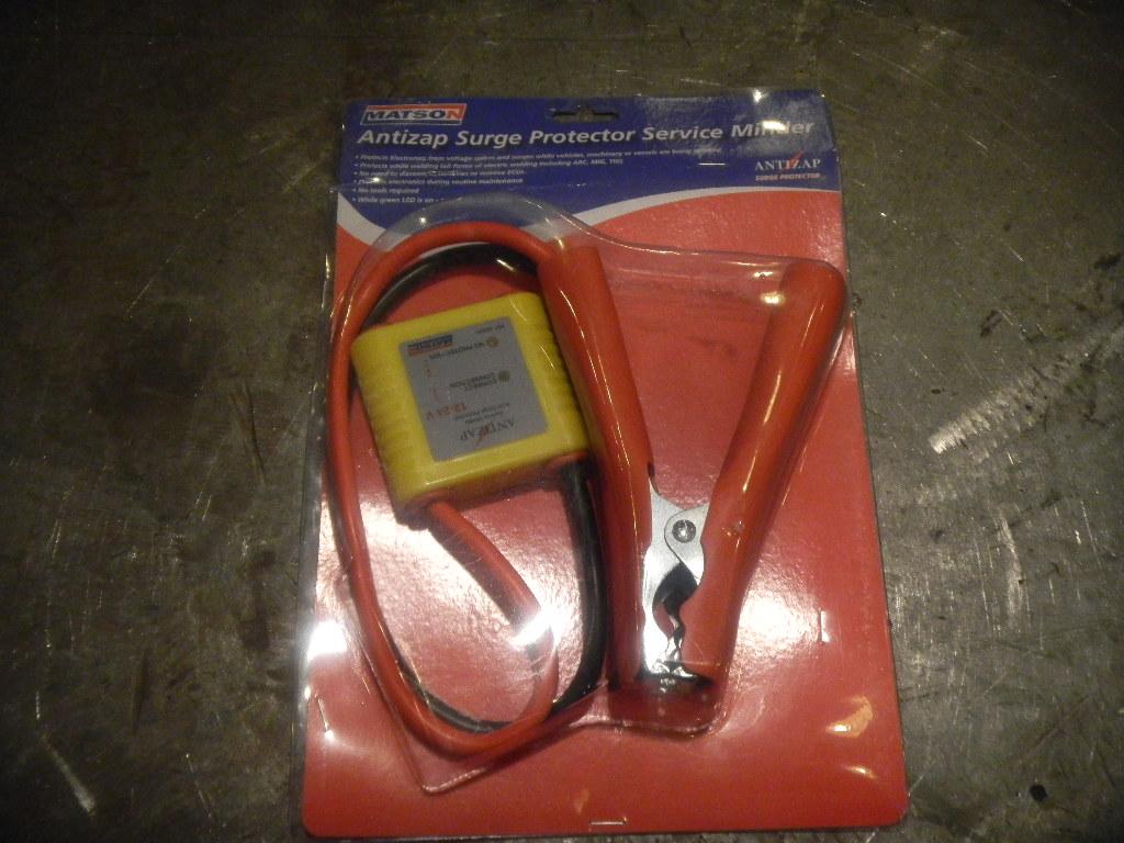

'HF flux-core welder' is what caught my eye. The 110 volt, 90 amp AC model? I think you need to be a skilled welder to do decent work with that one. I got better over time with mine but not to the point where I would build safety gear with it.
   / Welding guard on tractor with HF flux wire welder #25
I bought this several years ago, haven't had the opportunity to use it yet. Guys who weld on cars all the time swear by them.

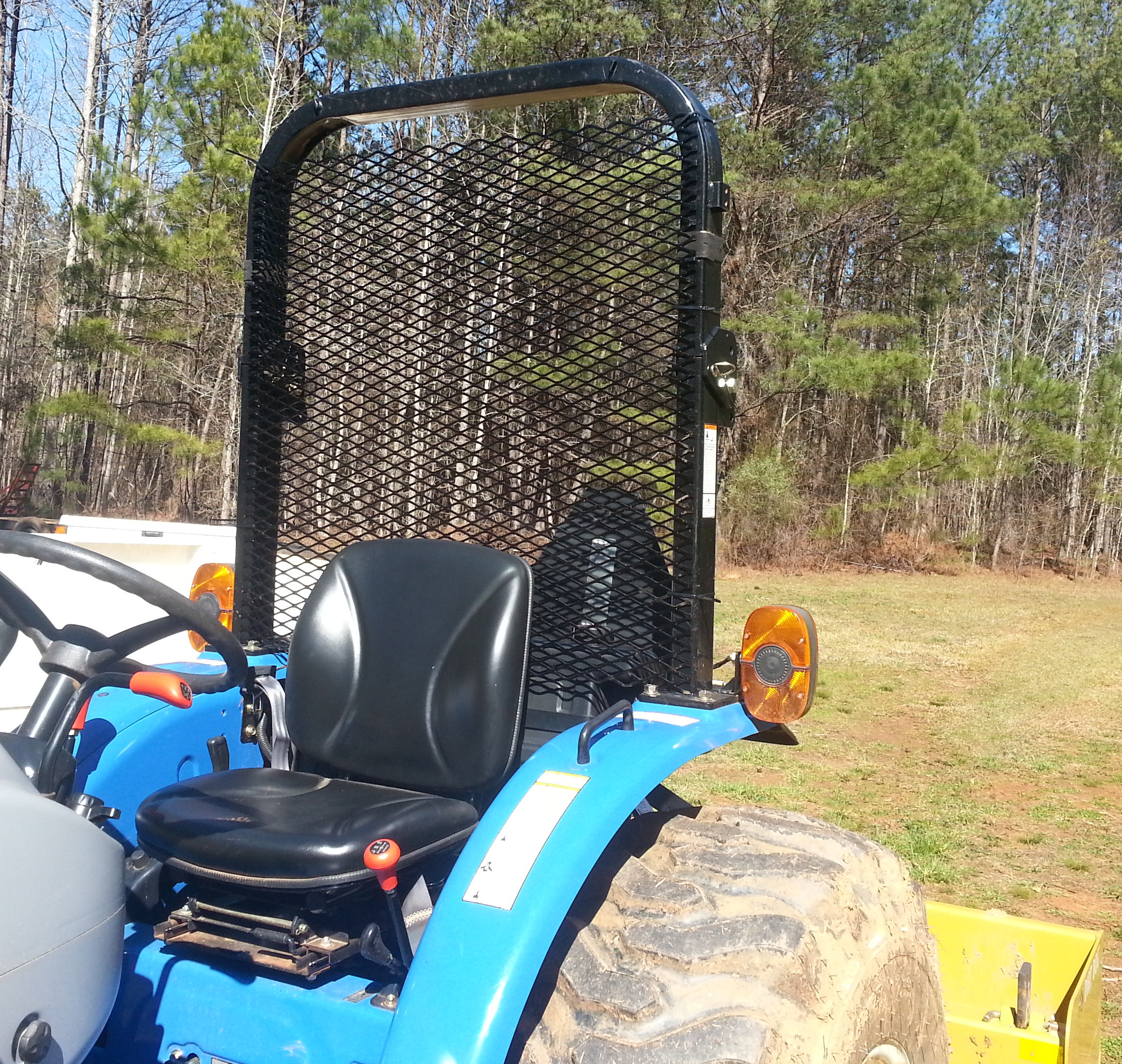

Zip tied it on today and it worked great. It'll need to be on the back side instead of the front for maximum strength, but I'll have to trim my expanded metal to go around stuff. I agree that a removable piece is the way to go and that's what I'll do. Thanks for all the suggestions!

You should consider making a frame that is removable. The expanded metal can be welded to the frame and the frame bolted to the ROPS.

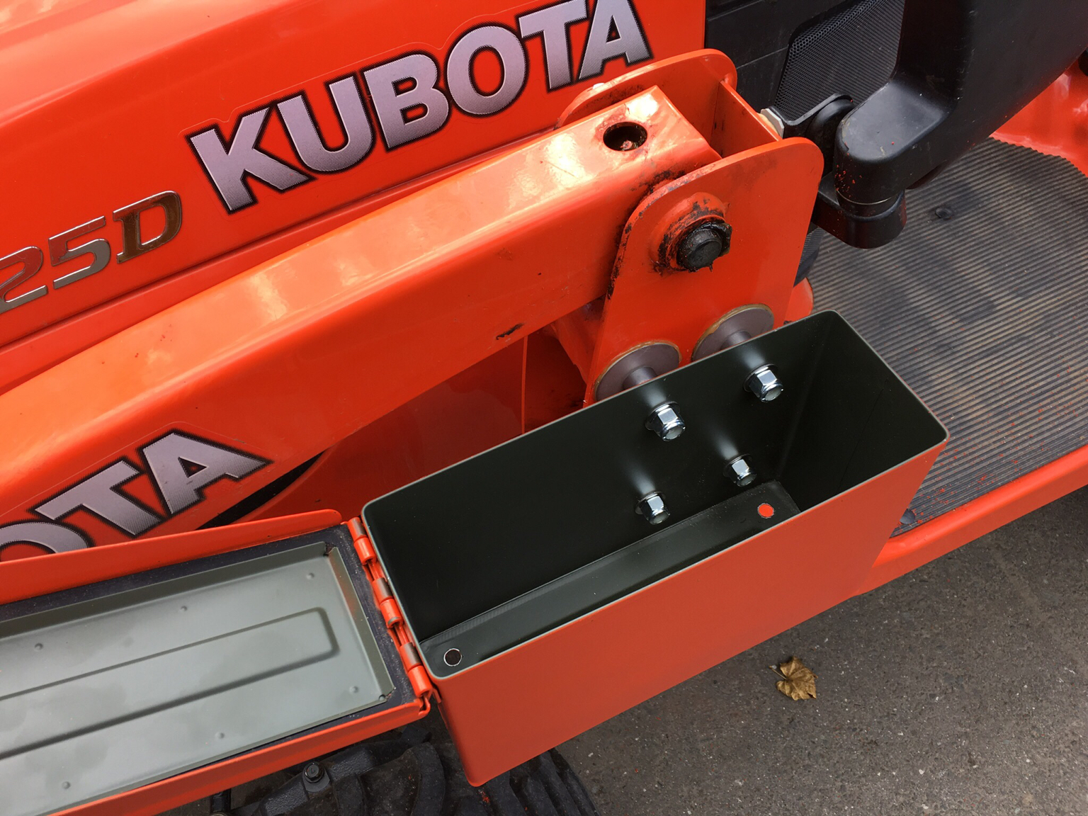

Or use Click Bond studs bonded to the ROPS. No holes, no hot work. This how I mounted lights and also **** boxes to my FEL towers. Get them at electricalhub.com.
   / Welding guard on tractor with HF flux wire welder #29
Looks good.
Keep an eye on those zip ties. I'd be concerned about the metal cutting through them when bouncing around.
