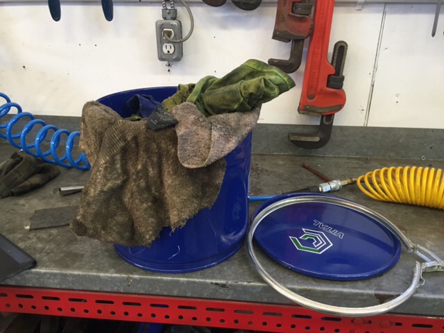

My fear is that you can't see where sparks are going while welding. My wooden shop is usually too messy and I seem to have a thing about having a lot of old rags around. Not a good environment.
Of course, I keep water and chemical extinguishers close by.
I do several fire watches afterwards, particularly using my nose.
Sometimes my paranoia gets the best of me, and I get up in the middle of the night to check. Same thing with the wood stove in the shop. It's amazing how carefull you become when you don't have any insurance!
Oily rags can pose a safety problem in ANY building.
Coincidentally I am in the process of writing a short story (picture book format) on that very subject.
"From Rags To Rich's"
At your favourite bookstore Spring 2017
Terry
