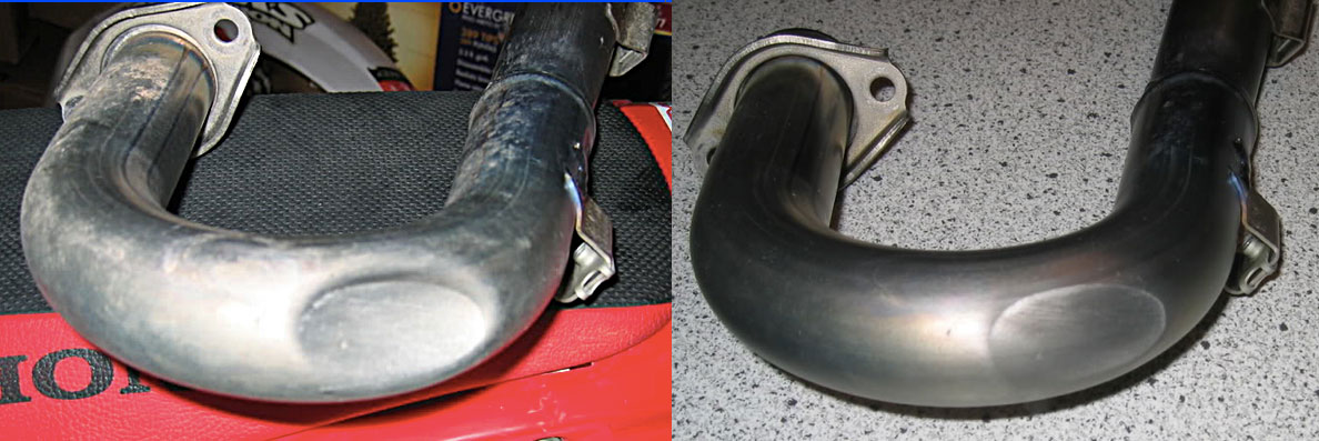

On motorcycles lots of guys pop dents out of their header pipes by repeated freeze/thaw in their basement freezers. Heres one where the guy says it took 3 freeze cycles. I bet its harder to do this repair near the end (inlet or outlet).
