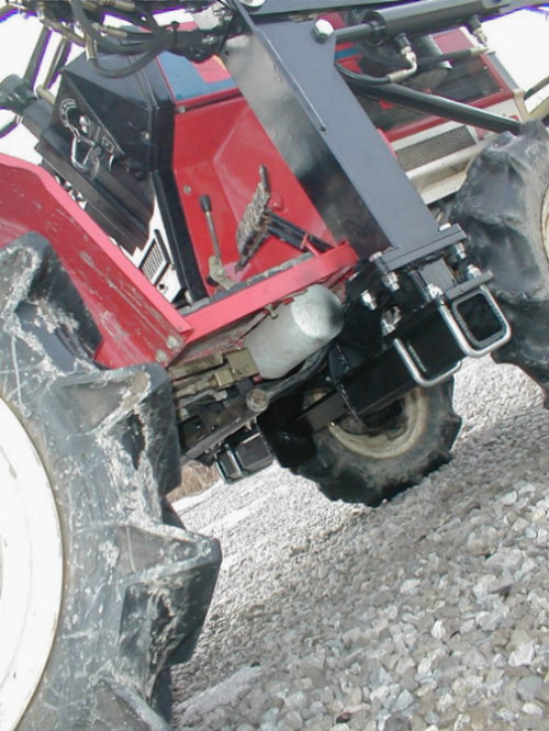

Under

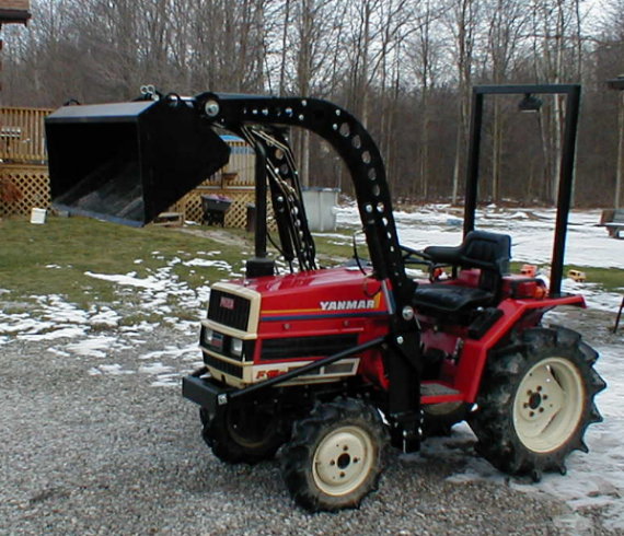

Bucket Up.
The loader seems to very sturdy.
I would rather have a Koyker but this was $850 less including shipping.
I had much more fab work with this one though.
Good thing I work in a machine shop!!
Tom
/ Welding Loader Mounts #13
That is an interesting looking loader. Let us know how it works out for you once you get some hours under it. I'm trying to soften up Whats-her-name to get her OK on spending the money for a FEL right now. Who makes that loader?
#15
$2200 to my door. Loader, 4ft bucket, universal mount kit.
I had to make the two plates that attach to the tractor, the bumper and the crossover brace, all of which cost about 20$. They told me that they will ship anywhere in the lower 48 for $200, which is included in the price above.
The local Koyker dealer was $3025 and I had to pick it up, but it included the mounts.
The arms aren't quick disconnect but the bucket is. You can take the bucket off in seconds.
Buck, I have the price list if you are interested I can email it to you.
http://www.helpmateloaders.com/
Tom
