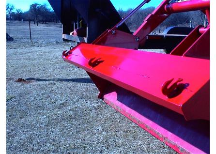

Welding hooks on was the first thing I did when I got it home. After I welded on 1/4" angle iron to strengthen the top lip of the bucket. Here's a pic........
Chuck
