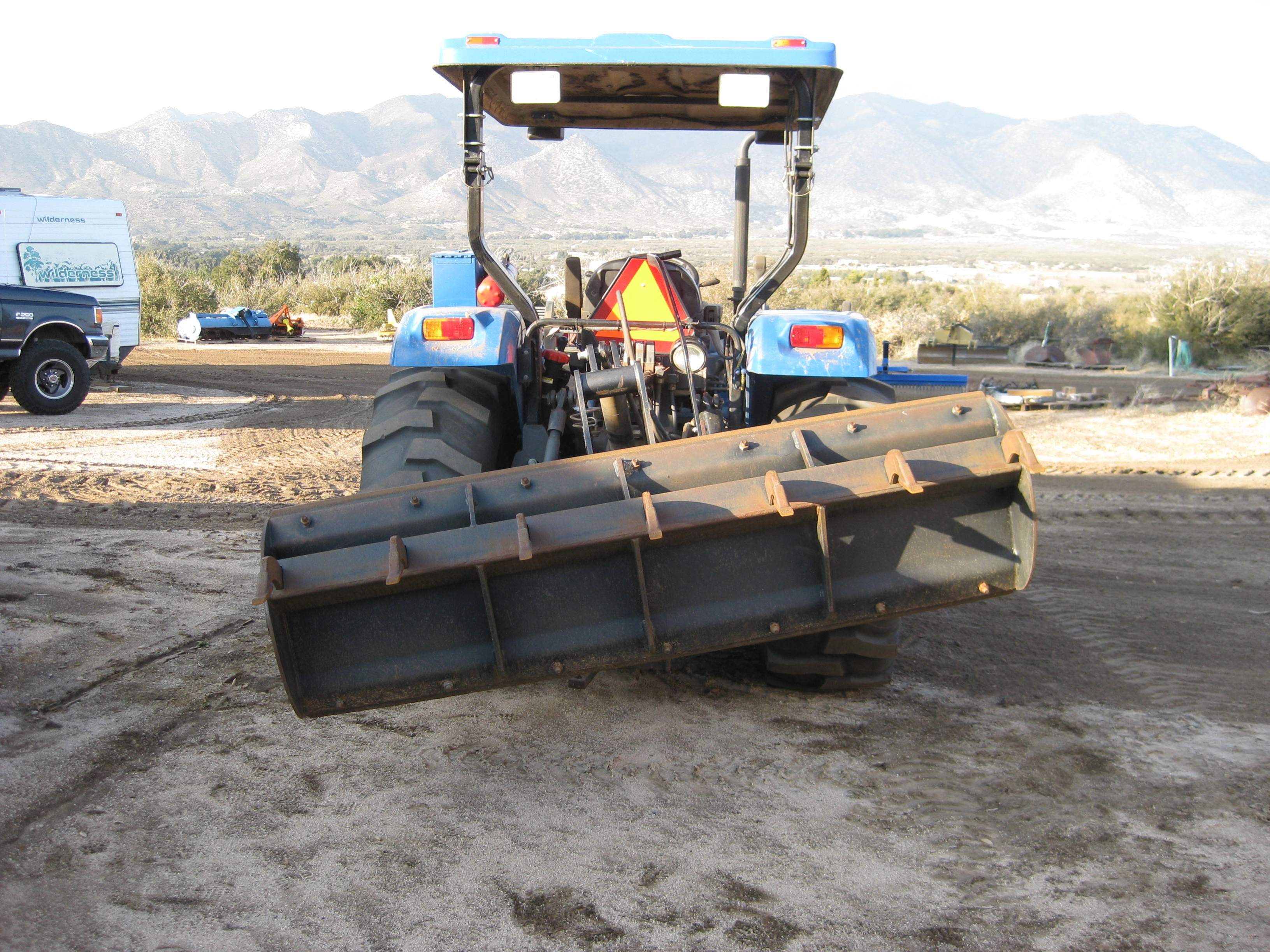

To start with, to get full strength of a bolt, it needs to screw into whatever as far as the size of the bolt that is being used, 7/8 should screw in 7/8 and so on. Any one that cleans out ditches or is making ditches would use full tilt IMO. On my tractors that is only 11 or 12 degrees. My small tractor has a 4" stoke and my bigger tractor has an 8" stroke. As you can see, my box blades really don't tilt all that far and you are talking about cutting that tilt down. :eek: Whenever I build a side link, I do my best to match whatever the stock adjustable link has for its adjustable capacity.
My feeling is that what you are asking for would take a very long time to pay for the initial investment and is most likely why it does not currently exist.
Again all of this is just my opinion of what you have asked about, if someone chooses to do this, all the more power to them.

another thought...would having boths sides adjustable not give a greater amount of tilt? I have seen hitches with cylinders on both sides but not sure why?

If your tractor is similar to a B3030, that top angle that you are talking about is 14 degrees. I have no idea if CCM figures that type of thing in their building of it. If you were to purchase a Side Link from me, it would have ends that were like the factory ends at the factory angles that you now have with your standard link.
Yes having both sides adjust will give you double the possible available angle. I believe that 3RRL has double hydraulic Side Links on both his and his wife's tractors. :cool2: Many of the cat 2 tractors come standard with 2 adjustable Side Links. :cool:
