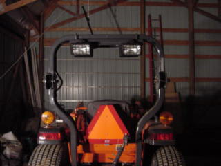

   / Welding onto the ROP #6
Jim,
I just added work lights to my L3710. I toyed with many different options, and read through many posts on different suggestions of how to mount work lights. There were a lot of good ideas. I was tempted to drill holes in my ROPS but after seeing how some other people mounted their lights I decided to mount my lights using square U bolts a two pieces of 2" angle iron. It turned out to be much easier and if I decide to remove them in the future I am not left with holes or ground off welds. The wiring was simple also as I used a three position toggle switch to control the lights. The back position turns the back flood lights on, the center position is off, and the front position turns the trapizoidal lights on. The switch mounted in an existing hole on the fender. This was a combination of several ideas that were posted on this forum, and it worked great. I enclosed a picture (although not a very good one) that shows the finished product.

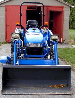

   / Welding onto the ROP #8
What would be wrong with mounting a light at the end of the FEL arm, right before the joint that goes down to the bucket? (see attached)

   / Welding onto the ROP #9
I like top inside corners of the ROPS for lights because you get best protection and higher lights give better illumination around the tractor. On my rig I put one facing forward, one back, with pushbutton switches in the bottom of the light housings - easy to reach. Power is from the worklight circuit red wire near the right tail light - ran the wire up through the ROPS - took some fishing. Very neat and so far have not banged my head on them, or wiped one off on a tree branch. The way I use my tractor, extra lights wouldn't last very long mounted anywhere else.
   / Welding onto the ROP #10
Mike great setup but you obviously don't use your loader like me. I'd give those lights 2 to 3 minutes before they were hanging from their wires. Thats another thing that bugs me about some loader manufactuers, I like having my hydraulic connections on the sides of the cylinders not the top. I often use the cylinders as part of a carrying platform for plywood etc with the bucket being the stop that holds the bottom of the material. As far as welding to the ROP's, not a problem provided you don't over heat the suface which for some little brackets for lights is going to be pretty tough. Weld or drill, you'll be OK. A mig welder will heat considerably less then a stick welder. Rat...
