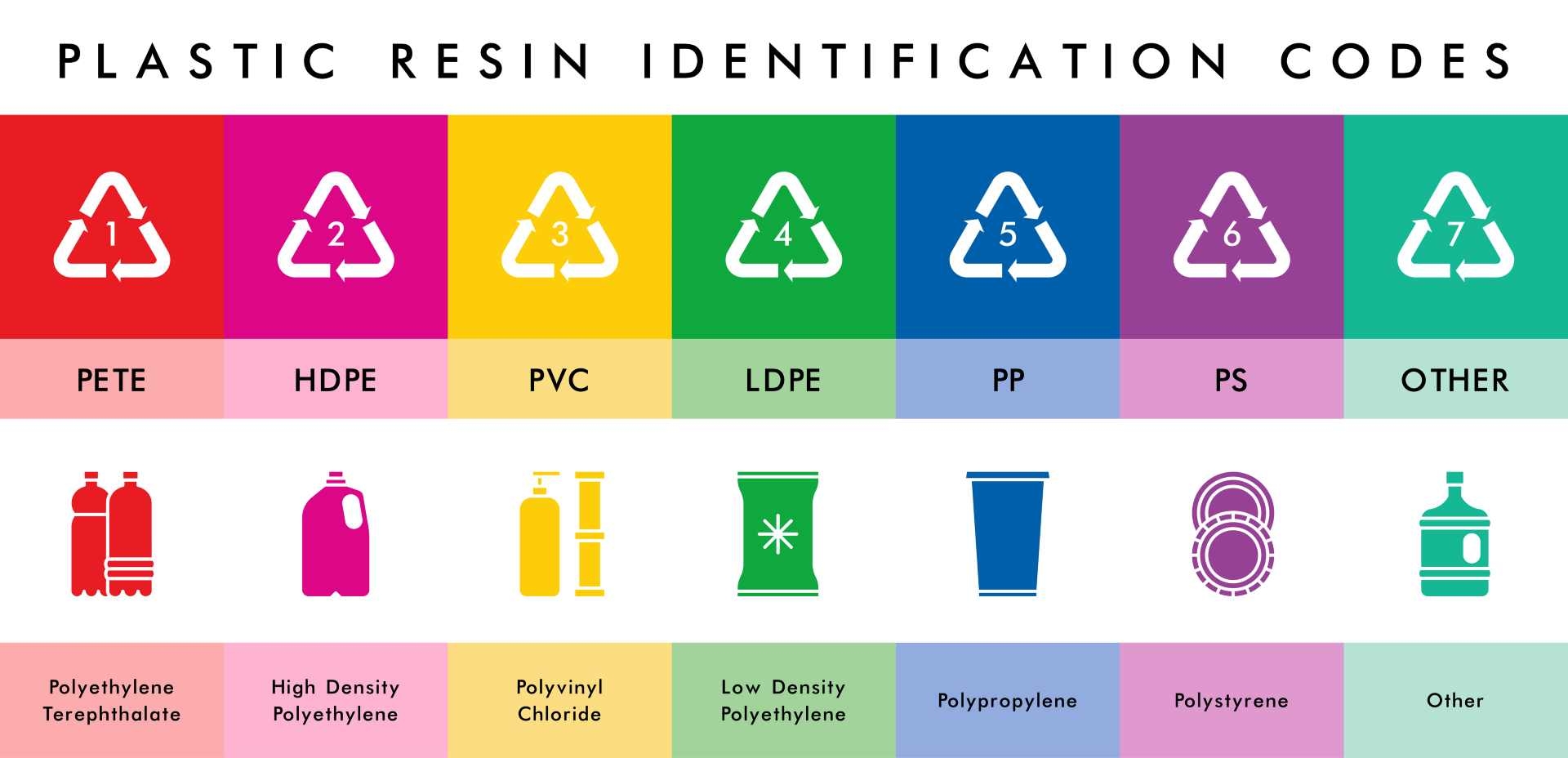

I've done a lot of repairs on ATV plastic. Most of it is High density poly ethylene. HDPE. LDPE rods work fine on them as well. My tractor fender acts like ABS when I try to melt the grille cracks. I haven't figured it out. Fiber glass mat and resin didn't hold, several plastic rods didn't stick but I was able to do a nice repair with the staples. One other thing on the staples. You can buy them and just use a lineman pliers and hold the staple over a candle to heat it up. You really don't need the electric gun. You can even make your own staples out of thin stainless wire for custom repairs.
Your fender might be a polycarbonate

Should show something molded into plastic ID, like these
