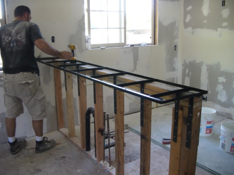

<font color="blue"> Framing for a bar (offset for stools). My main guess. </font>
Yep that’s it. We have a winner. /forums/images/graemlins/cool.gif You get to be first in line when we try it out.
I built the steel frame so that all the support would be hidden. when it’s finished it should look as though the counter top is balanced on the top of the wall with nothing holding it there. After installing I put all my weight on the front bar of the frame and it doesn’t move at all, it’s plenty strong.
The attached picture showed the frame when we first installed it. No the big guy is not me, that’s my step son. He helps me on this project when he gets time off his job. for scale the top of the wood part of the wall is 45” and the big guy is 6’5” I mention that because he makes everything else look small.
Fred

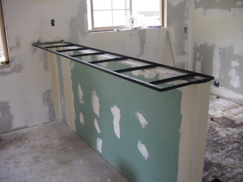

Here is a view with sheet rock in place. Didn’t need green board but that’s what I had available.

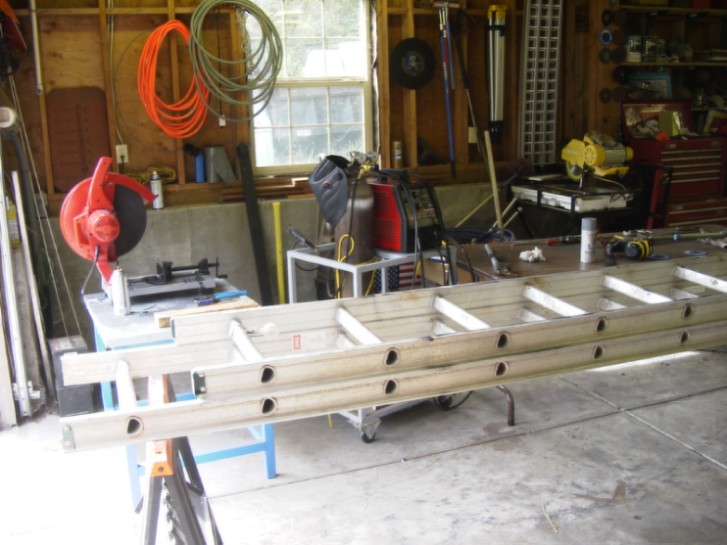

The challenge with this project was not the welding in itself but finding some way to keep everything aligned during welding. I started working with a temporary welding table that I just threw together. A 6’ folding table and on top of that a couple large sheets of steel. I quickly realized it wasn’t flat enough.
At that point I had the side rails and all the cross pieces tacked in place. I knew if I just finished welding without locking everything in place on a flat plane, the metal would move every which way to the point that I would have a mess I’d never be able to fix.
I was stumped for a while until I stumbled on the solution. I mean I actually stumbled on the thing. there was an aluminum ladder that was constantly in the way at the building where I’ve been working so I had taken it home the day before and just set it down in the garage. So when I started looking for something long and straight to lock down the frame I was building, I tripped over the ladder, which annoyed me so I picked it up to move it and...........Hay!! this ill work! /forums/images/graemlins/laugh.gif
So the ladder and a bunch of clamps did the trick. /forums/images/graemlins/cool.gif
See attached

The way that wall is framed, the last post (closest to the camera) is a 4x4 that goes through the floor and is firmly attached to two floor joists to make it ridged. otherwise the wall would only be supported by the base cabinets. the way it's built it's already very strong even without the cabinets.
