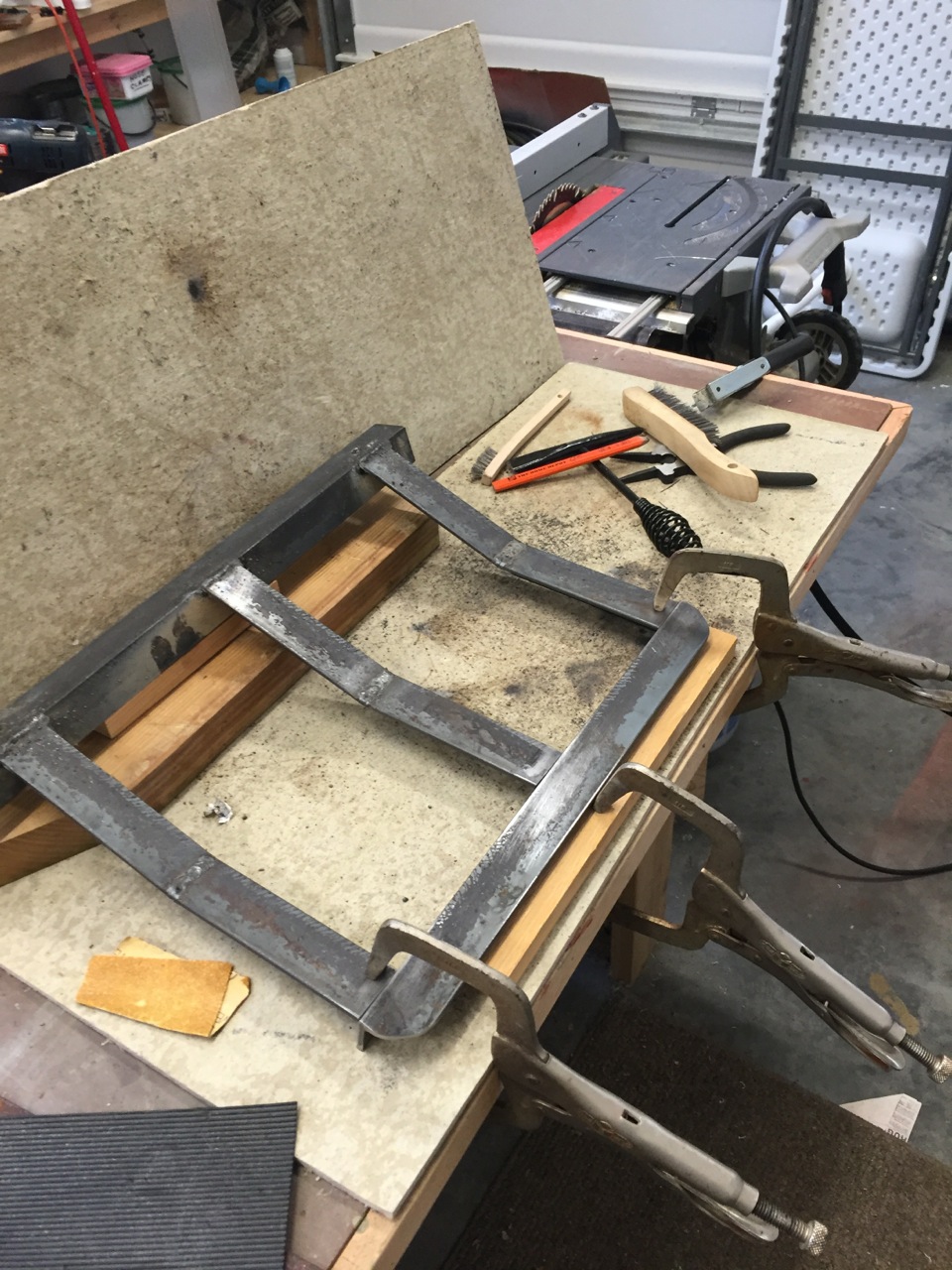

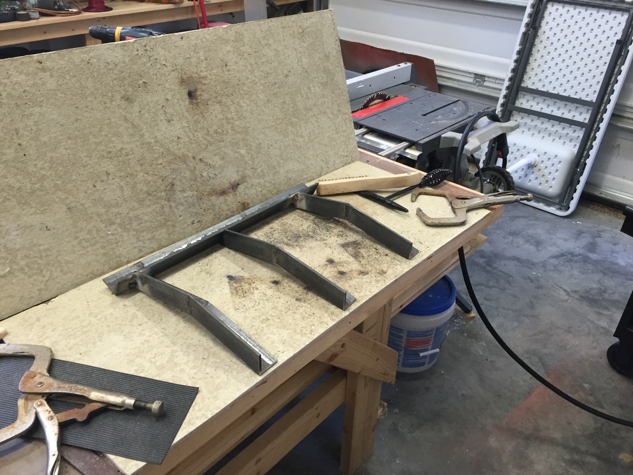

Made this up for my splitter a couple weeks ago and finally got around to posting pics. They wanted $80 for the factory catcher, and I knew I could weld a better one up for a fraction of that cost.
It's interesting to weld up a design with a lot of angled cuts and parts that need to match, as it really forces you to plan things and jig things properly.

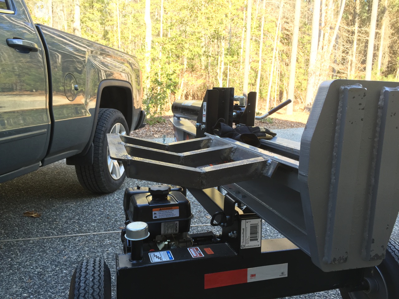

Good job. Looks like it will protect the engine too. BTW, looks like we have the same welding table. :D
/ welding project: log catcher #3
Looks very functional. :thumbsup:
I would skin my knuckles up pull starting with that on there. :confused2:

It's a good thing the pull aims out sideways, because I didn't even think about that part! That would be just like me to overlook something important though...
Great weldment. ... You will need a couple braces angled back to the beam to ease the cantelever stress at the root, or sizable log splits flopping down will finally crack it.

Is it welded to the beam or bolted?
Do have enough access to the motor and pump?

Bolted. Was tempted to weld it in place, but would have to deal with the gas tank first to make welding safe, and the splitter already had bolt holes. Plenty of access to everything below.

I may do that at some point -- or use a block of wood as mentioned above -- but so far the rigidity of the catcher and mount is more than enough for the wood I am handling. I have put a healthy amount of body weight on the catcher to test it.

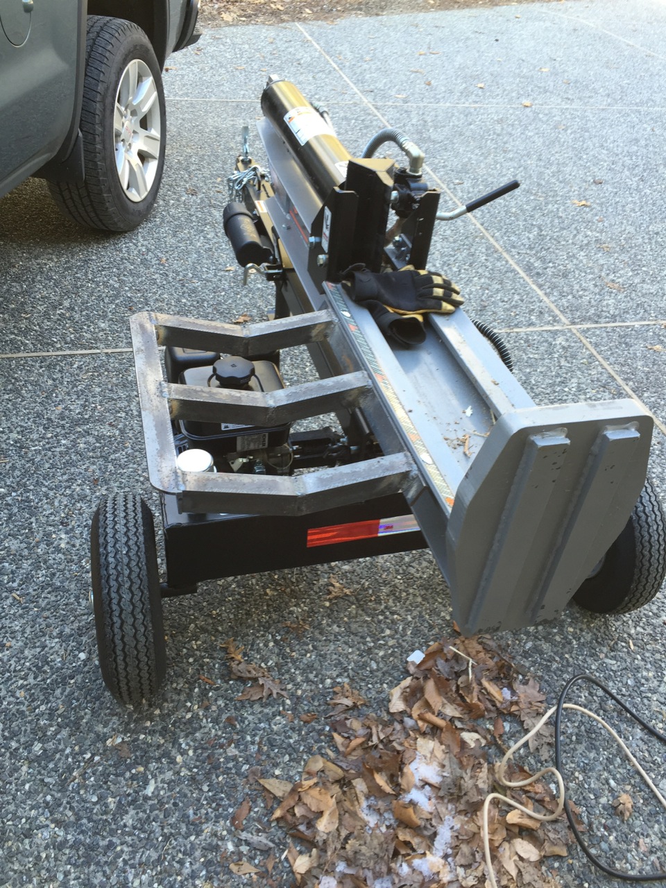

I doubt you'll need any more support. I have a Speeco shelf which isn't quite as heavy, and it only has a couple bolts similar to yours. It handles "2 man" logs dropped on it just fine. It's a lot stronger than I expected it to be. One thing though, you might want to add a couple small '****' or short spikes on the surface of the cradle. The vibration while splitting encourages a waiting log to walk off the end occasionally. It would take much of a spike or edge to hold a log rather than let it skid off.

I like the valley on your spliter beam, but where does the splitting debris go, do you have to keep removing the stuff by hand?
#16
They cut two slots near the end of the slide/cradle that are big enough for most crap to fall out. It keeps getting pushed out on every stroke. I think I only had to clean debris out by hand a couple times.

Nice job. I like the valley you put in that. I made mine flat and inclined slightly towards the splitter. It works good until I try to pile a bunch of small rounds on it before they are split. They want to roll into the splitter. A little valley like you have would prevent that. I agree, if you use vertical some times like I do bolt on is the way to go.
