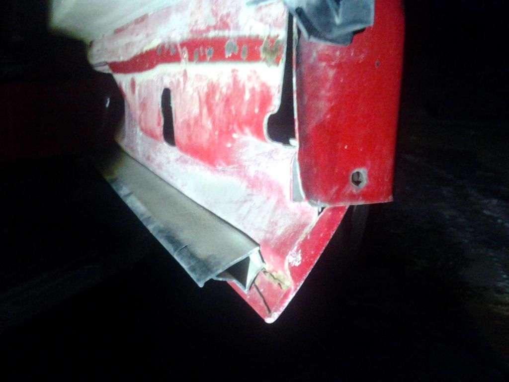

My truck is an extended cab. My only complaint is the doors don't shut as tightly as I'd like. Overall I think the Super Duty is very user friendly. Several little features that appeal to me and make life in the cab better. My truck is a leaf spring model and I really like how it drives and rides.
Ext cab doors are prone to the spot weld by the latch breaking, allowing the bottom of the door a little movement, which in turn allows the front door to move. Simply reweld the spot weld... amazing results.
You can see the broken 'spot' here... lower right...
Greg, you stud you, just checked out my rear doors. Both sides are broken. That's my morning "shop project" for today.
THANK YOU VERY MUCH FOR THE TIP!!!!!! :cool:

Greg, took 10 minutes to fix them doors!!!! Thanks again for the tip. Much better!!!! :)
