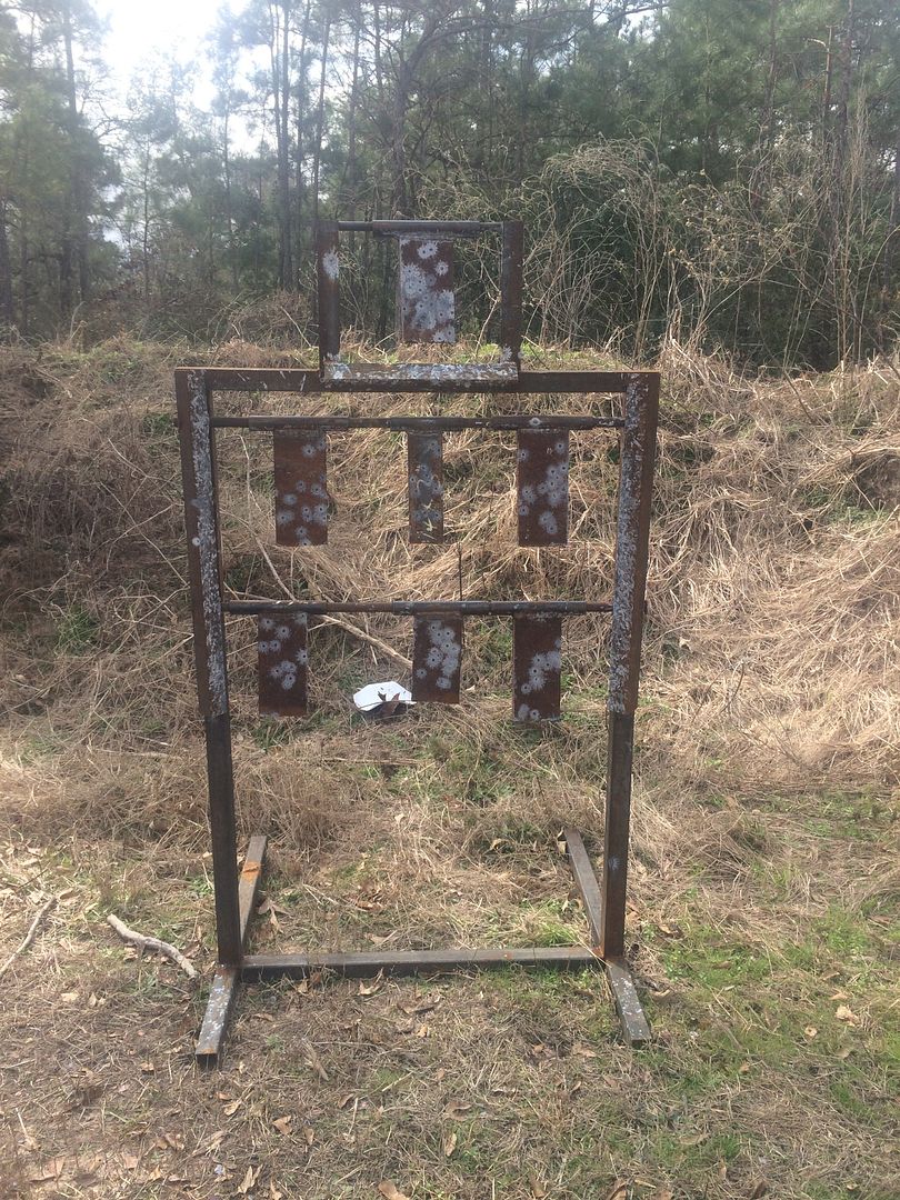

Ar500 is the best choice but I built a tree out of 2" tubing and hung 3/4" plates on a solid rod so they can swing. Zero damage from pistol rounds up to .45acp unless you clip the extreme edge. I made the mistake of running some 5.56 at and it and it dinged it up much worse than I would've thought. Only shot one Mag before realizing it was no Bueno. A few days later I went out to shoot a .45 and the round found the crater and I got fragged pretty good. Still have some in the abdomen and chest. I usually throw on my 3a vest when shooting steel but complacency got me. Steel is a blast to shoot. If you can't afford the ar500 use extreme caution with a36. I'll get some pics of my setup
Brett
   / Welding up shooting targets? #49
Got a pic for the do it yourself crowd. Like most of my projects, I shot from the hip but am happy with the results. It's dynamic and besides that previous incident seems reasonably safe. There's a distinct line where the frags are directed. I have yet to hit the frame but some friends were not so considerate. I welded the angle on as a way to protect the frame but in addition to doing that, it directs the frags. Gives you a bit of a safety cone as long as you stay in it
Brett

If it takes 3/4 inch steel to stop a .308,
Only if it's mild steel. 3/8" AR 500 will not be hurt by a 300 win mag at 100 yds (as close as you should be shooting a rifle at steel.
If your shooting steel that craters sooner or later it will send something back at you, the surface needs to stay flat.
You can see the difference in this high speed video. Mild steel plate sending stuff back at the beginning and around 7:30 in is AR 500 and lead splatter going radially parallel with the plate.
