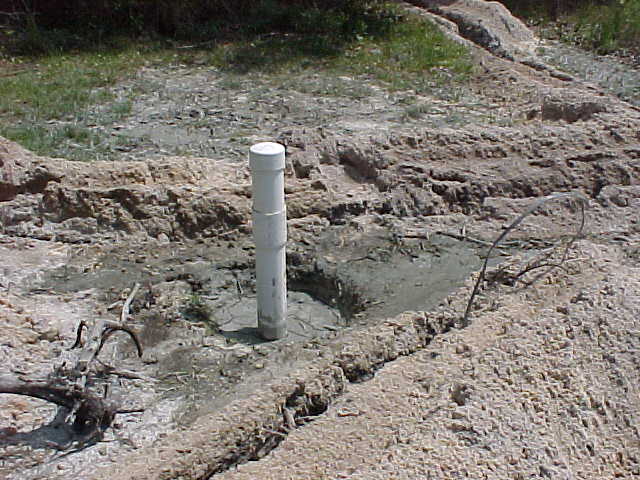

I installed a Hudson float valve at the edge of the pond. I don't have a picture, but later I revised it a bit and installed a ball valve on that line near the top of the bank, so I can shut off the float valve without shutting off the rest of the water, if I don't want to maintain the pond level for some reason.
The Hudson float valve looks a bit like an upside-down flower pot. Inside, there is a float that lifts straight up when the water reaches the level, and shuts off the flow.
In this picture, the pump has been running for about 17 hours. The piece of PVC stuck in the ground was put at the water's edge at 11 PM the night before, and the picture was taken at 8 AM the next morning. The water has moved about 3' up the bank in the 9 hours. I didn't mark where I started at 3 PM the day before, but it was about 3' further. In other words, the pond in this picture is about 6' wider all the way around, or about 12' wider in diameter. It's roughly a 5:1 slope, so in this picture, the level has been raised a little more than foot. The goal is about halfway up the bank from this point, or about another 12" to 18" in depth. The pond will be a total of about 25' wider in diameter at that point. I'm not being very precise; I'll set the final level of the float where I think the pond looks good.
