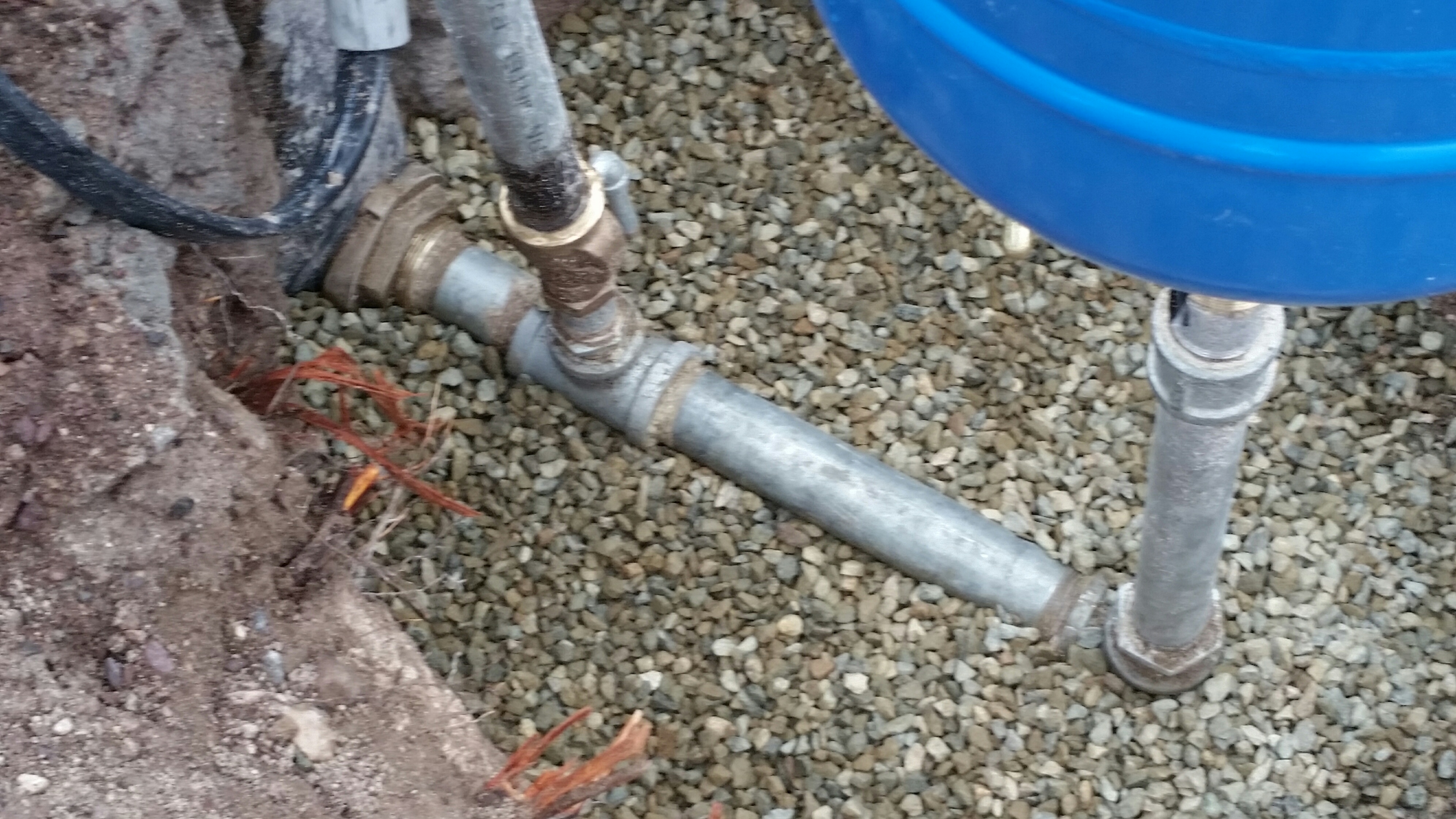

Well installer put in the temporary tank and frost free connection. Once the home is built the tank and controller will be mounted inside a garage. They used a galvanized pipe as seen in the photo.
For now, how should I fill in this hole?
I don't want to bury it completely since I will have to excavate it again once the house is built and then I will have to trench a line from the pitless to the home. I put some pea gravel at the bottom. Can I fill the hole with more gravel and then put in a thermal blanket over the pipes and then put a landscape box over it? The frost line in my area is 18".
This way it will be easy to access the pipes when it's time to run the line to the home. I will use 1" PEX to the home.
