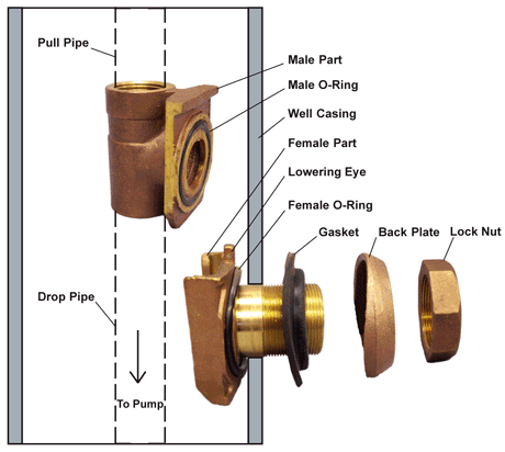

We don't use pitiless adaptors here so I don't know about that, but if a stainless one is available, I would opt for that also.
