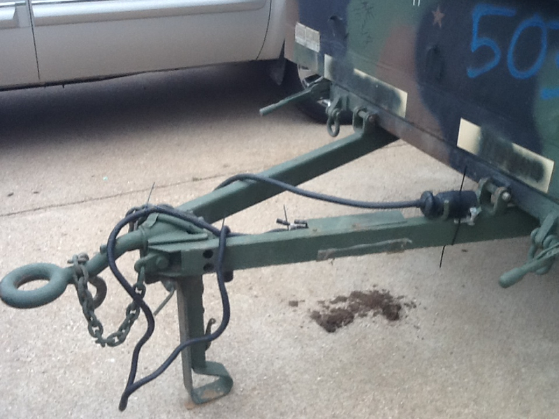

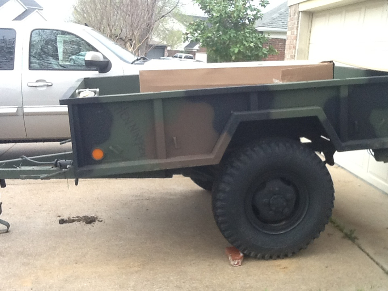

Well here are some pix. I installed a 7 pin plug and may take the mil lights and harness off.

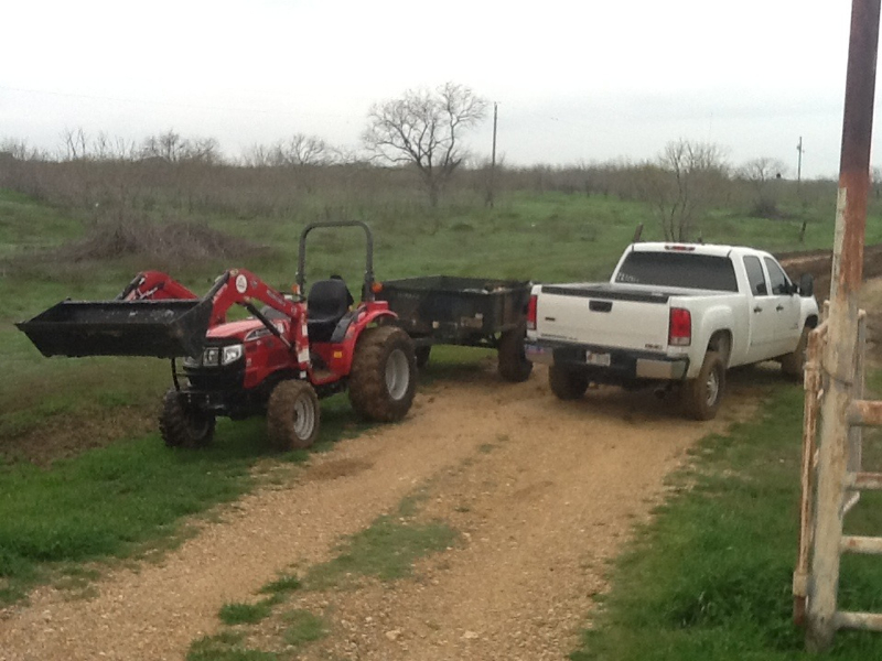

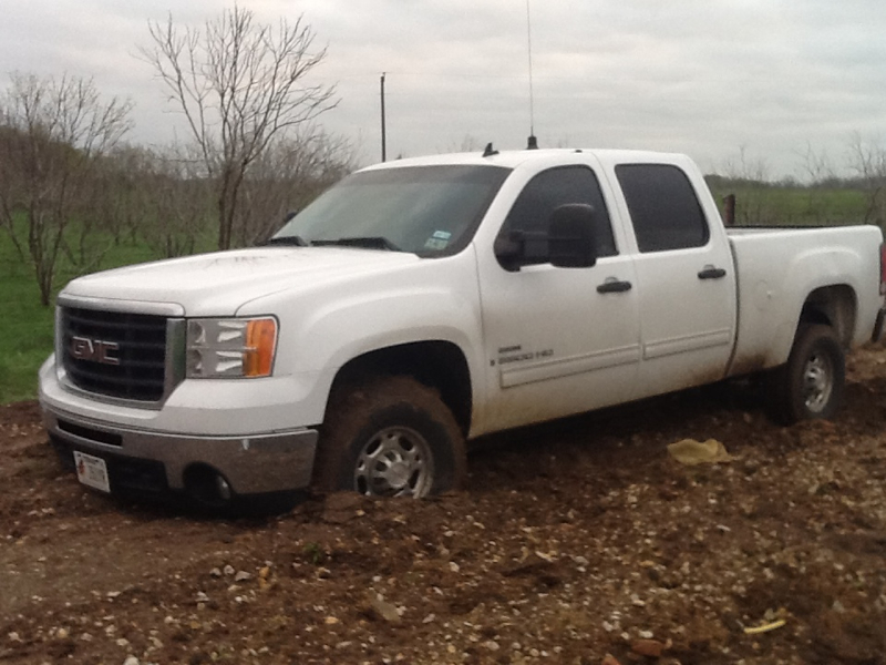

Well, got the trailer out to the Ranchito at 0 dark 30. I swear it didn't look bad. Unhooked the trailer, hooked up the tractor and pulled the truck to the front. Put the trailer on the tractor,loaded her up and up to the camp I went. The trailer paid for its self this morning. The 3pt hitch adapter really made hooking up a breeze.

You are going to need some better tires or a crap load of gravel.

I am thinking a few crap loads of fill dirt and gravel.

The problem with the m101 is the budd wheels. The m101a2 has 8 lug GM wheels and surge brakes.
Although they might be marketed as dump trailers, fact is they really are not as bcp already said.
You don't have to take the MIL lights off. Just substitute 12 v bulbs for the 24v bulbs. I think you substitute #97 bulbs and #1156 bulbs if I remember right. You can also disconnect the front harnass at the front cover and patch in a normal 4 way connector.
   / Well, getting a M101 3/4 ton trailer #10
I'd keep the mil lights too and convert them to 12v. they're rugged and watertight. If you do decide to replace them don't trash them as there will be someone out there who wants them. Many Hummer H1 owners like to swap out the civi lights for the mil lights front and rear. Put them on ebay if you can't find a local buyer, they'll go quick.
