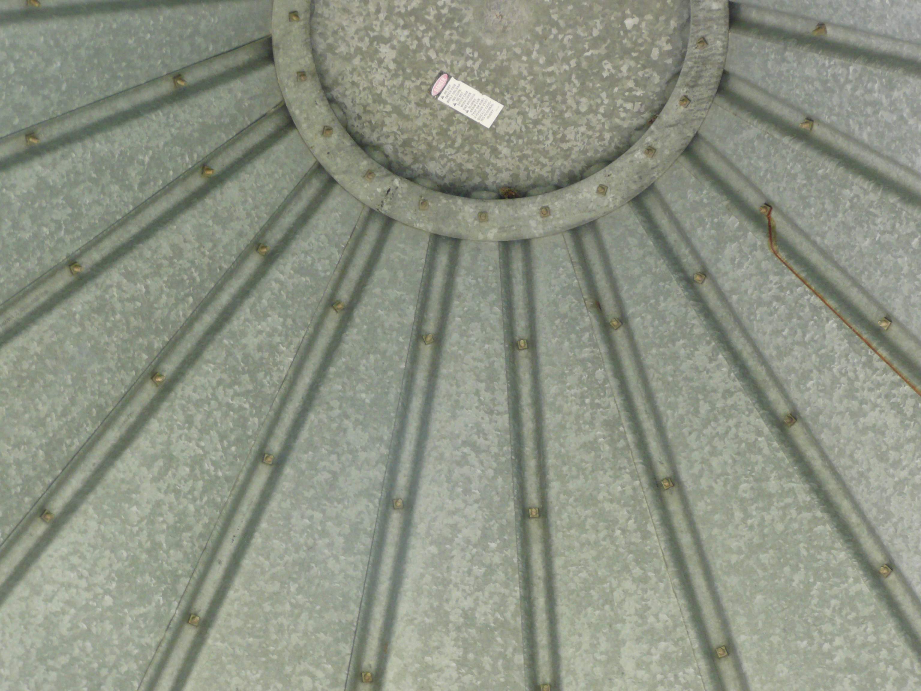

Add some class to the building by using a wire corn crib top for the roof of the structure. Something this size would have 20 sections (petals) that easily unbolt as needed for access through the top. Line with foam board if necessary. I just sold one. They are popular for city people to use as gazebos.
