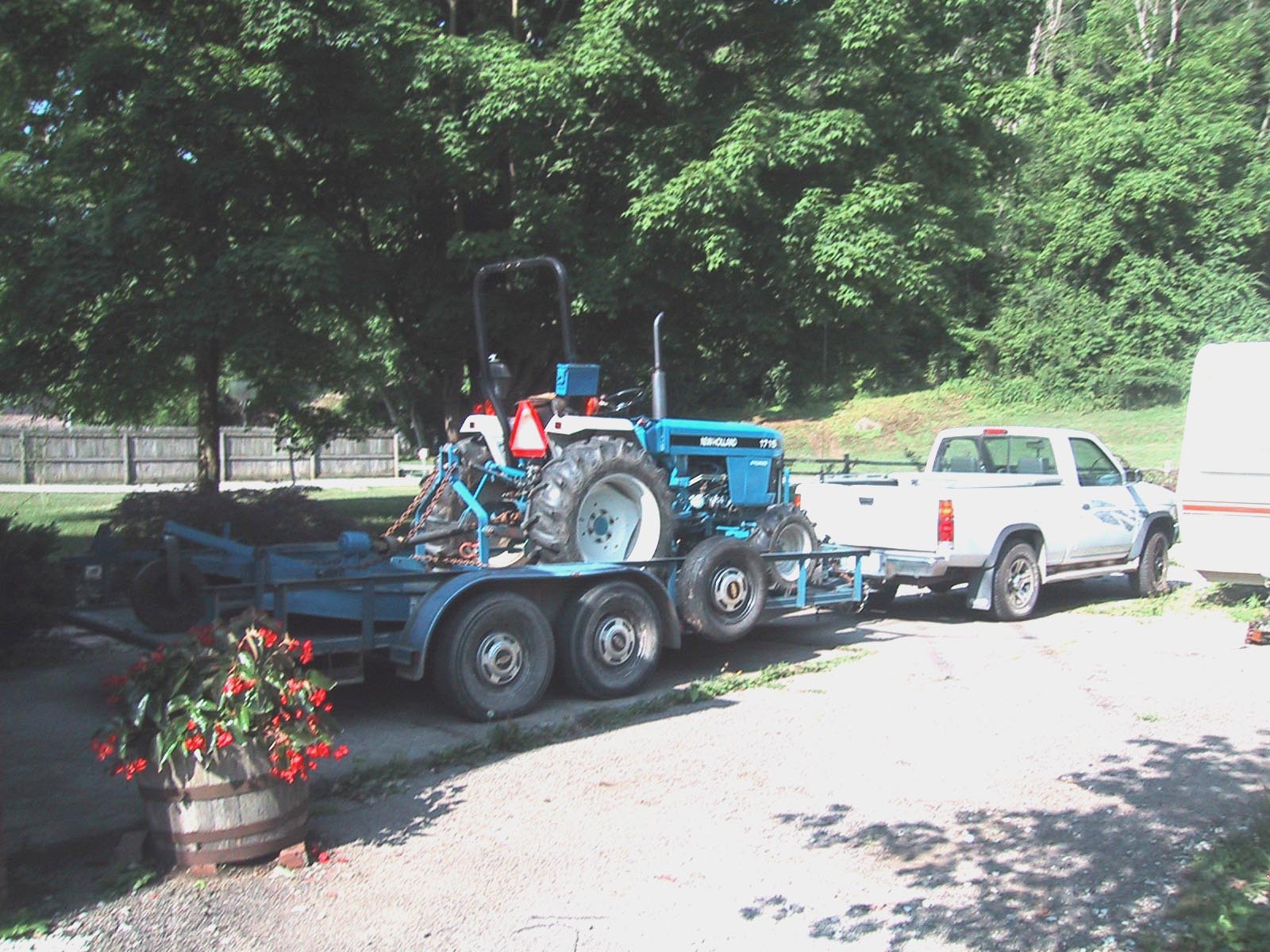

/ Well I bought the $250.00 Bush Hog #18
Here is the way to use Chains on Brush Hog. Works good when going through ditches. Just watch and don't bottom out Shaft.
