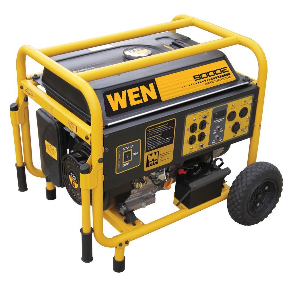

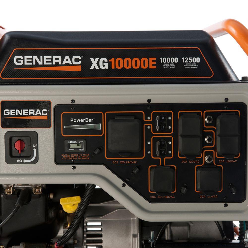

240 volts X30 amps=7200 watts. Indeed, most 7000 watt or so generators have 30 amp 4 wire twist lock receptacles.
Ratings are for temporary power. Continuous power has to be derated 20%, so a 30 amp plug is only good for 24 amps continuous. If the generator is rated for 7000 peak watts but only 5500 watts continuous, a 30 amp plug would be fine, but it's not a 7000 watt generator, it's a 5500 watt generator. I have never seen a 7000 watt generator (~10,000 watts peak) with only a 30 amp 240v. receptacle.
go to Home Depot. The shelves are full of 7,000 watt, 8,500 watt peak gensets with 30 amp recepticles. If it was 10,000 watt running with 12,000 peak
they have 50 amp range style Receptacle.wen-portable-generators-56877-64_1000.jpgduromax-portable-generators-xp8500e-64_1000.jpgportable-generators-5802-44_1000.jpg
