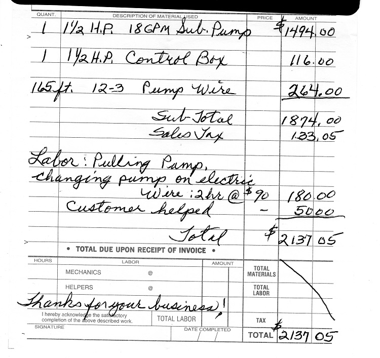

Had to have my well pump pulled a few days ago. For reference, here's the damage:
The well was put in 26 years ago; I essentially got a new system so I don't have to mess with it again in my lifetime!

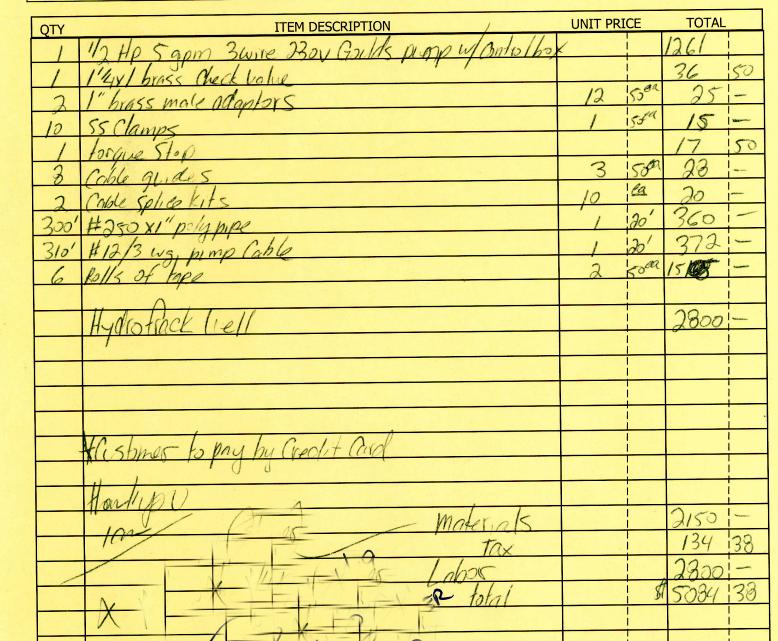

Had a new pump, piping, and wire put in last fall to replace a similar 1/2 hp Goulds pump I installed back in 1986. Also had the well hydrofracked. The markup on materials is significant. I priced out the Gould's pump online and it could be found at about $600-700 with the control box

I see the guy is making big markups, even on the wire!..
If you have to hire out a job, I try not to complain too much about the markups. If you could do the job yourself, you would, but a commercial business has overhead expenses like vehicles, insurance, licensing, business taxes, building leases, etc. They have to build those costs into the markups. The labor rate is generally to just pay the laborer (owner).
This small outfit even credited the customer $50 for helping out - that's pretty cool.
