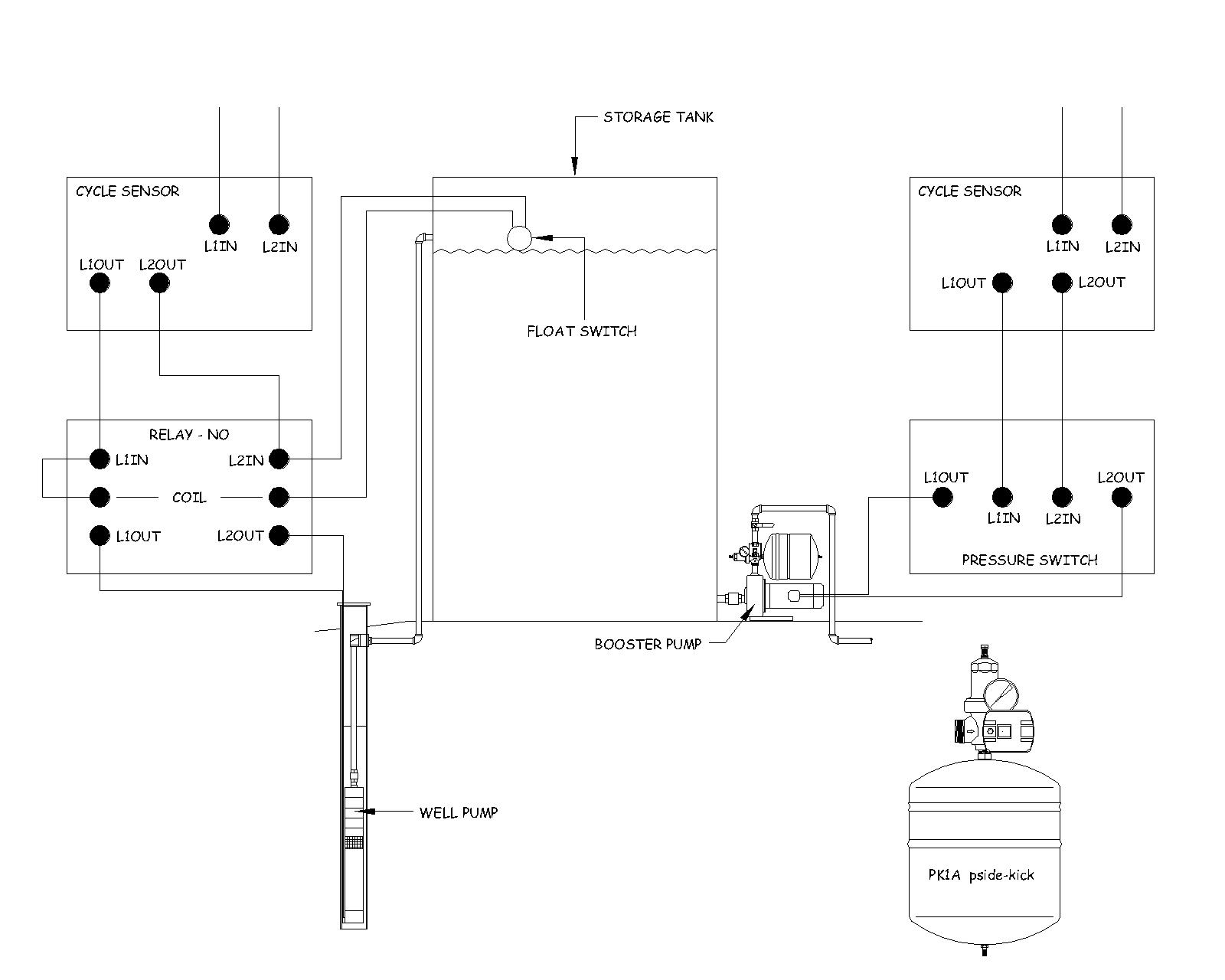

The submersible pump is 220v, can I put a float switch on one legs of the pump, will that turn it off or will it damage the pump?

Yes, switching one leg is done. But note, although no current can flow, you will still have voltage in the line, through the stopped motor windings and at both side of the open switch.
You can’t do this easily with just one switch or the motor will be rapidly switching on and off any time the water level dips. (Unless the switch changes status at very different water height levels, i.e. has a large hysteresis)
You will most likely want a (normally closed) level switch-low (LSL) that opens when it floats and closes when water dips below it.
This LSL switch should be wired in series through another level switch-high (LSH) to energize a relay.
One of the relay contacts is wired to open/close (start/stop) power to the pump.
Another one of the relay’s contacts is wired around (parallel with) the LSL so that the relay stays energized and keeps power going to the pump even when the LSL immediately starts floating and it’s contacts open while the cistern is filling.
Only when the higher LSH is satisfied does its contacts open to drop out the relay and stop the pump.
The system is now at standby again, waiting for the LSL to re-initiate the sequence when the water is low.
Additional secondary LSL and LSH switches, set lower and higher respectively, are often used to trigger alarms (a horn or light, etc..) signaling that the tank is either going to run dry or overflow if the primary controls fail.
Then again, you probably don’t want a LSL switch to automatically turn on the pump if you don’t have enough well water to fill the cistern. If so, put a Manual-Off-Auto selector switch (electrically) ahead of all switches that either routes the circuit through the above mentioned switches (Auto), while the Manual position bypasses the LSL switch, thus pump still shuts off at high level. Bypass LSH too if you want the capability to overflow the cistern in Manual.
….but you mention a pressure switch? Does that mean an existing ballast tank? Do you plan to integrate a cistern with a ballast tank and pressure switch? Will the cistern’s elevation itself provide water pressure?

Sorry I missed this. Yes, you can use a float and just cut one of the wires if the float switch is rated for the max amps of the motor. If not, you will need a contactor or relay to energize the pump, while the float switch just energizes the relay. Like this.
You also need something like the Cycle Sensor shown in the drawings, which can be used to protect the well pump when the well runs dry as well as protect the booster pump if the cistern goes dry.
