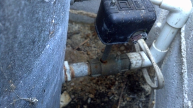

If your schrader valve is screwed into the well side of a brass check valve in the supply line, you have an air making system. Which also means you do not have a bladder tank. This system works great when it's functioning. If the schrader or the bleeder in the well gets plugged; the tank will waterlog causing the pump to cycle rapidly. Make sure the pictures show the entire tank and also the schrader valve.
/ Well question
#22
The Shrader valve is below the pressure switch.
/ Well question #23
I am going to have to bow out of this ,that setup is nothing that I have ever seen !!!!
Best of luck, hopefully someone will step in that knows your system.

C4Ranch Thanks, the part under the gage looks like the link you supplied. I will pick one up and replace it.
Thanks everyone.
/ Well question #30
I looked briefly at the link that C4Ranch posted. If I looked at the same picture of the "part under the gage" as you, that part is a float valve that removes excess air from the tank, and is not likely your problem. The most likely source of your problem is the "snifter valve", the Schrader valve. They get clogged with minerals and fail to open which causes them not to allow air into the line to replenish air in the tank.
In short, the snifter valve, working with the ball/tee in the line in the well works to add air to the tank each time the pump turns on. The float/ball valve about halfway up the tank removes any excess air that has been injected.
You can restore (temporarily) correct operation of the system by using an air compressor on the snifter valve to add air to the tank.
/ Well question #32
I do this for a living and have been for over 45 years. You have a galvanized tank with an air making system. Either your schrader valve is plugged up or your bleeder which is in your well in the drop pipe is plugged. The air control you have lets air out. It doesn't put air in. The first thing to try is replacing the schrader valve or cleaning the old one so it can allow air into the pipe once the pump shuts off. Once you clean or replace it, put a drop of water on top of the schrader valve and cycle the pump. When it shuts off, the drop of water should disappear as the schrader draws air. If it doesn't you will either have to pull the drop pipe up and clean the bleeder or change to a good bladder tank. Never put a cap on the schrader unless you are going to a bladder tank.

I am pretty sure the shrader valve has a cover on it. I had to take it off to get to the vale to make sure it would squirt water.
Do I need to empty the tankl to get ait back into the system?
/ Well question #34
Pulling the cap off may fix the problem. Did it squirt water? The schrader squirting water others were talking about is for bladder tanks. Try the water on the schrader test. It would be a very good idea to drain the tank as soon as possible. Cycling the motor like that is not a good thing.
