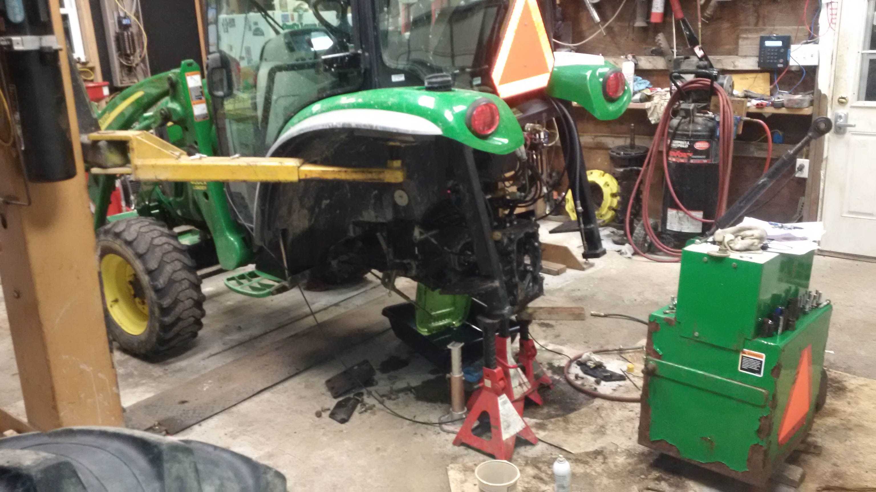

and actually the tractor is in a bay with a 2 post car lift, i have two of the lift arms under the rear fenders under the cab, had to unbolt the bushings and frame of the back that the cab sits on, to move out of the way to remove the passenger side axle housing, and the cab is resting on the lift post arms, one is touchy b/c its all fuel tank so we have it blocked off so the wood is between the lift arm pad and resting on a bolt that holds the tank in place so it wouldnt crush or puncture the fuel tank on the drivers side.

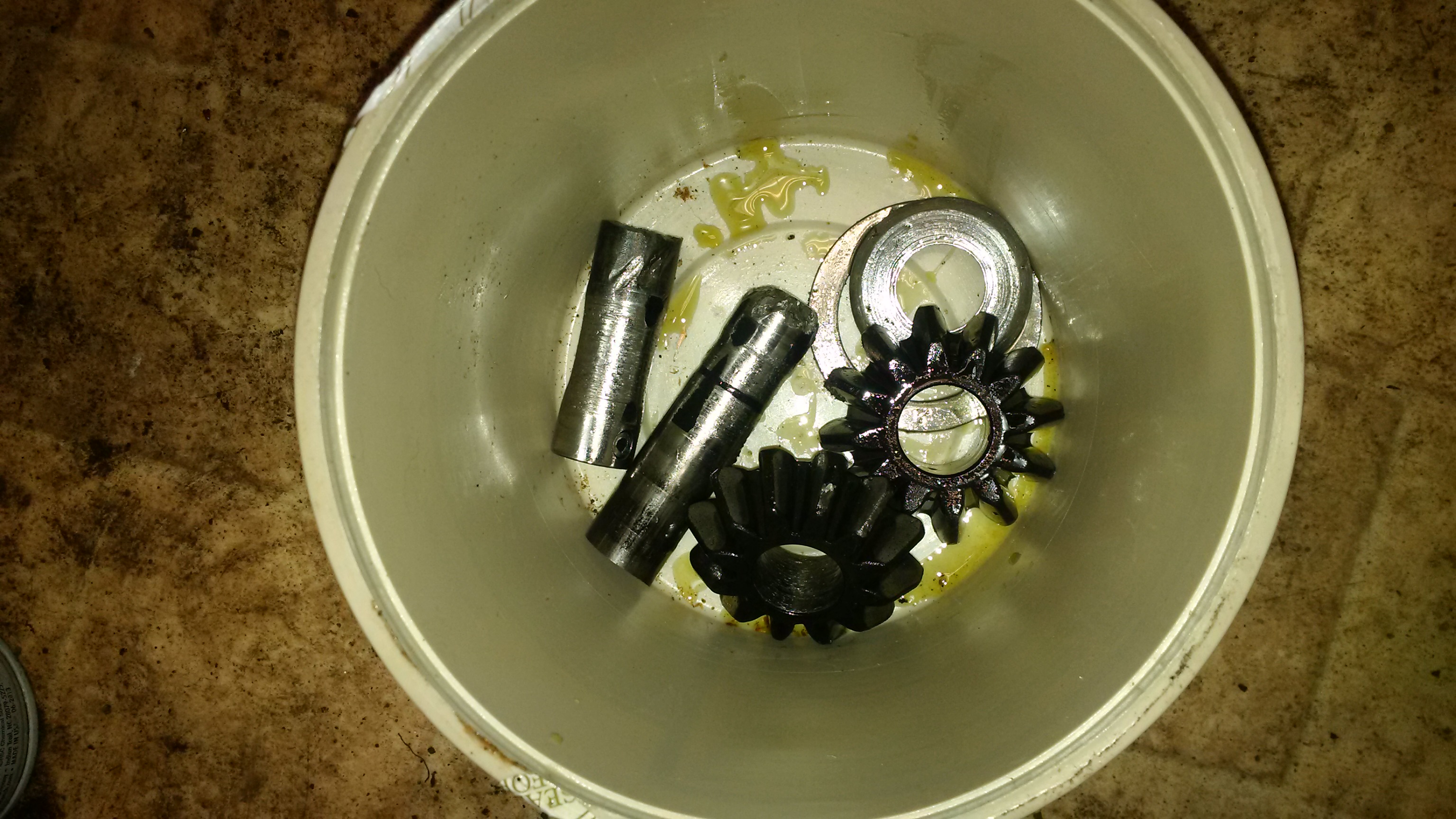

Axles are all good, the diff basically was seizing up, and did break, both small gears and roll pin fell out, well the pin started to move and eventually broke in half, thats what half of that rod shaped thing is in the one photo. The other half was sitting in the bottom 10" in front of the diff.

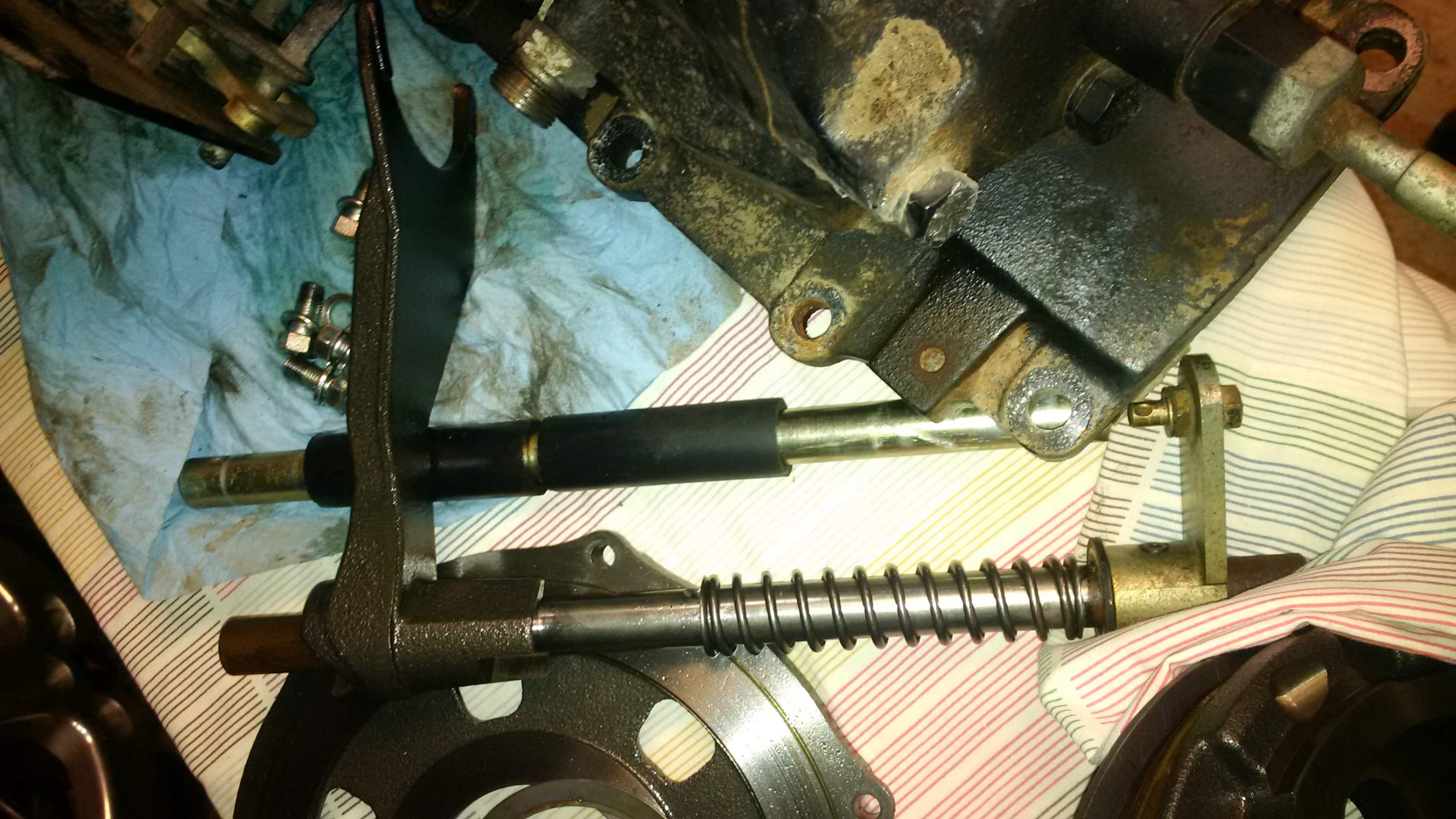

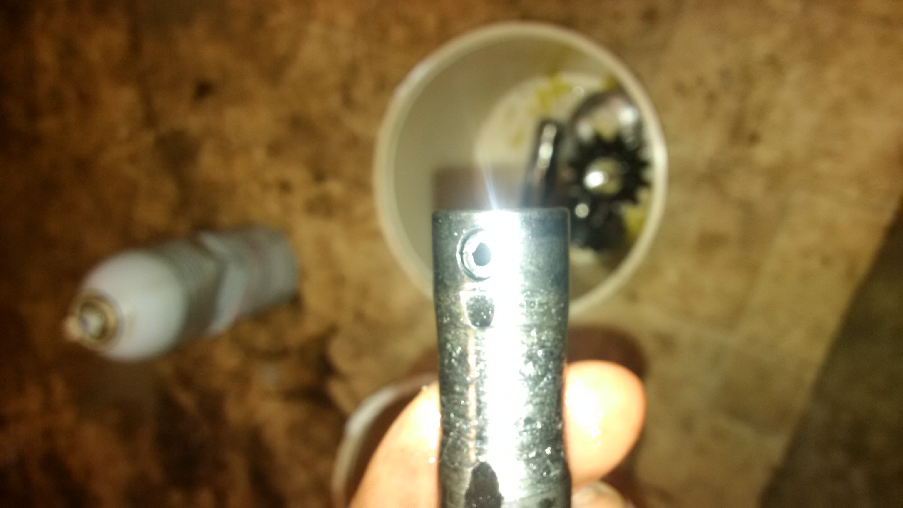

ok photos from 1 to 10

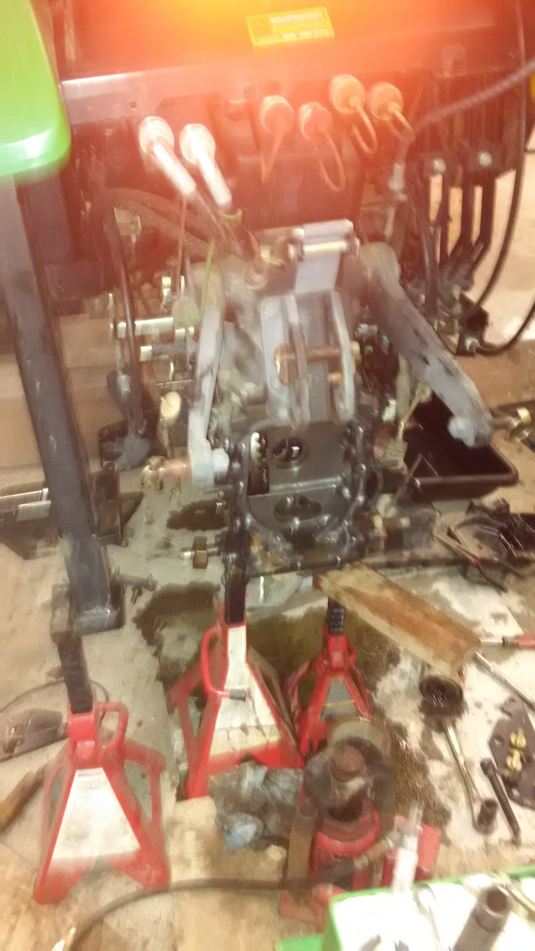

1. Tractor disassembled, as much as we need to for the repair by now. I must have 200+ bolts out of it by this point.
2. Diff, i know blurry, but the roll pin retainer pin is still in the diff side, the cylinder pin that you knock out with a punch and hammer, it literally just snapped somehow, thus allowing the roll pin to spin out of the diff, and the locking of the rear axle i was experiencing at random, was when the pin slid out far enough, it actually hit the case of the trans, it ate/carved out a good chunk of it but no cracks or other damage..will get a photo of that soon too.

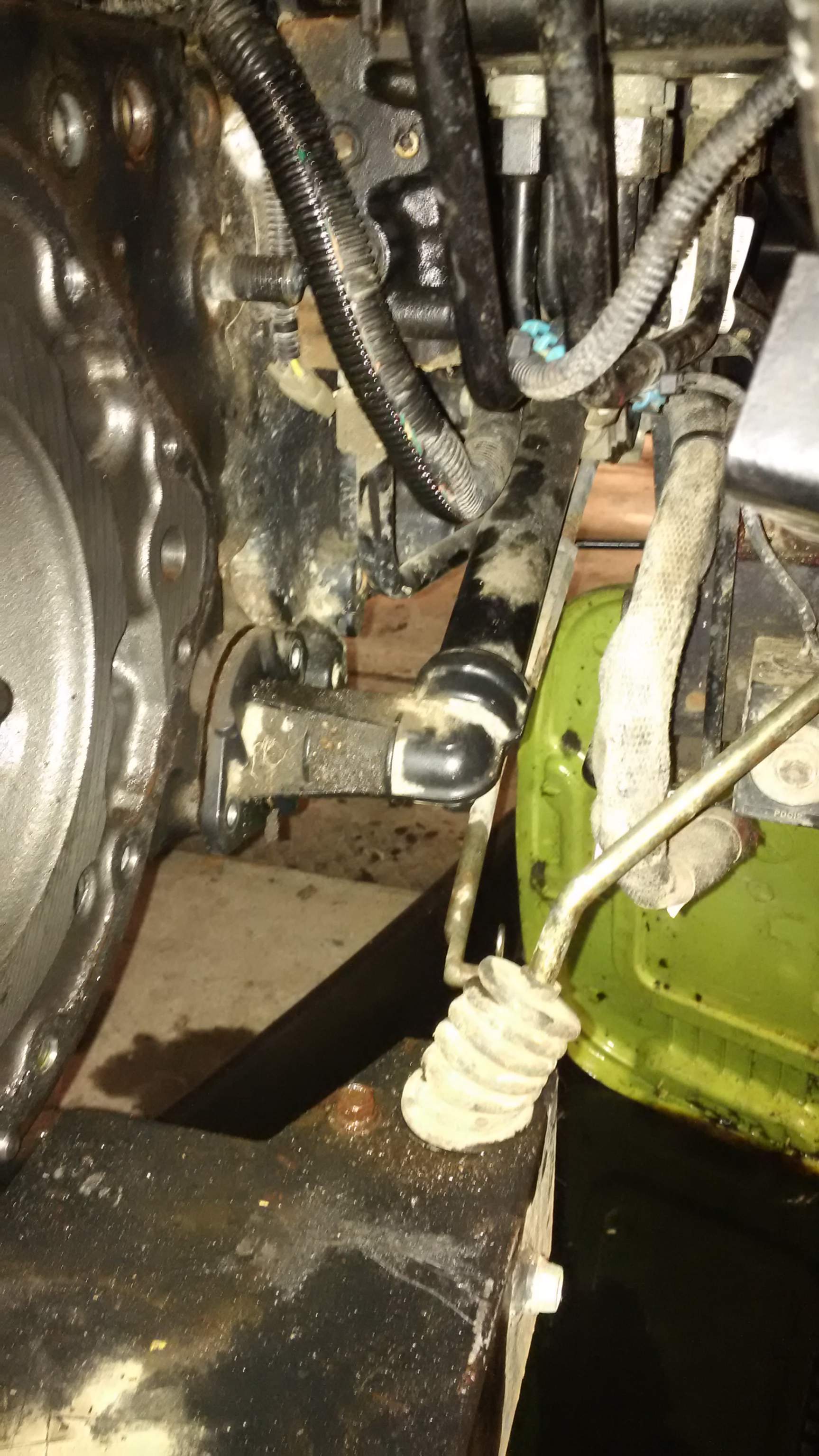

3. this is the diff locking rod, it takes 5 pins to be punched out, took us over an hour for this alone after taking the whole top rockshaft assembly off the top of the trans, see pic #4, that part is 130+ lbs too. Takes 2 guys for most of this dissasembly.
4. Rockshaft assembly unbolted off top of trans, took over an hour and a half just to get anything out of the way on top to get to the bolts to remove this alone.

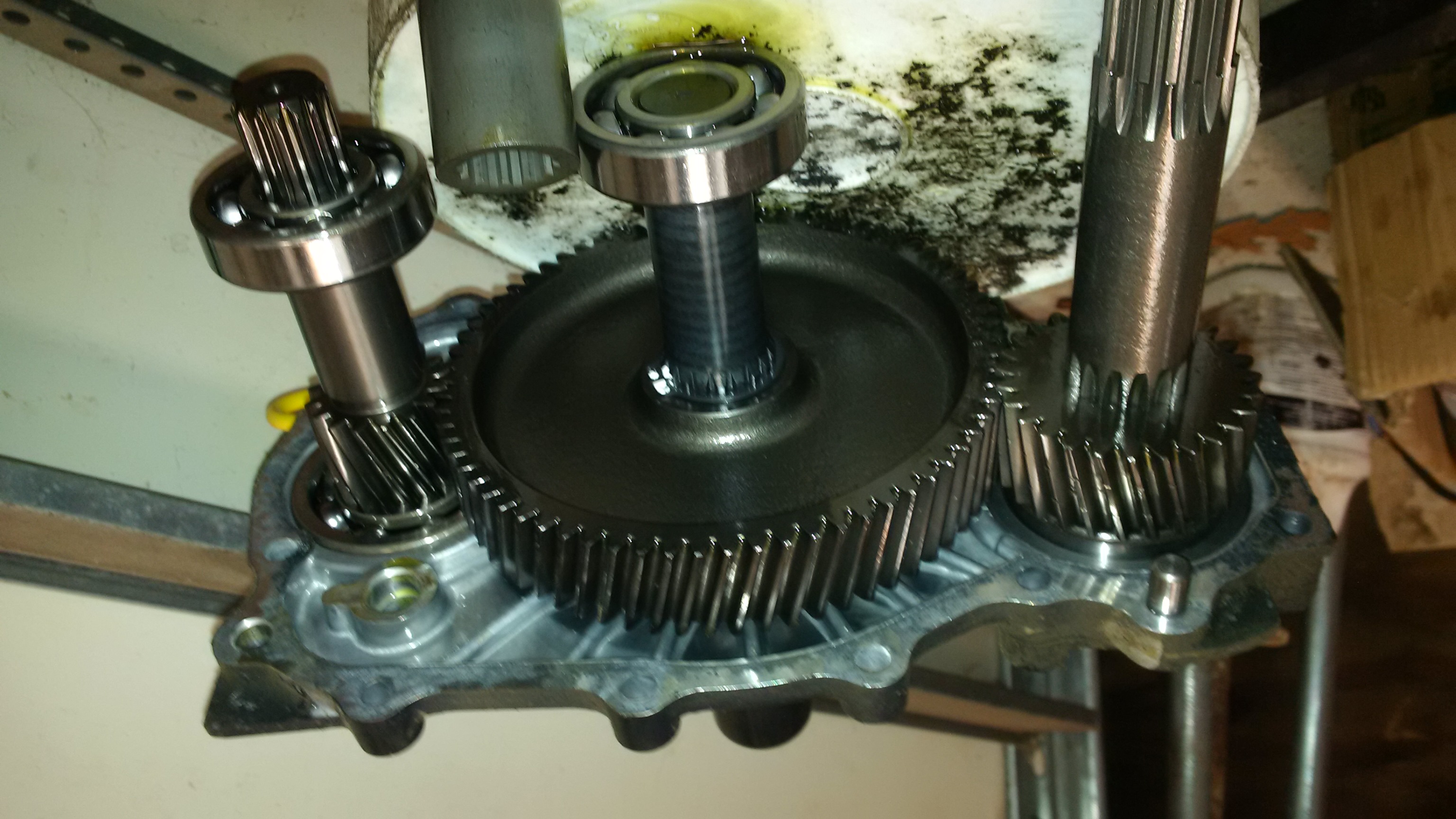

5. rear PTO assembly gears, this unbolts off the back of the trans, need to unbolt several bolts that hold the rear hitch plate assembly on from the side and 4-6 bolts on bottom too. Note, it helps to have a 3/8" air ratchet, 1/2" air ratchet, 3/8" good impact "we have a 700ft lb air cat, a 1/2" impact gun "were using a 1100-1200ft lb air cat and still cant break some lose", and a 3/4" impact gun with sockets between 3/4" and 1 3/8ths in size, and a 1/2" breaker bar, extendable if you have it.
6. Two differential gears, these should be mounted inside the differential, they were just floating around in there, doesn't look to be any damage., when the roll pin finally snapped and these no longer touched the diff ring gear, the tractor then had no rear axle move ment.
7. buccket of parts, notice the washers totally demolished, could be worse right!
8. Roll pin snapped inhalf, see side chewed up was what was hitting the trans case and other gears when spinning around crazy. Notice the little pin still in it, but shaved off smooth, other half of that little pin is still in the diff.

top of trans, with pinion damaged, diff side is fine though, although it seems mared up a lot on the edge, this edge sticks out just past the diff ring gear so it shouldn't impact anything... if this had to be removed, another 2ft of the trans has to be disconnected "JD says you split it in half", you need customized stands from JD with bolts that hold the tractor up then, and then you can take this out to replace it... im sure JD cost is $500 lol.
