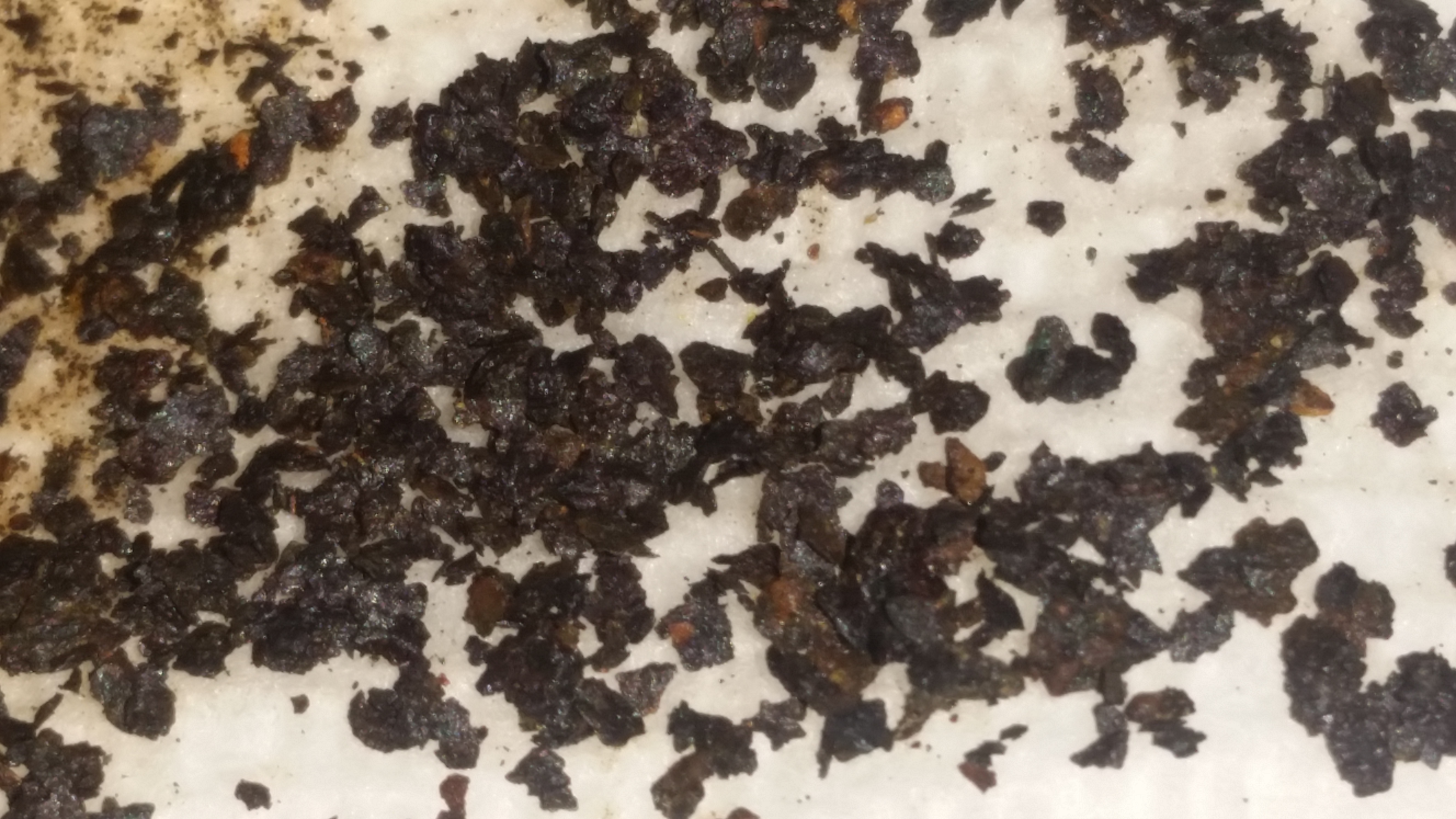

or, I should say, particulate. We are getting a lot of black particulate in our water. It is clogging up our appliance, faucet screens too often.
I'm thinking it is time to replace the well line, which I *think* is galvanized.
I am also thinking about a sediment pre-filter. It may be a year or two before I can replace the line.
Thoughts?
What is a decent, inexpensive filter that won't impact gpm or pressure? I dont care about poison in our water, so I am just looking for a sediment filter.

Thanks for the input ya'll.
I attached a pic of the particles. So what is it? I think I know; and on the bright side, it means I get to rent and play with a mini excavator.
/ Well sediment - filter #12
I always have a hard time telling things like this from pictures, but that looks like rust chunks to me. Do you have an iron line coming into the house?
