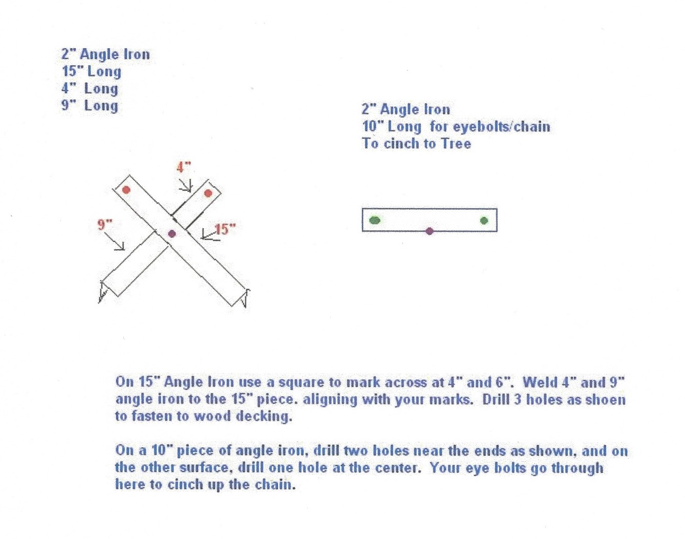

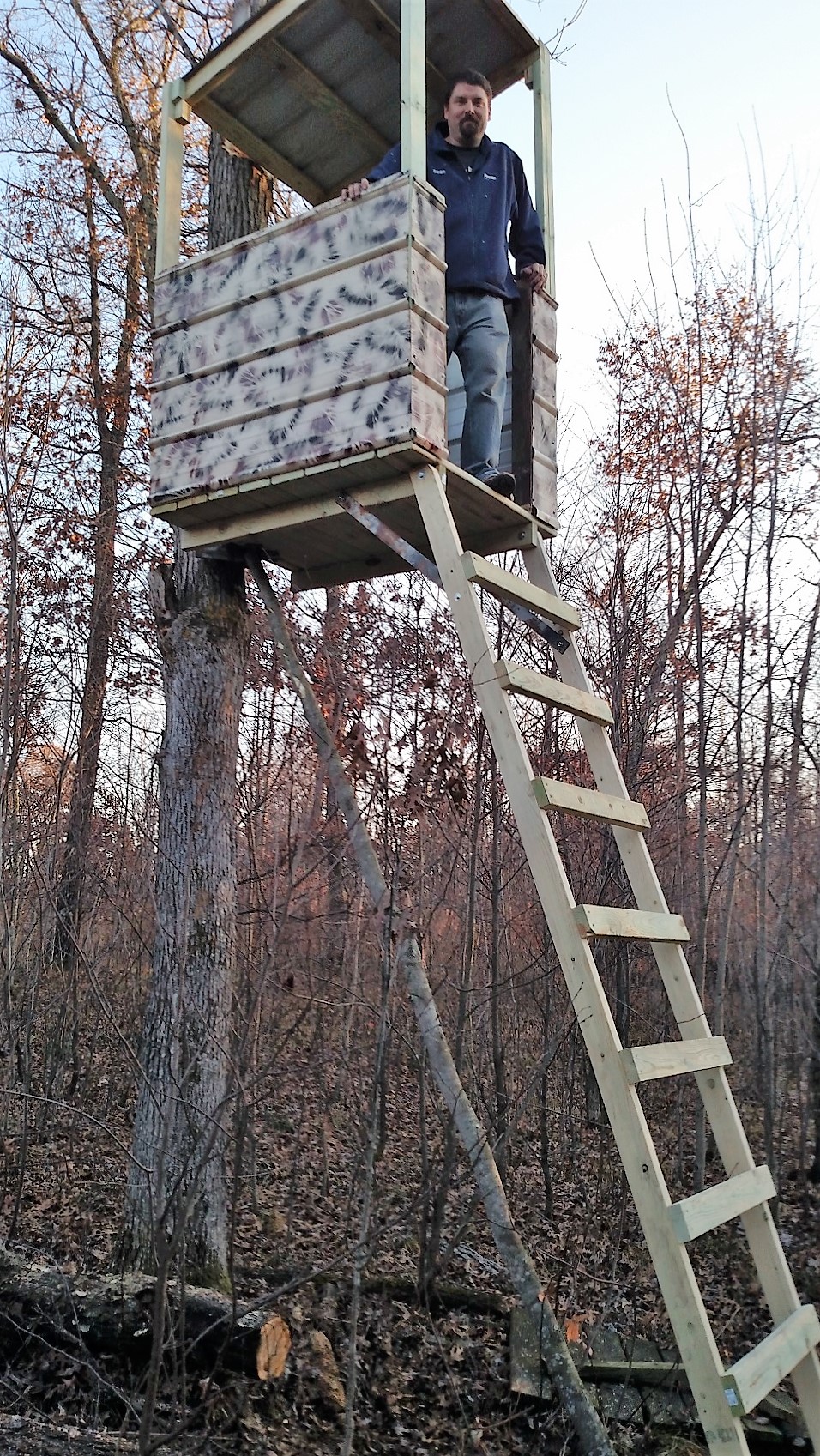

Interesting thread. Sorry to hear you lost so many trees and your wooden tree stands. If you're looking to replace those stands, here is how I build mine. They are stable, comfortable, inexpensive, and durable (use treated lumber). The angle iron bracket is simple, and "grows" into the tree after a year or so. Here are pics and the plans.

Very nice, thanks. :thumbsup: One thing I started doing some years back is when attaching the ladder to the seating portion, I plan for the sides of the ladder to stick up about a foot above the seat. Then I have a nice hand hold to use when turning to sit down. I'll make some new one's this spring to put up.

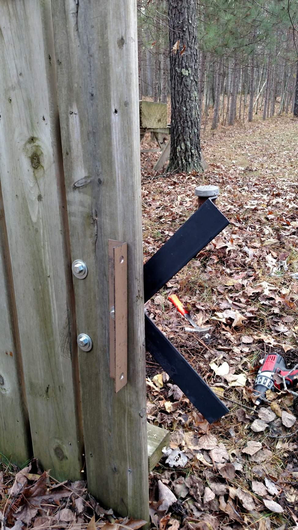

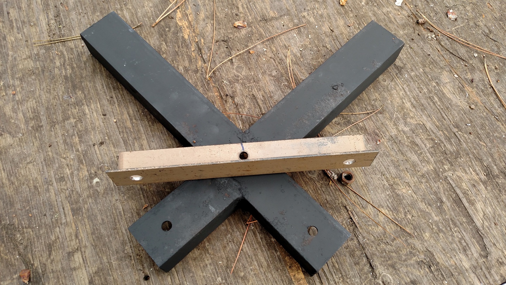

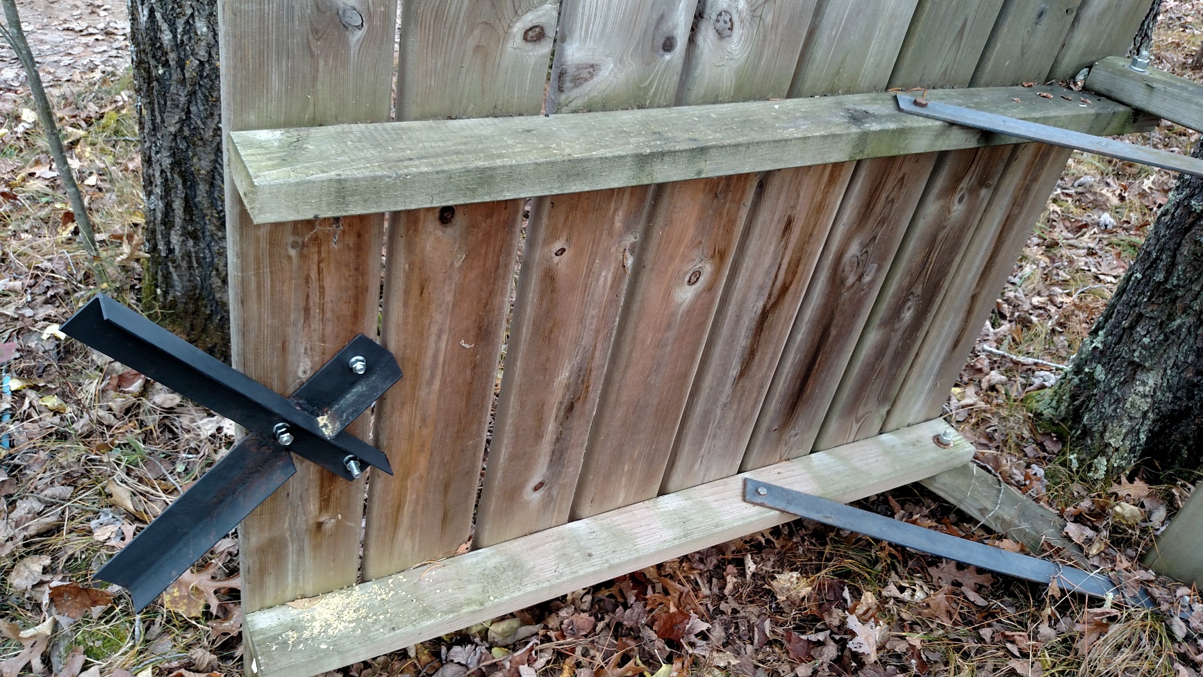

I used to use a chain around the tree, and then cinch up with a long 3/8" hook that went through the top angle iron piece. Now I just screw an eyebolt into the tree, and hook into that with the 3/8' hook. I also found that a 10' or 12' ladder is high enough.

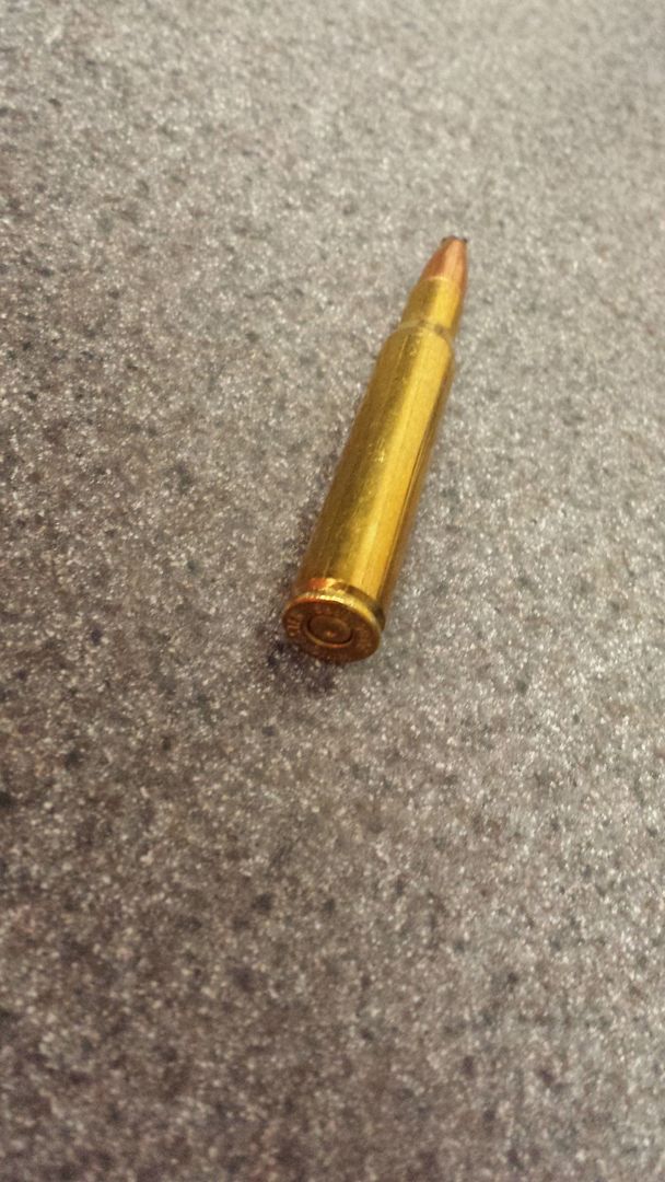

Firing pin indentation looks a little light to me.
Compare it with a fired shell from the same rifle.

Yep, no way is that a good hit. Compare to others that did fire from that rifle to determine if this was a high primer, or it was the rifle's fault.. Hit that one again and it will likely fire.

I agree, light hit.
If it was a hand load, I'd say primer not seated fully, and fp seated it
