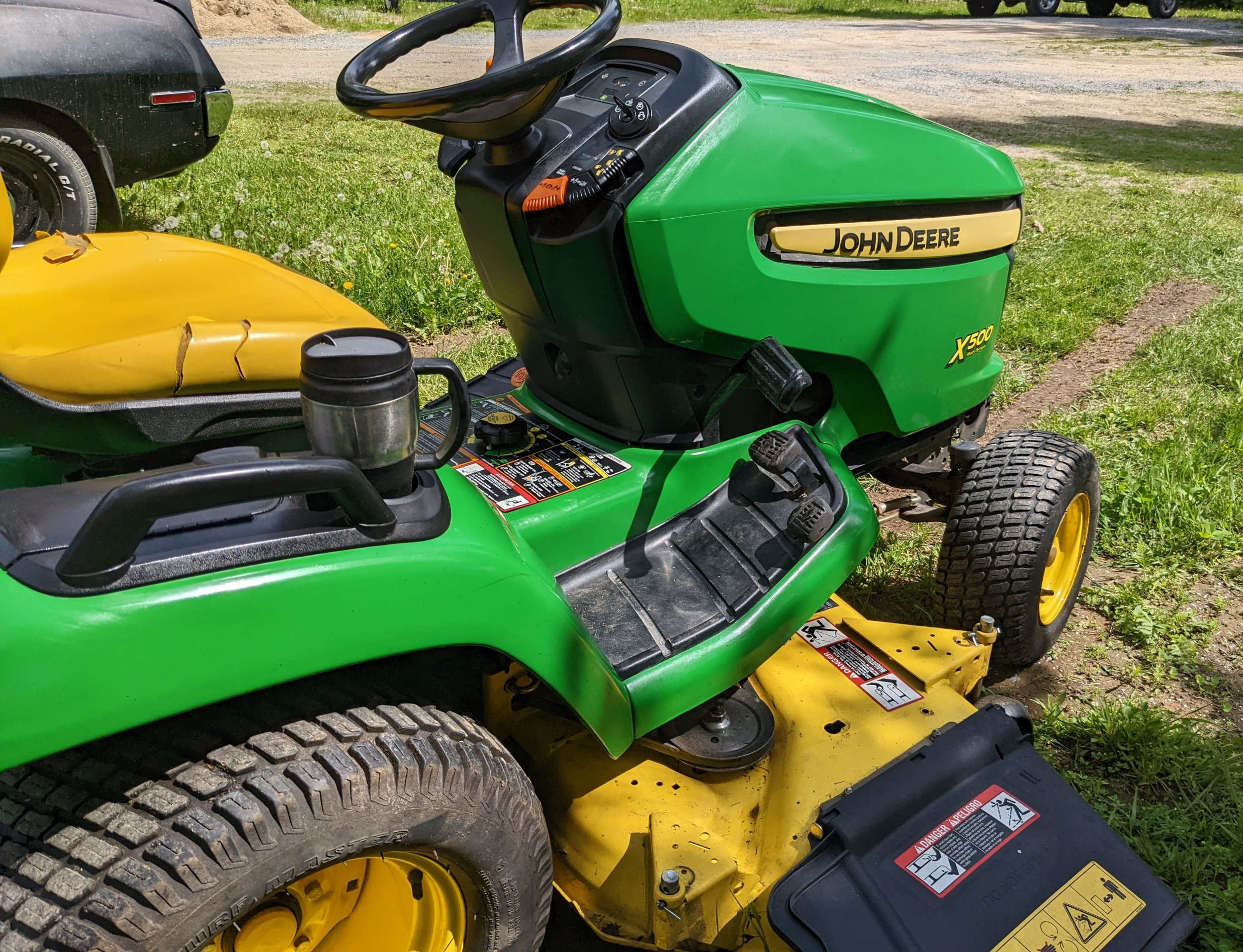

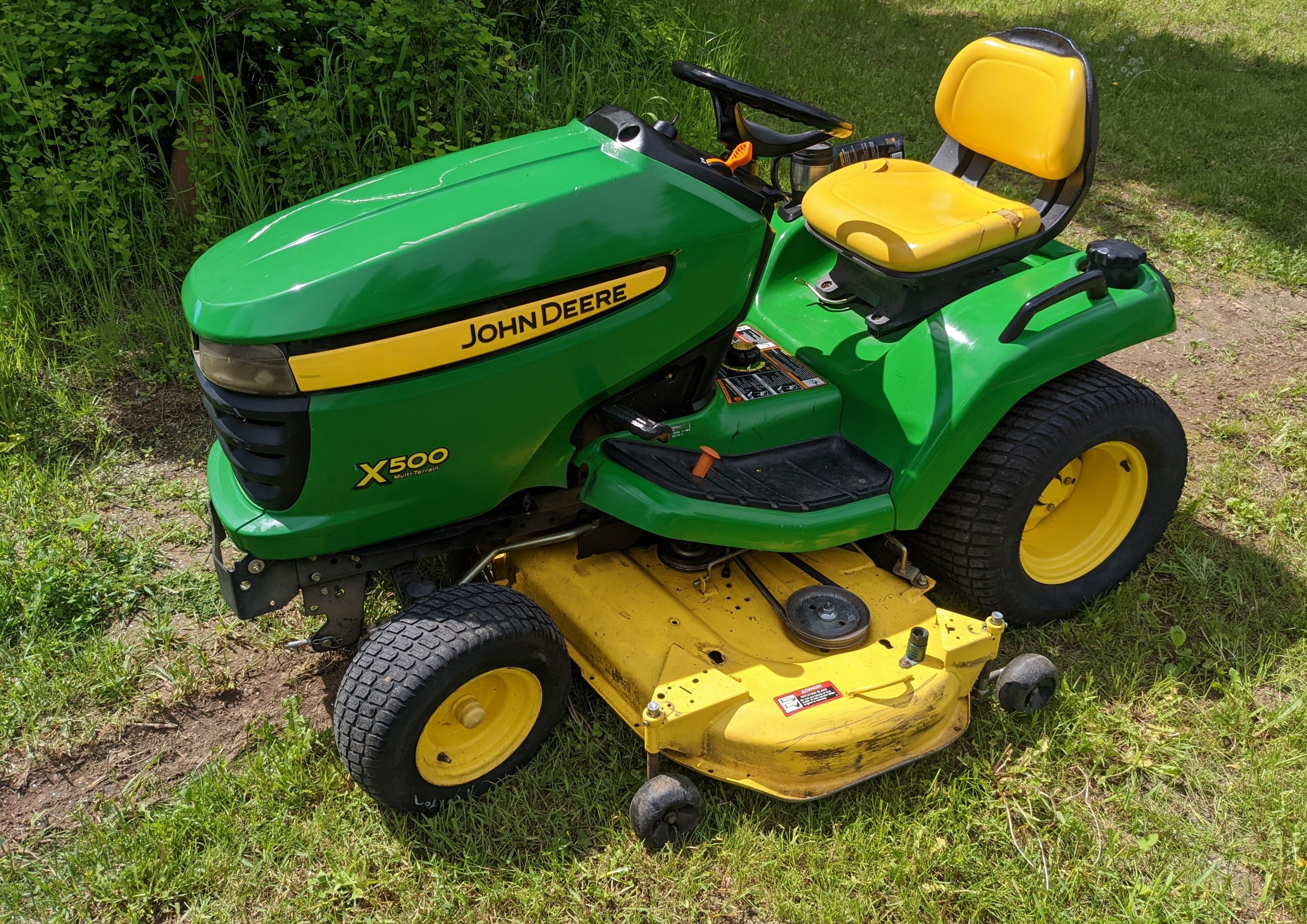

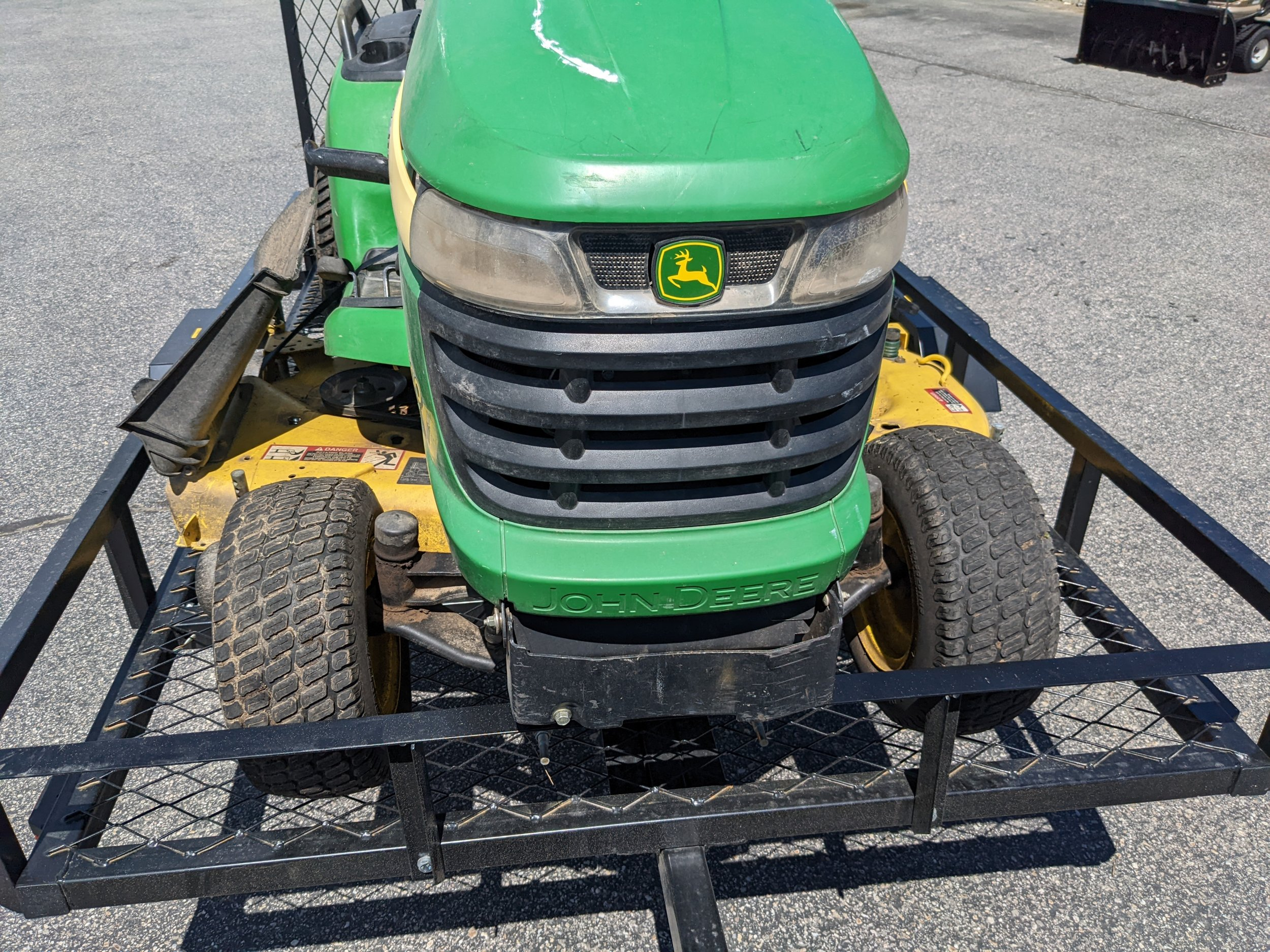

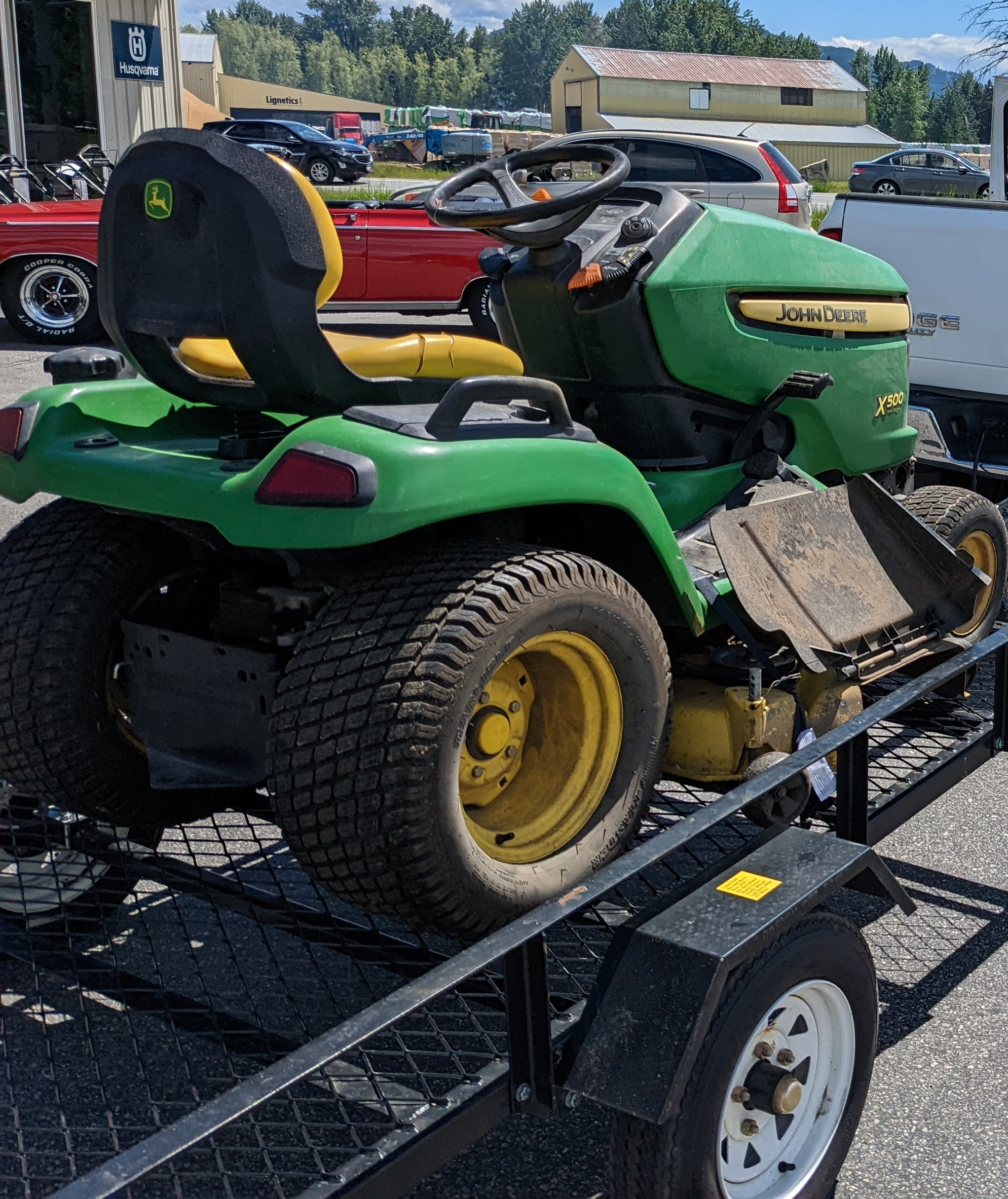

Well My Trusty MTD Hydrostat is still going Strong....
But the Deck has had it and no parts available to fix it this time.
Wife said that's It -I hate driving that Gilson and we need a Mower Today... I said will all be --a-ned If I will Buy a new Plastic Home Depot or Walmart Mower, So we better hope someone has a used better quality older rider for sale. She says Fine but we will split the cost which i liked.
First place we check a Local Husky dealer says we have a few but only one that is a hydrostat mower. a JD X 500.
First 2 questions who built the Hydrostat, he says I think its a Peerless I said like an Eaton Peerless he says I think so.
Next question what engine, we pop the well cracked hood and see a v twin Kawi. I said that also looks Good.
Quick test run and everything seems to work well, smooth engine no odd noises no oil burning. deck spun up nicely. Turns out a recent widower had consigned it.
I ask what's the bottom dollar because the tag says asking $3000, lady says I think you could get it for $2200 and my wife says that's bad Karma call her and ask if she will take $2400, I am gasping at this point... they get the lady on the phone and of course she will take $200 more than her already admitted bottom dollar.
I ask if maybe her husband had a service manual and she thinks so, I also ask the dealer if they could throw in a set of new blades and they say no problem.
At this point we buy the mower and they sharpened the old blades until the new ones come in. Anyway here she is. Hope this one goes for a good long time Mower has about 840 hours on it. We shall see. Our MTD Hydro has several thousand. Did a bit of trial mowing seems good after raising the deck up a bit, our ground is pretty rough.
I hope we didn't get burned but was not going to buy a Nice pretty "new plastic drive" rider.
Maybe the wife is right about Karma.
first check I just did , look this up on tractordata
Nope not a Peerless Eaton... a Tuff torque K 72 B Mmm

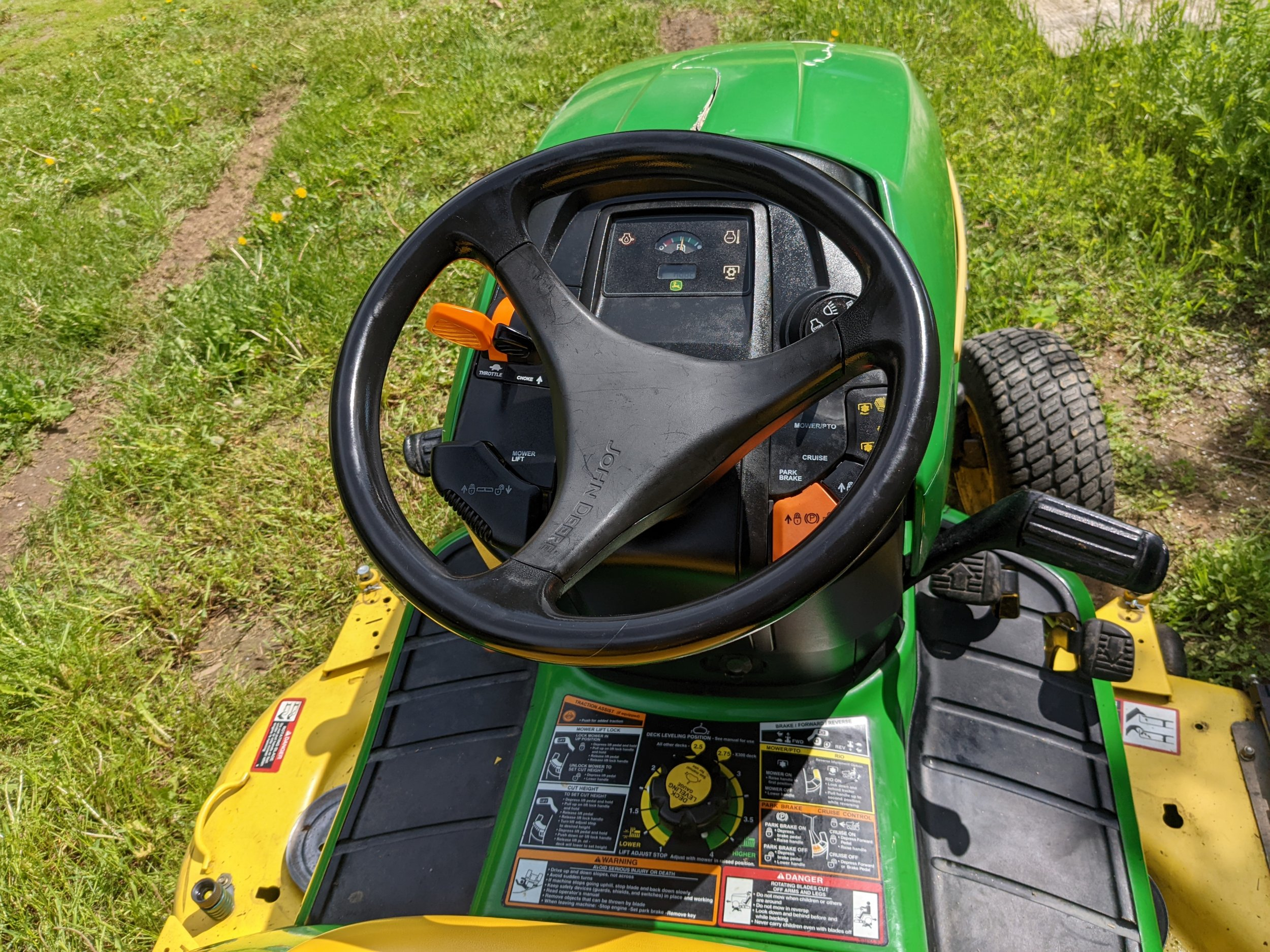

I mowed one of the front yards tonight and the X 500 is growing on me .
It is a Nice and quiet deck with really good blade speed. Checked all the spindle bearings No play or noise in them at all.
I am going to disarm the PTO cut out when reversing . We mow with the others in reverse often. Having a clutch engage disengage re engage that often makes no sense to me.

For the reverse override on your X500 do you have to pull up on the deck engagement lever. If yes very simple to override you just have to put jumper wire across two contacts on that switch. This way just remove jumper and safety is now active.

Did a little clean up and other than the Hood needing crack repair. And either the suspension seat off the MTD or a new Yellow J D
The X500 actually looks pretty Good Going to check if it can be backed up and keep the blades spinning also checked the HST oil is nice and clean.
