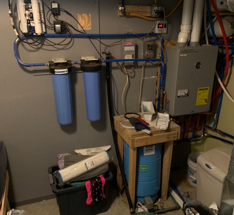

I moved into a house a few years ago that has a well. There was 1 Big Blue filter on the incoming water, then it leads to a water softener. I seem like I have to change the filter every couple of months once the water pressure goes down. It is a 1 micron filter. I put a second Big Blue filter between the 1 micron filter and the incoming well water and installed a 5 micron filter which helped with the 1 micron filter lasting longer but the 5 micron filter has to be replaced every few months.
Yesterday I installed a spin down filter, 50 microns between the big blue filters and the incomining well water. https://www.amazon.com/gp/product/B072YVNRZN/ref=ppx_yo_dt_b_asin_title_o02_s00?ie=UTF8&psc=1 The spin down filter clogs within 12 hours and my water pressure drops. When I drain the spin down, it doesn't clean itself all that well. I think the stuff that is clogging it is so fine and really sticks to the filter. I ended up taking the filter our and scrubbing it with a brush to clean it which restored the water pressure.
So now I am thinking about installing a sediment trap in from of the spin down filter. The sediment trap is suppose to trap the sediment in the bottom of the bowl. https://www.amazon.com/gp/product/B005VPMMSW/ref=ppx_yo_dt_b_asin_title_o00_s00?ie=UTF8&psc=1
I'm not sure what else I can do.
The pump does not cycle on and off fast, it sounds pretty normal, but there is a lot of fine sediment getting caught in the filter.

Here is a picture prior to installing the spin down. Looking at the picture, the incoming water comes up from the tank then goes left into the first big blue which is 5 micron, then the second BB which is a 1 micron. Then from there it goes to the water softener then out to the fixtures. The spin down was installed right before the first BB filter. The little white filters at the top left are for my RO system.
Nice looking install... what about a corse filter at the Water Tank or Pump ?

Maybe they pump is too close to the bottom of the well and is sucking too much fines from the bottom of well.
