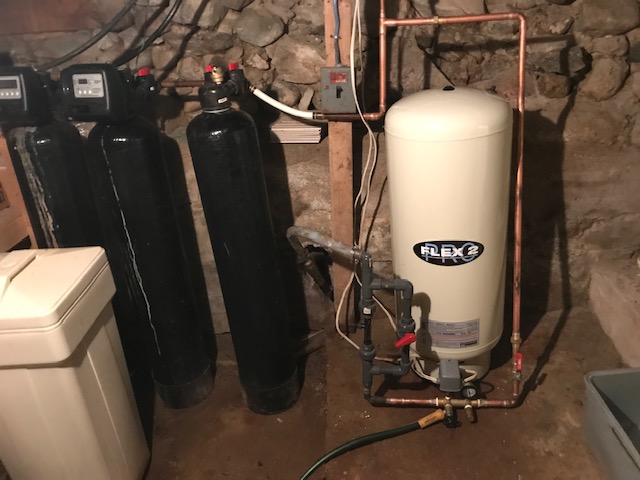

   / Well Water Filter #53
This is what I have. My pressure tank just went for a crap, was replaced yesterday ($1000)....Pressure is still low and the plumber figures my 10 year old iron filter and water softener are on their last legs. That's gonna be 3 grand more, unless I decide to rent, which I am thinking about.
Apparently, these systems are only good for about 10 years, especially if you have high iron like I do. Still cheaper than city water I guess.

I don't know about that. With the amount of money I put into filters and salt, I think city water would be a wash for cost. I wish I had city water. I do have city sewage, so I am happy about that. I would rather have city sewage and well water, so I am lucky there.
