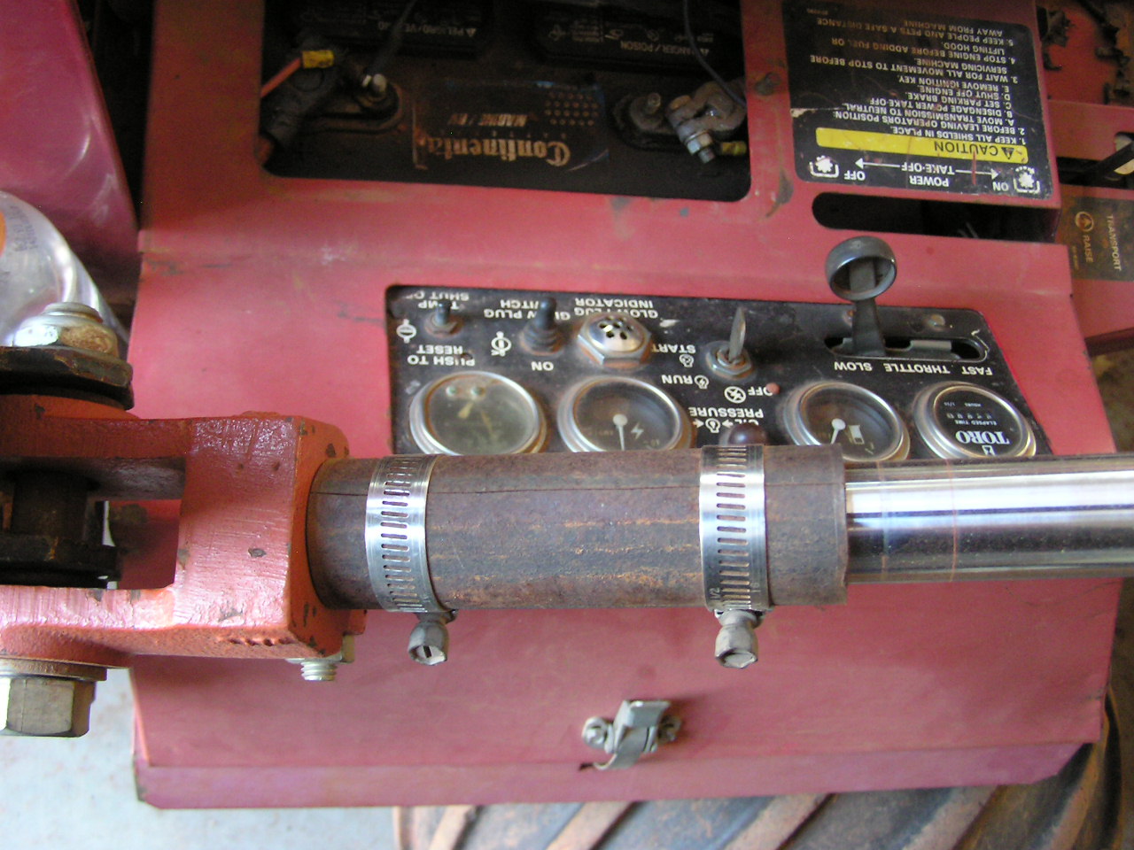

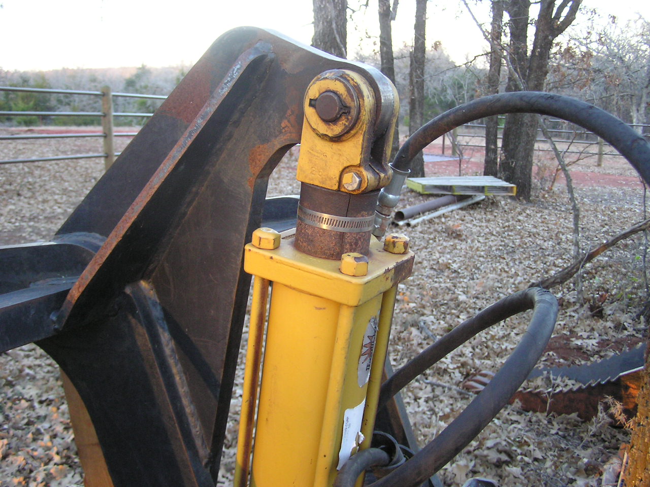

I use a hydraulic toplink, sometimes I'll add a cylinder stoke limiter.
I made some stroke limiters by cutting the tubing to the length needed, cutting in half lengthwise, padding the inside with closed cell foam and clamping to the rod:
